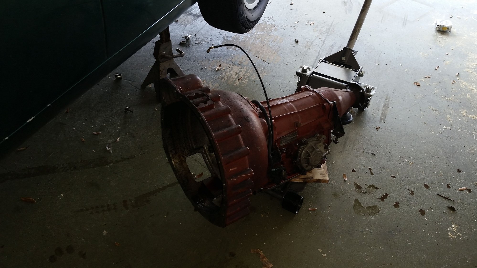

Found a torque converter, through a distributor, had to use wifes employer to purchase it though, Everything on web site says its a fit, bit guy at counter says i need to make sure before i take it... i have my old flywheel so i can make sure bolt align , what i cannot do however is count number of splines, anyone got a bw66 laying around out of a car that they can count them for me???? web site says converter has 29 splines..

Darren
I have just counted the splines on my transmission and can confirm 26 is correct.

Thank you, i got my trans out this morning, still cleaning up the mess but was gonna count them myself as i was getting no answers
