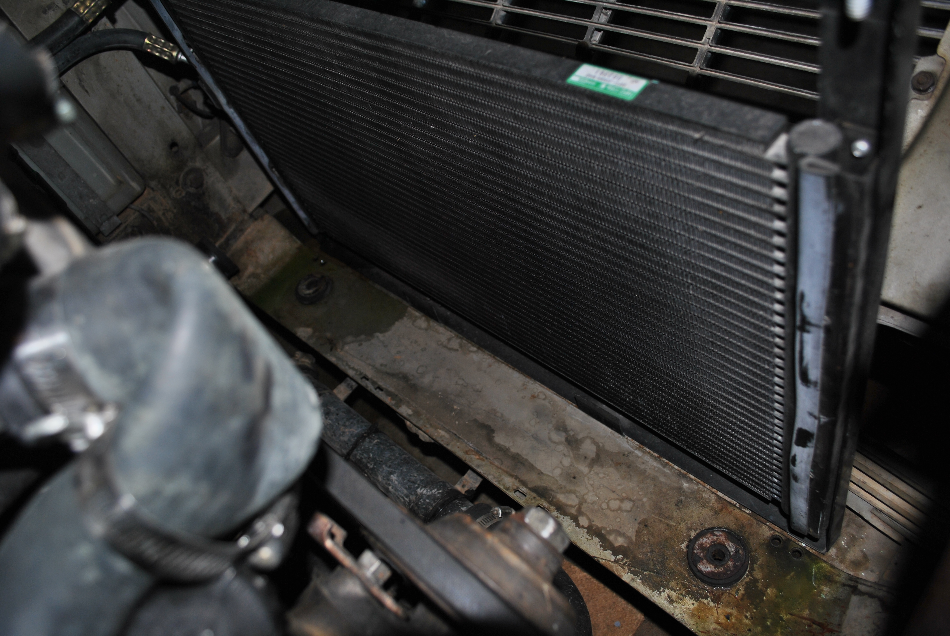

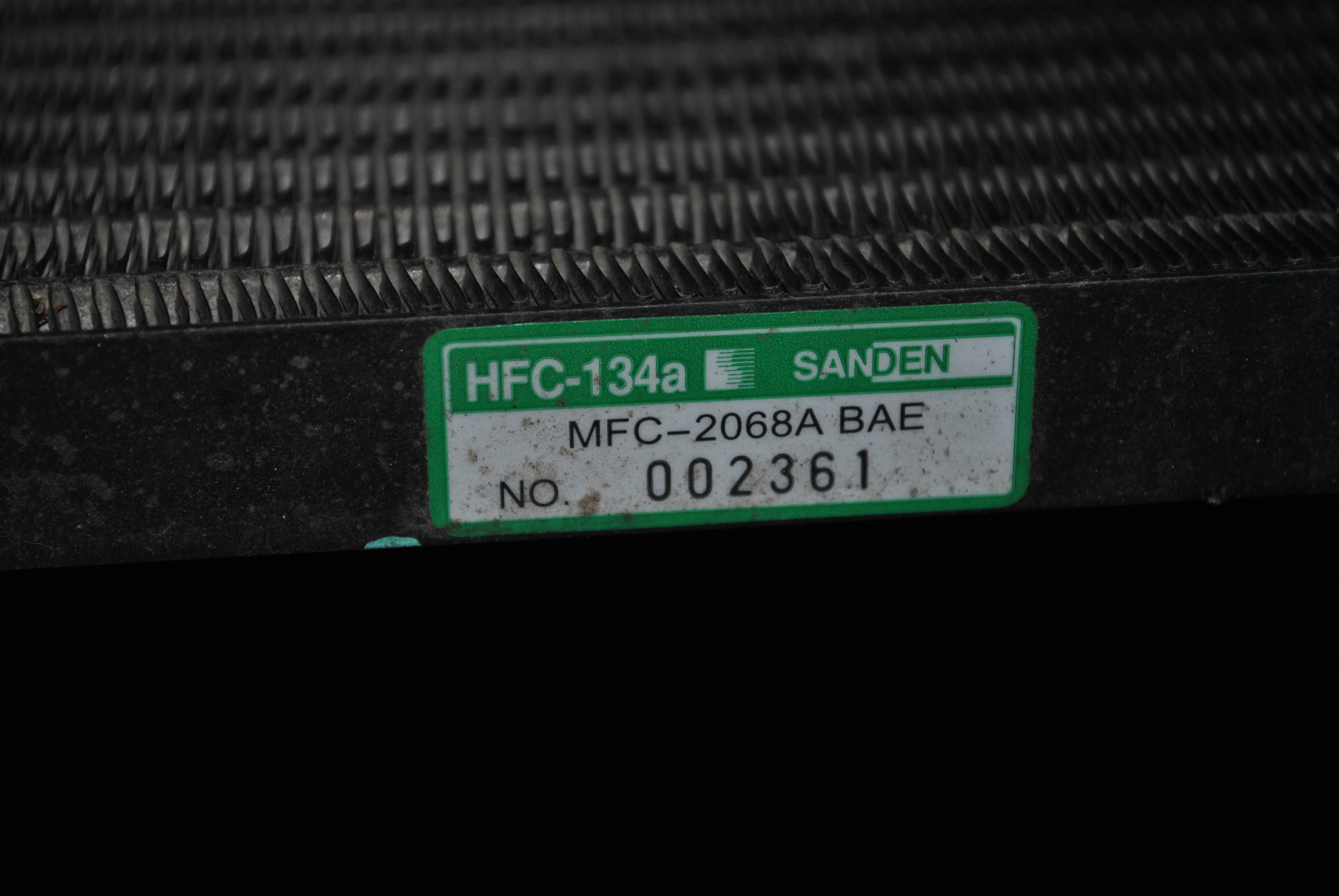

As I mentioned in your other thread, I have a Sanden MFC-2068A-BAE. The links below could help to make enquiries. Maybe someone else here will be able to direct you to where to find one.
A/C Condenser for Series II-dsc_3710.jpgA/C Condenser for Series II-dsc_3711.jpgA/C Condenser for Series II-dsc_3712.jpgA/C Condenser for Series II-dsc_3714.jpg

There is an all new Alu A6 compressor that is a drop in replacement.
https://www.summitracing.com/parts/fss-58096
The OE Series 2 condsensor is huge. I'd run that with some flare seals and a pusher fan. Jag used a smaller condenser on the series 3 in order to make room for an oil cooler and it's too small for R134a.
