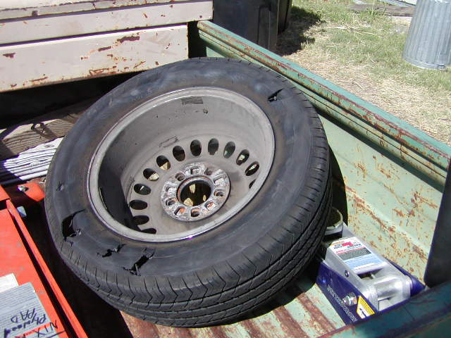

As I mentioned above, I had just rounded the last curve doing, oh, maybe about 70mph or so when there was a strange sound from the left rear and I began to smell burning rubber. However, there was little indication in handling of what really happened.
I was Well ahead of any other traffic and a couple hundred yards ahead of the car behind, and out of the curve by that time so I gently pulled off on on the shoulder. When I went over the rumble strip the front made its usual noise, but the back did not.
Before I even opened the door the Other Car blasted past, of course, so we lost that one. Upon uncoiling myself from the seat, it was evident what had happened: I had *Shredded* the left rear tire. I mean, Completely Shredded it! Although most if the tire was still on the wheel, there were little shards and crumbs of rubber for 100 feet behind me, even on the boot lid!!

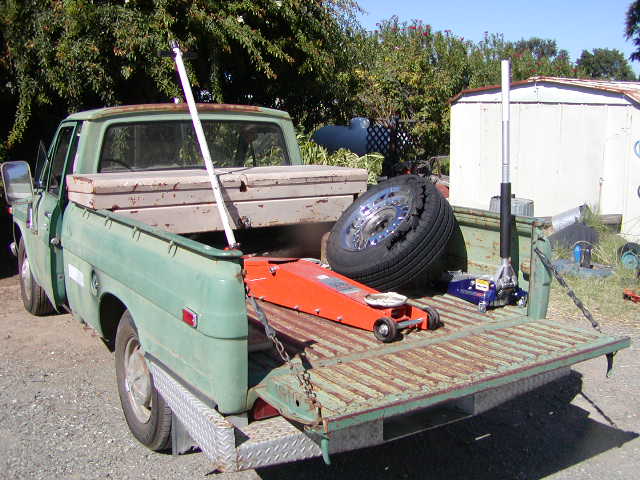

As I was going to be late getting back I called husband to inform him of the situation and that I was fully equipped to deal with it. He said, "Stay right where you are, (like I could go anywhere) I'll be right there." OK, if he wanted to change the tire I could wait for him, but I had aired up the spare and put in a jack and lug wrench the last time I had a flat and discovered I had no jack and the spare was flat, so there was no need for him to worry. I suppose it's one of those Guy things.
Fortunately it wasn't so brutally hot today so I waited without too much discomfort. He soon arrived in Toad with 2 floor jacks (which we didn't use) and a bunch of tools; among which was a battery powered rattle wrench from Harbor Freight! How handy was that!! Just break the lug nuts loose with a breaker bar and spin them off with the rattle wrench! It was all clear to me now why he wanted to come! It was so he had an excuse to use his new toy!
As I mentioned we didn't use either of the floor jacks he brought, the Ancient scissors jack he had before I was ever in the picture worked Just Fine! He broke the lug nuts loose and spun them off with the rattle wrench. There was still air in the spare, and I was back on the road, although somewhat more sedately than usual because the spare is out of balance; sort of seems appropriate for around here.

Inside and outside sidewall blowout. Those esses musta heated up the skins something fierce. Our S2 XJs are nice and heavy so they react very sedately to that sort of thing. Well handled - nice work!

Ouch - kitty hurt a paw! Glad you and car are safe. Good responsive driving! I've got a pretty nasty looking pirelli on an alloy wheel with wires out in all the way around like a mohawk from a blowout. Also glad to hear the blown rubber fell off rather than flapping against the sides and destroying your paint job!

The tire failed along it's circumference...this suggest the tire was being driven for quite some time under inflated.
Yes, thank you, ics, that's what I always thought too. But besides checking with the above mentioned bounce test before setting off every trip, I do check with a tire gauge once a week (adding air if needed) which happened to be on Friday before failure on Sunday.
It's possible I ran over something earlier in the day and the tire was a bit low when I set out for home, but if so it wasn't by very much, as I'm a bit paranoid about that sort of thing, and visually check for any differences in profile as I approach the car.
At any rate, new rear tires are on the hit list, and I will be checking pressures even more closely in the future. This is not an experience I wish to repeat.
