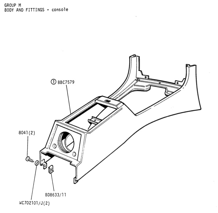

Does anyone know how to remove the Center console of an 86 xj6 VDP. I can't find it anywhere in the manuals. I already have the dash out. But can't seem so find any screws or anything for the Center console.

im not entirely sure but if you remove the ski slope and center console insert i think they are under there. otherwise there is some behind the radio / heater control pannel from memory.

Here is a link to a pdf with all of the parts exploded showing where all the screws fit and what they hold in place:
https://www.dropbox.com/s/mp17lkqsxz...LE%20PARTS.pdf
If I understand you correctly, you want to remove the two screw pictured below, beneath the rear corners of the entire console set up. Either way, that pdf link should at least depict what you are describing.
Hope that helps.

Wow thanks john. Thats amazingly helpfull!

I had one hell of a time figuring out how those ashtray holders (the nonremovable casing around the removeable cannister inside) were affixed to the metal surrounding them on the underside of the whole underneath the center console until I saw the diagram on page 2 of the pdf I posted. Tiny screws!
