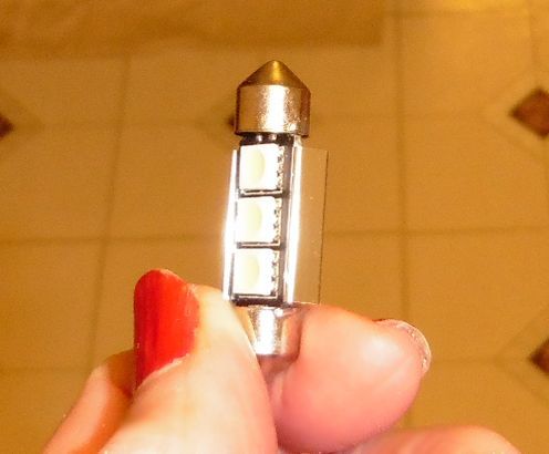

I got the LED "replacements" for the pillar lights, what a disappointment! Each 'bulb' contains 6 individual LEDs with tiny lenses to focus their light forward. For their size they're quite bright, and they might be OK for glove box but they're Not enough for courtesy lights. I had better light from the incandescents. I don't think it's gonna work for the map light either; simply not enough photons produced. The search continues there too.
Edit: No markings on them at all, I know the po got them off ebat. (Xenon white LED's) First pic has the defuser on , secoud doesn't.
See link below, mine measure about 35mm.
2X 36mm 3 LED 5050 SMD Xenon White Festoon Error Free CAR Auto Light Bulb NEW | eBay

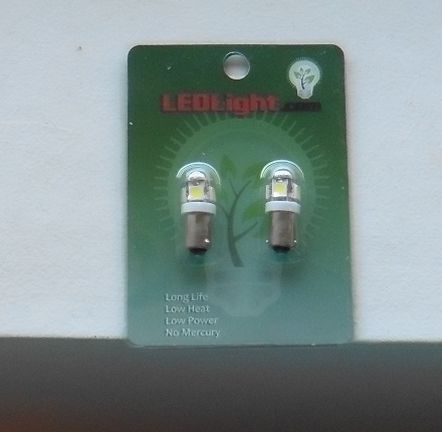

This morning in the mail I got the LEDs I ordered a few days ago from
BA9S 5 SMD LED 1.5 Watt 12VDC - Automotive LED Lights - LEDLight
Each unit consists of 5 individual LEDs that are configured in such a way that they take full advantage of the Opticell reflector. I put in the incandescent bulb and then this one to test how much heat was generated, almost None with the LED!
Not only that, the 5 together are VERY bright! On this bright day, in the shop without lights but full North facing natural light, I can see the heater controls when I turn the lights on.
The Ing and Lights are less bright but that's not surprising given the inverse square law of electromagnetic energy (all forms of radiation including light): For double the distance from the light source, the light falling on a surface is divided by 4. The Lights and Ign switches are about twice the distance from the Opticell as the heater controls so it follows they are only about 1/4 as bright. I don't mind that, because it's obvious if I have the ignition or lights on. But it's not obvious where the heater controls are set.

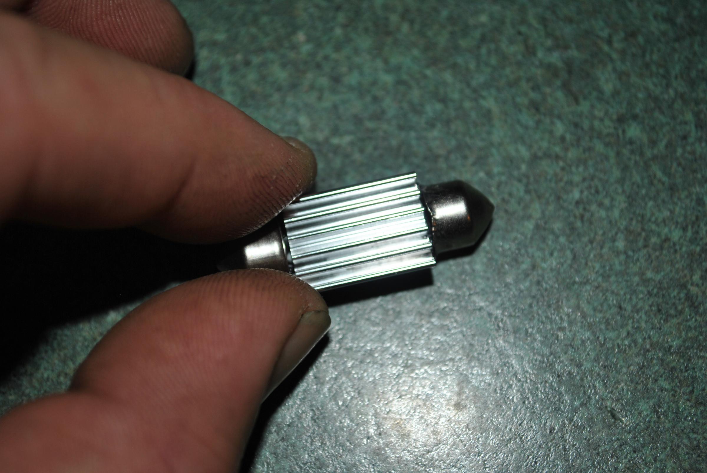

I nearly missed the mail today! I would have had to wait another day if I hadn't thought of it this afternoon.
The LED pillar lights have arrived! They're a bit blue and that doesn't enhance my yellowish interior a bit! But they're certainly bright enough so I can find the key hole in the dark. I imagine the map light will be bright enough to even read a map! Now that I know what they are, I might look for a warm white as opposed to these cool whites.
They're the Cutest things! 3 LEDs mounted on a little PC board which in turn is mounted on a heat sink! Total length, 35mm. (They require 1/2 inch breathing space behind them which is no problem in either application where I plan to use them.) Unlike other LEDs, these have no polarity. Husband says they've put a bridge rectifier in the circuit so they'll work either end up.
I misunderstood the packing arrangement. There are 2 bulbs in each package, but I missed that little detail, so I ordered 3 to be sure I had one for the map light. I received 3 packages of 2 lights each; 6 lights.

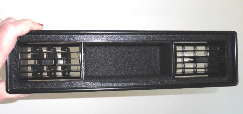

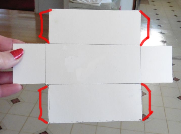

Everyone knows the stock center vent in the Xj6 series is mostly useless because the vast majority of cold air is directed into the back seat, where only Korean midgets or very small children are able to sit in relative comfort.
I saw that someone closed off the center portion of that vent by making a small box and directing air into the louvers of the end portions of that vent. This would also have the effect of directing more air to the side vents at the ends of the dash. It seemed like a Capital idea so I stole it.
Not wanting to make a permanent modification in case I don't like the outcome I got a center vent from a SIII to butcher. Not to worry, it had several broken links in its own center section so there was no loss when I broke them all out and smoothed the sides with an aluminum file. But I was on a roll that evening so I didn't get any pictures of the louver-less center portion or the process making it that way. Sorry.
Measurements of the center portion as follows:
Width; 4-3/4 inches (120mm)
Height;1-7/8 inches (50mm)
Depth; 1-3/4 inches (44mm)

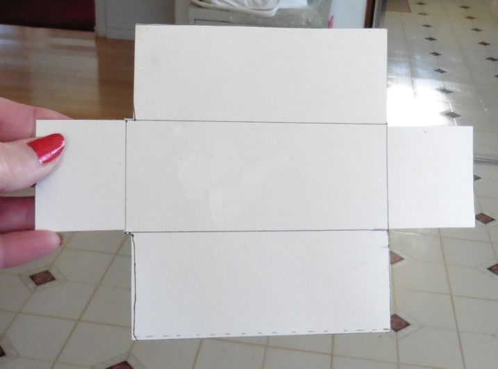

With these measurements I made a box from a heavy cereal box and bent it over a straight edge until it fit snugly in the hole; second picture below.
Then I sprayed it gloss black and let it dry for several days until well cured.
I got some black felt from a craft store, cut it to the sizes of the sides and back of the box, glued it to the box with black weather strip adhesive ONE PANEL AT A TIME (be sure to leave space for folding or the felt lined box won't fit into the vent), folded it up and glued the felt lined box into the vent, again with weather strip adhesive.
If you've never used The Black Death be aware you must be careful or you'll have it All Over Everything including your hands, work area and project.
The finished vent is pictured third. It will Just hold my phone.
