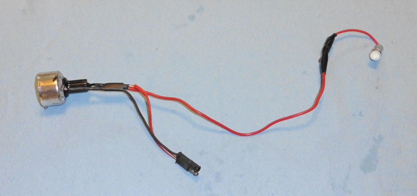

One thing I want to do was upgrade the light source in the Opticell to a much brighter LED. Also the shifter indicator light has Never worked, so I have to actually know which way I'm going as I can't see otherwise if I'm in reverse. The backup lights don't work properly (they come on, just not in Reverse) and I can't see a way to adjust the position of the switch, so I want to put them on a toggle so I can turn them on at will (if he wouldn't mind). I also want to put a cutoff switch in the AC compressor relay power wire.

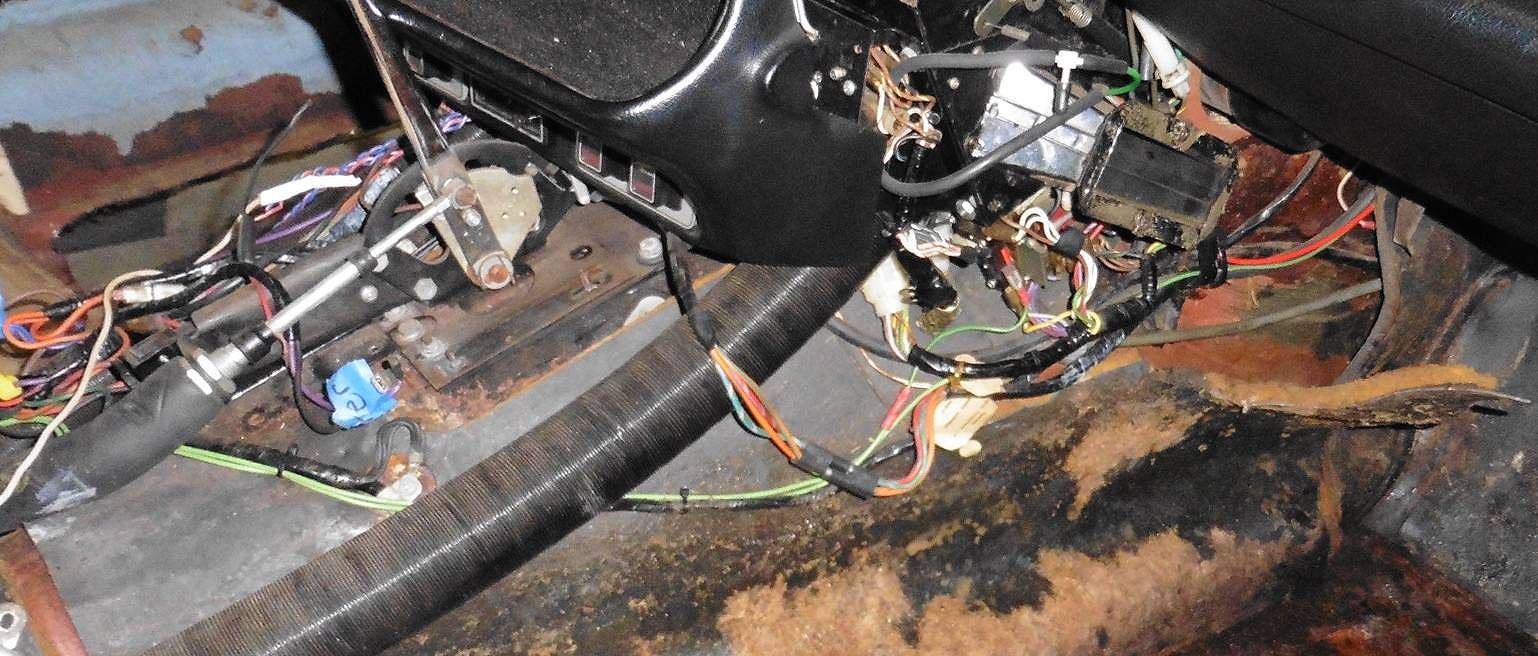

As I've excavated layers of wiring and trash (numerous extra screws, washers and lengths of electrical tape, not to mention extra wire) I have made some interesting discoveries. In the picture below you might take a look at that white wire in the center. Take special notice of the left end, just beyond the splice (Yellow arrow). Do you like that inch of bare strands?
And look how it's threaded through all the other wires past the Vampire clip. The other yellow arrow points to where the tape on that bundle was cut and opened where that wire originally exited the bundle and plugged into that relay. At least they used white wire! Some of these splices they just stuck in any color they felt like.
That stubbed off bundle sticking out from under the shifter is why the cruise control doesn't work (apart from the fact there is no mechanism for it).
I had to cut the red/blue pair at the white arrow. They power the alarm LED; you know, the little red flashing one that warns others you have a car alarm and they'd better stay away? They installed the LED from the top of the panel and made no provision for unplugging it. That will be fixed.

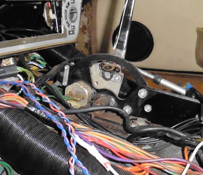

I have a big can thing on the shifter with 2 green wires. I'm thinking that's the backup lights? I'll see if I can adjust it any, or if I can even make a slotted hole.
The neutral start switch is up at the front end of the shifter, I found that just fine. It needs adjusted and/or cleaned because the car starts Just Fine in Reverse!! That was exciting I tell ya!

As to the N/S and reverse, tis matte of fiddling to get the right adjustment. You have to keep in mind that the gates on that original shifter tower are for the BW, not quite the same as the gates for a GM transmission. But, doable. I chose the XJS shift tower as it was configured for a GM transmission. That is what some of the XJS V12 cars used.

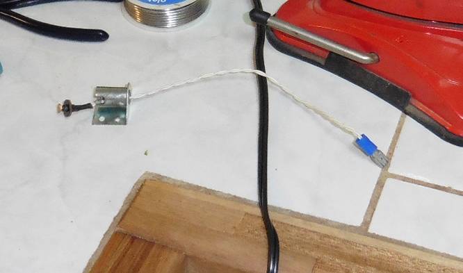

I thought it would be good to start slow with something relatively simple so I spent some time cleaning up the area from where husband cut out the rusty floor. Then I ran the compressor shut-off wire up to where it will connect to the window cut out switch on the ski slope.
Once I found all the parts it wasn't hard. First, the wires to the window cutout switch had to be connected together as I would Really like for the windows to work. I found a double tie-down in husband's electronics stuff which was Perfect! I wrapped the stub well to be sure nothing would short out later.
When the conversion was done the OEM compressor wire (green/brown) was unplugged from the servo and left hanging, and a new solid green wire was run in its place to the compressor relay, which is on the compressor on my car.
Husband just happened to have a spool of the exact same green wire in the shop! I cut into the existing wire, threaded the end from the spool through what seemed to be a safe and secure route, spliced the spool end to the compressor end coming out of the firewall.
Then I threaded another length exactly parallel to the first one and spliced it to the short piece coming off the servo. I put female spade connectors on both extensions. I have continuity throughout.
To keep both extension wires under control I zip-tied them to other bundles that lie along the route to the switches, the last tie being very near the merged ends of the window cut-off wires. There should be No trouble with them reaching the switch Just Fine!

Today I *Finally* found sockets that will work as replacements for the Opticell socket and the shifter indicator socket. I haven't specifically mentioned that the Opticell socket was so loose inside it was about to have a dead short and blow another GOK hidden fuse. This was also why it only worked some of the time. It seemed wise to deal with the socket issue while I have everything apart, along with upgrading to an LED source.
Plastic was the only material available for the Opticell replacement socket, but at least it does have a steel insert to which I could easily solder a ground wire. After that it was simply a matter of connecting the original colored harness to the socket -- Including making a soldered Y-splice to replace the vampire clip that fed the accessory socket light. Both of these are now LEDs so the current draw should be a mere fraction of the incandescents they replace.

Previously I mentioned how the shifter indicator didn't work when I got the car, and how the whole socket, bulb and all fell apart in my hand when I took it apart, and how all the parts weren't there anyway, and how it had been cobbled up to the point I had no idea how it was originally constructed. No one had their console apart at the time to post a picture of how this was intended to be so I knew I would have to find a replacement socket for the LED (I got a green one for this application) upgrade and do what I thought was the best option given my ignorance of the original configuration.
Husband The Searcher finally found the part number (S20) of a socket that might work for the shifter light but also might need a few alterations. I was completely Amazed he found one with a mount so close to OEM!! It indeed needed new holes after I discovered the existing holes made it mount too low but that was SO minor.
The new socket also came with a wire that was obviously too stiff for the continual flexing it would undergo when mounted on the shifter. Husband had some Really Fine Flexible wire of which I twisted two strands together and soldered them to the nail-head hot contact of the socket and put heat-shrink over 'just in case.' (Seeing as I'm replacing the incandescent bulb with LED the current draw will be a mere fraction and those Tiny wires should be OK.) Then I soldered a male spade connector to the other end for ease of disassembly in the event I ever have to take this apart.
I found where they got the power for this indicator; a *"Person"* who worked on this prior to me had vampired off the clock light to feed the shift indicator. ( I shortened that wire and put on a female spade connector for the shifter light.). However, during that first renovation that wire was installed so short and was so stiff that I imagine it might have worked correctly for about 15 minutes before the wire broke off the bottom of the socket. This was probably not entirely a bad thing as all the fuses for this stuff are buried and hidden God only knows where.
So anyway, I got the socket modified for the super flexible wires, soldered a male spade connector to it drilled new mounting holes and connected it up. As it's a hot wire I taped the connector with white electrical tape. I have run the shifter through its full range, Park through 1 (which I Never use), and there is no stress on the indicator wires.
I haven't put power to it all as yet because there are entirely too many other things to be done to the car before I ever connect the battery. But I'm confident this will all work better than it did when I got the car and that is my definition of Success.
Ah, looks like Lnr is really out to straighten the POs follies, good going. Can you give me the bulb sizes for the opticell and shifter please? Ive done the dash, need to get to these. Thanks, and we love gawking at the great pics you post
I'm not sure I understand what you mean by 'sizes.' The original shifter bulb had a number of 1893 stamped on it. It has a T-3 base, 9mm diameter, miniature bayonet.
The LEDs are called Instrument Dashboard Gauge Lamps replacements, it's an assortment of 8/$12.79; 2-Ice Blue, 2-White (which looks a bit blue to me), 2-Red, 2-Green. They came from eBay, seller keylife. Power isn't listed but they're Bright!
The Opticell was originally a 5 watt bulb, feeble on its best night, but with the socket coming apart it was literally hit and miss. The replacement is called Xenon White, 3.5w, LED Interior bulb; came in a 2-pak/ $4.34. eBay seller, abl-powerzone. They have a domed lens built in and are Really Bright!! Well, you can imagine a 3.5 watt LED!
Husband thinks in might be too bright for the Opticell, but he doesn't know just how feeble the incandescent was as he never rode with me at night. I will say I haven't actually tested these for operational brightness, but they have to be better than what was there before.
Not to hijack this thread, but in my S3 XJ6 there is a ground strap that I had to remove to rework the gear selector. I cannot remember where it is bolted to though, anyone have any idea what it is grounding? Thanks
No worries about hijacking the thread, all information is good, all questions are relevant to someone. I've learned some of the best things from "hijack" posts.
My car was converted to a Chevy 350 almost 30 years ago, I don't see a ground strap on the transmission. I assume it's grounding through the engine which has a Really Good ground that was added soon after I got the car.
A couple of things.
1. A separate ground strap from shift tower to floor pan as opposed to the original jaguar strap down under from transmission to chassis? I don't recall the former beig present when I was in that cavity?
2. Yup, the shift indicator light in my car was just lying in the cavity, loose. A black plastic receptacle with an ear to secure it in the little 90 degree bracket. But, the plastic ear was busted off. Well, not elegant as LnrB's fix, I merely used a tad of safety wired to secure it. It does work, sorta. Bright, uh,uh.
3. Remember the old tech long reach telephone cords? Coiled to allow expansion and flexing. Very early on, we used them to "elegantly" cover wiring. But, a coiled wire works. Just wrap a length around a finger to form a coil. At times, I've done it in the engine bay, just to look "cool".
4. In order to get the n/s micro switch synchronized and the reverse switch also synchronized, the shift tower must be removed and the work done on the bench with the aid of a VOM for continuity or a test lamp and a power source for the bench. Each fiddly, but doable.
The mostly useless Haynes book has some schematics that might apply best to the S1 and S2 cars. Perhaps color codes that might be there could ID the needed wires and the unneeded.
