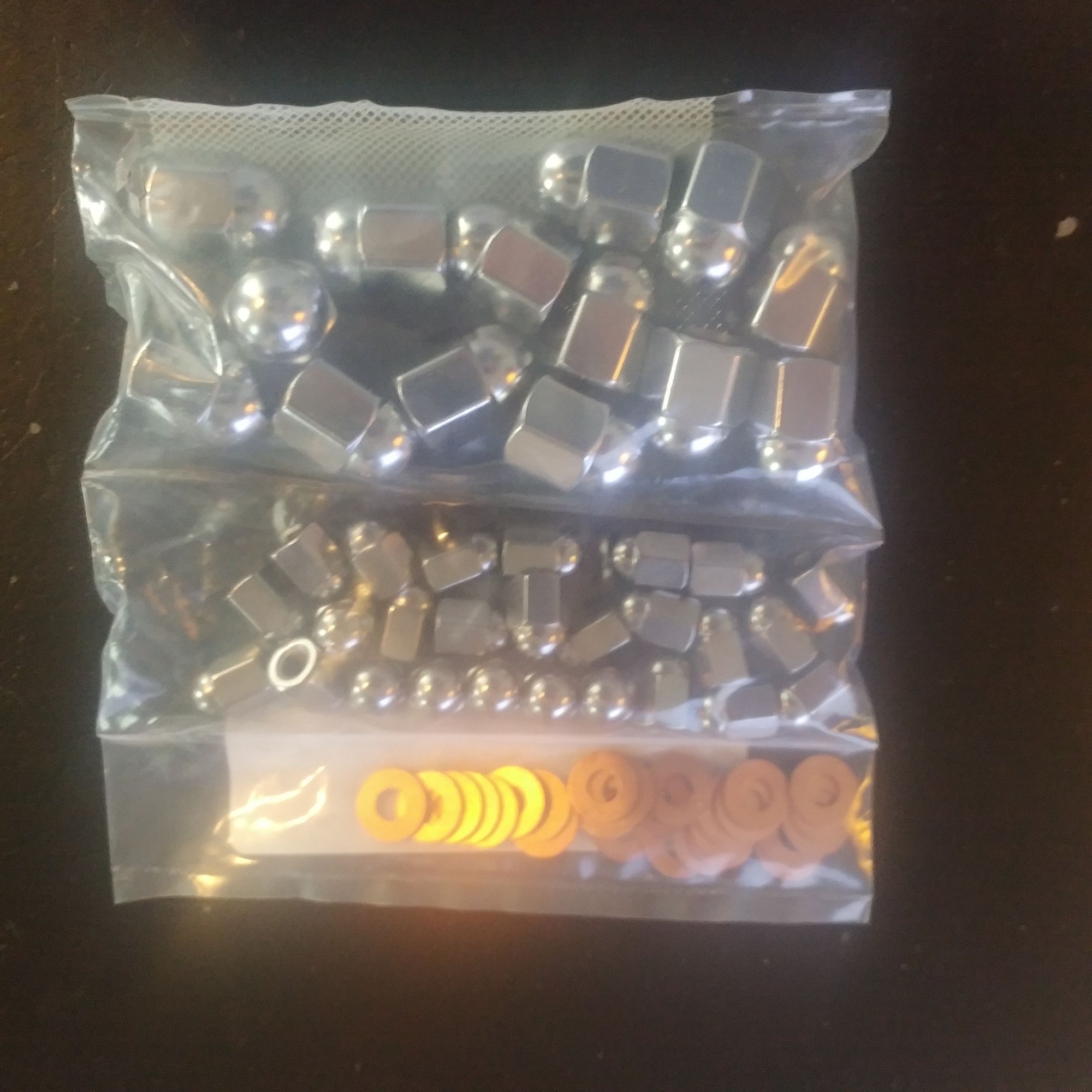

I had a strange problem yesterday that hopefully I can get some clarification on. On my 4.2 6-cylinder engine one of the center head bolts on the passenger side started leaking coolant from around it. I tightened it down to 75 ft/lbs; it was loose. And the leaking stopped. So... two questions:
1. The service manual shows the head nuts to be 7/16" which we know is wrong. It's a 3/4" nut. And it says to tighten to 54 ft/lbs. Which I don't think is enough. What is the correct torque?
2. Why coolant leaking out of the nut even if it was loose? Is the washer under the nut supposed to prevent coolant from coming out?
Thanks, Bill

Alright my well respected Colleagues - I said the head nut was loose, but I didn't really tell you how it got loose. So bear with me - I'm going to my first car show tomorrow (well actually a Cars and Coffee at the Elliot Museum in Stuart, FL) and I wanted to further dress my engine up. So... I got a kit from John Gordon in England with chrome head and cam cover nuts (and copper washers). And figured on removing one head nut at a time, putting the chrome one on, torqueing it down, then proceed on. And the first one I tried started leaking, hence my post. I know, pretty stupid. But... "stupid is as stupid does". It's not leaking and I'm not losing coolant so I'm figuring no harm, no foul.
My next course of action is that I have the project ahead of me to put a temperature sensor in the upper radiator hose and connect it to a digital gauge I bought so I can see the actual readout instead of just the OEM analog gauge. I'm mounting it in the console ashtray. That involves emptying the coolant out. But I wanted to clean and flush the coolant system as part of that project anyway. So I figure once the system is empty I can remove one head bolt at a time and change over to the chrome ones. Yes, I know that it is risky on a few accounts. I might actually be removing the stud with the current nut; I might break a stud (big time problem); some nut might leak when I'm done filling it back up and running it; I might disturb the head gasket, etc. I'm thinking I should heat each nut prior to cracking it loose. Any thoughts, opinions, slap up-side the head comments?

I used chrome head nuts once. Years and years ago. Can't remember where I got 'em but they were not quite right, despite being advertised for XK engines. The problem was they were not quite deep enough so, on torquing them down, they (just barely) bottomed-out on the stud before full clamping torque was reached. End result, water leaks. I ended up using double washers, backed-up with a dab of sealer, and all was well after that.
On the XK head gasket jobs I'e done I use a small bead of Teflon sealant around the stud, turning wet studs into dry studs.....for as along as the sealant stays intact, at least.

All great information - thank you. Grant - your story is an sobering eye opener! Guess I'll just do the cam covers and leave it at that. IF I ever have to take the head off for a head gasket change, that's when I'll entertain the shiny bling. And I'll keep in mind the nut bottoming out thing Doug. Thank you all for keeping a potential disaster from happening. I kinda guessed it but nothing like the voices of experience. Went to the Cars and Coffee thing this morning, and my XJ6C got all the attention she wanted despite silver painted head nuts.
