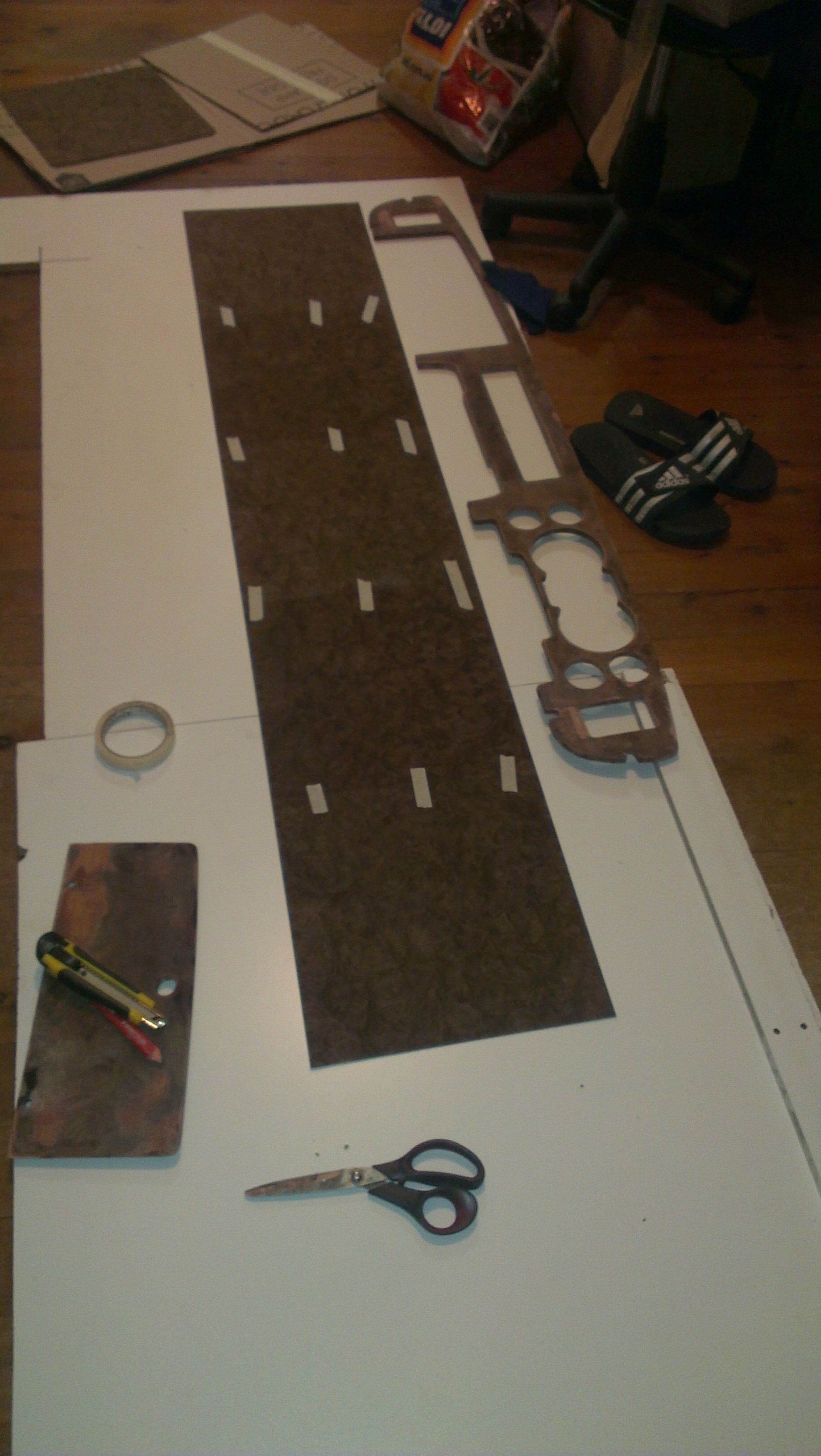

Re doing a spare dash board while i wait for a new oil pump to arrive
Attached Thumbnails dash refurb-imag0935.jpg   dash refurb-imag0938.jpg   dash refurb-imag0939.jpg   dash refurb-imag0944.jpg   dash refurb-imag0945.jpg

Very nice. What glue did you use?

Sikabond techgrip, polyurethane glue

How did you use it? Spray, spreader, brush? How did you clamp it whilst drying?
I'm planning to do one myself so any info is useful.

spread the glue with a scraper so it was even on the dash then placed the veneer on, grease proof paper and a few sheets of thick mdf for weight so it stayed flat.

I used araldite on the xjs (metal backing) after a couple of mishaps using normal spray glue, worked but it was a pain to use.
