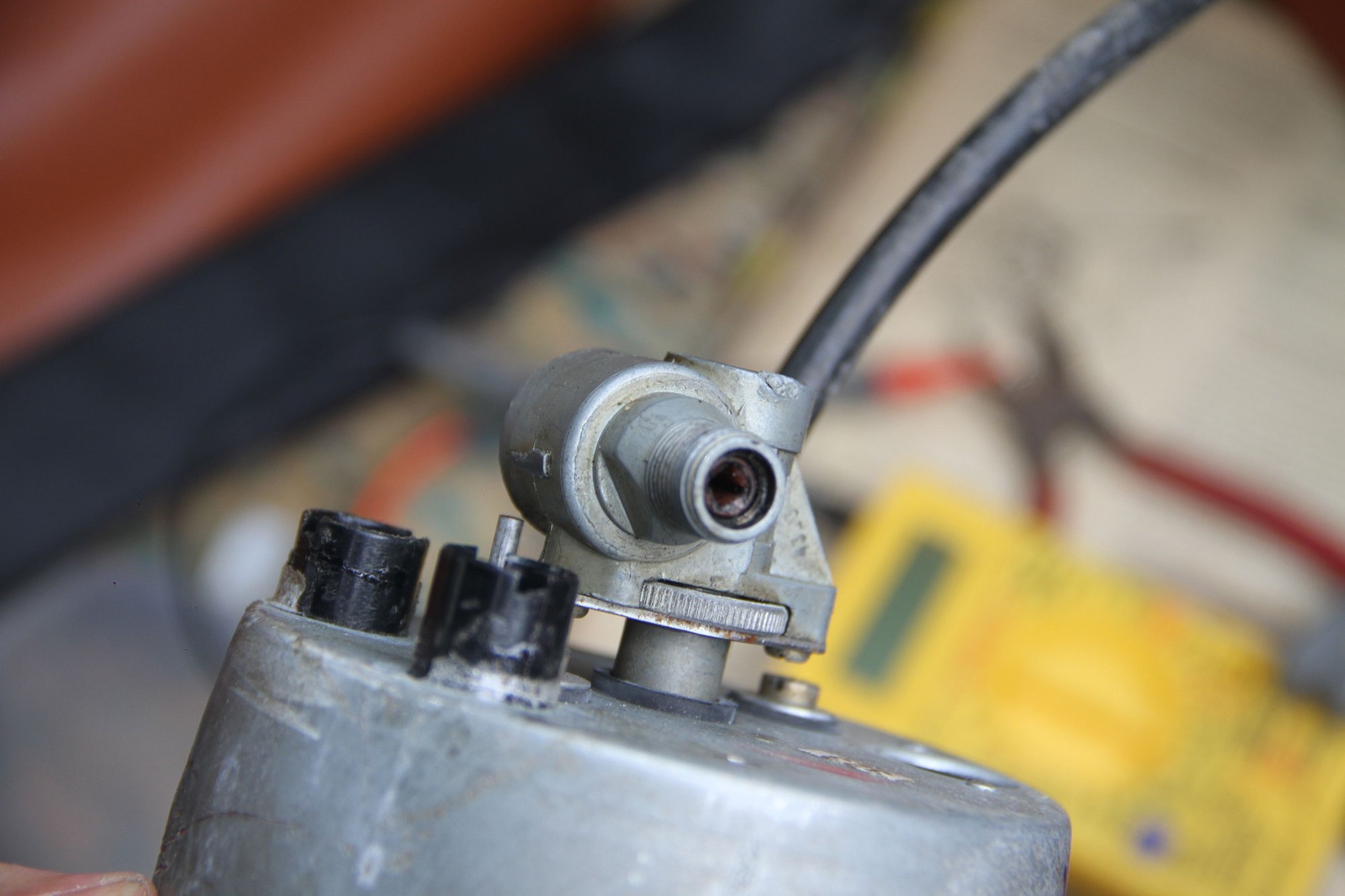

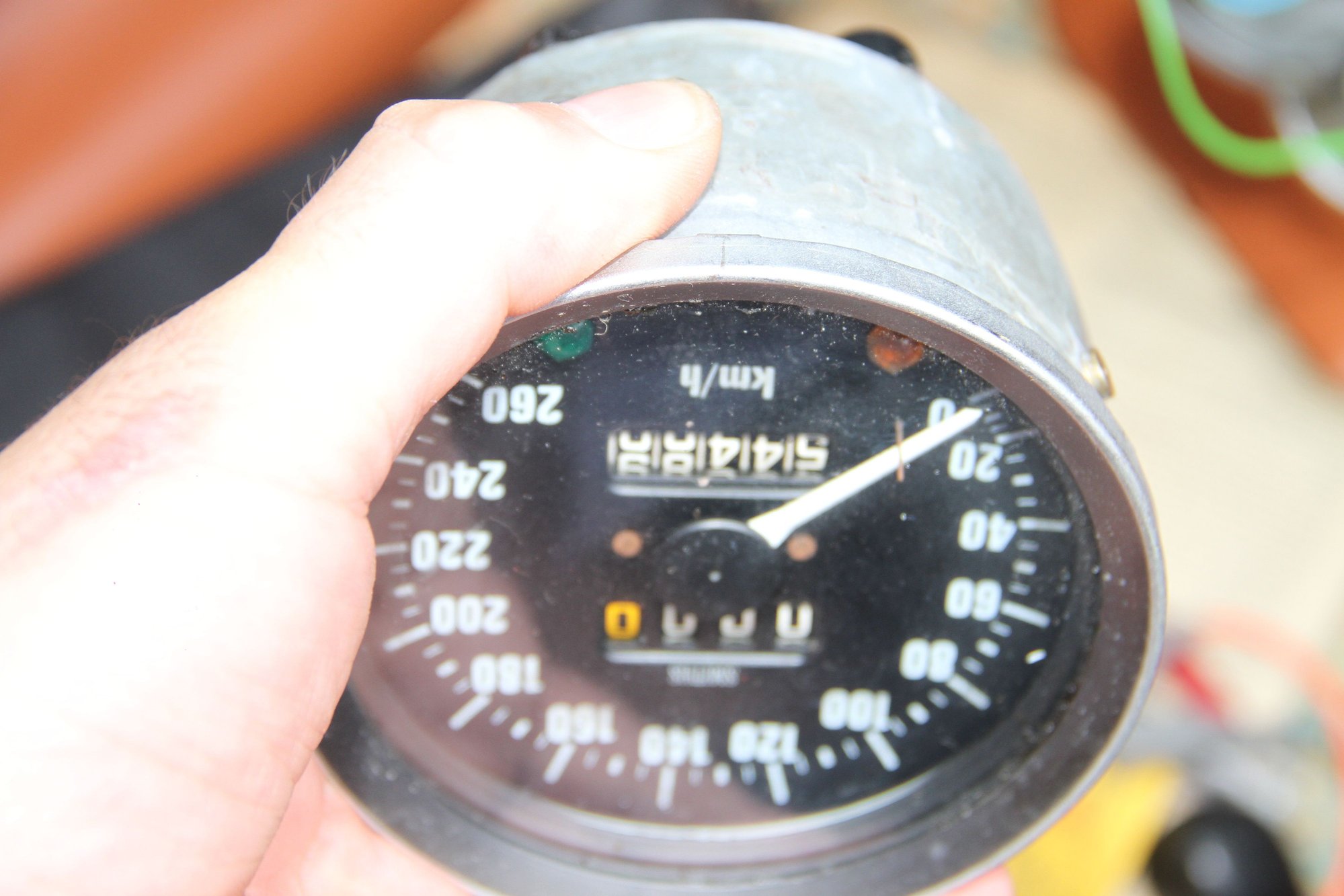

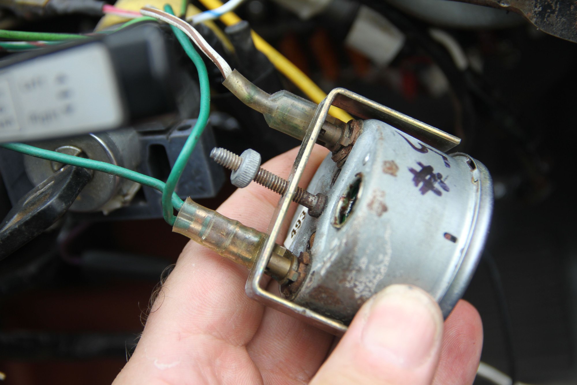

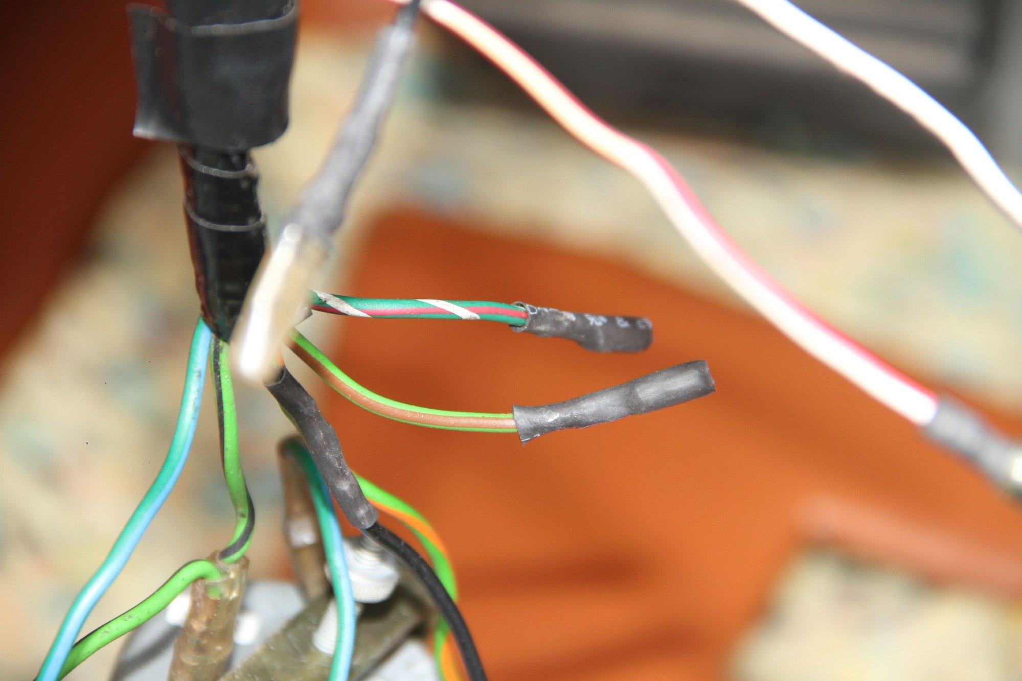

Most of these are connecting up logically, as per my notes (which require some translation in places) but a few oddities. Concerned with speedometre that something might be missing on top where it connects to the cable, on the reverse side of the connector. I'll add colourful pictures and see if it sparks anything .. so to speak.
fuel and water dangling
main colour and tracer normal but then swirls not covered in most lists here i have a green with red trace and white swirl

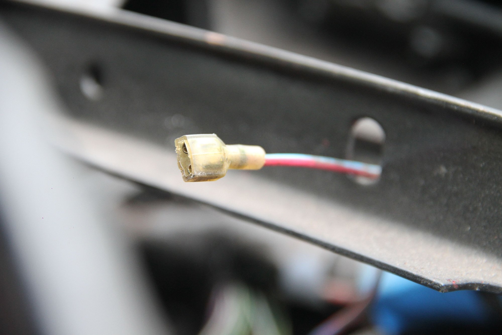

this guy is red with a pale blue tracer and most lists have it an unallocated
purple with black trace : horn relay?

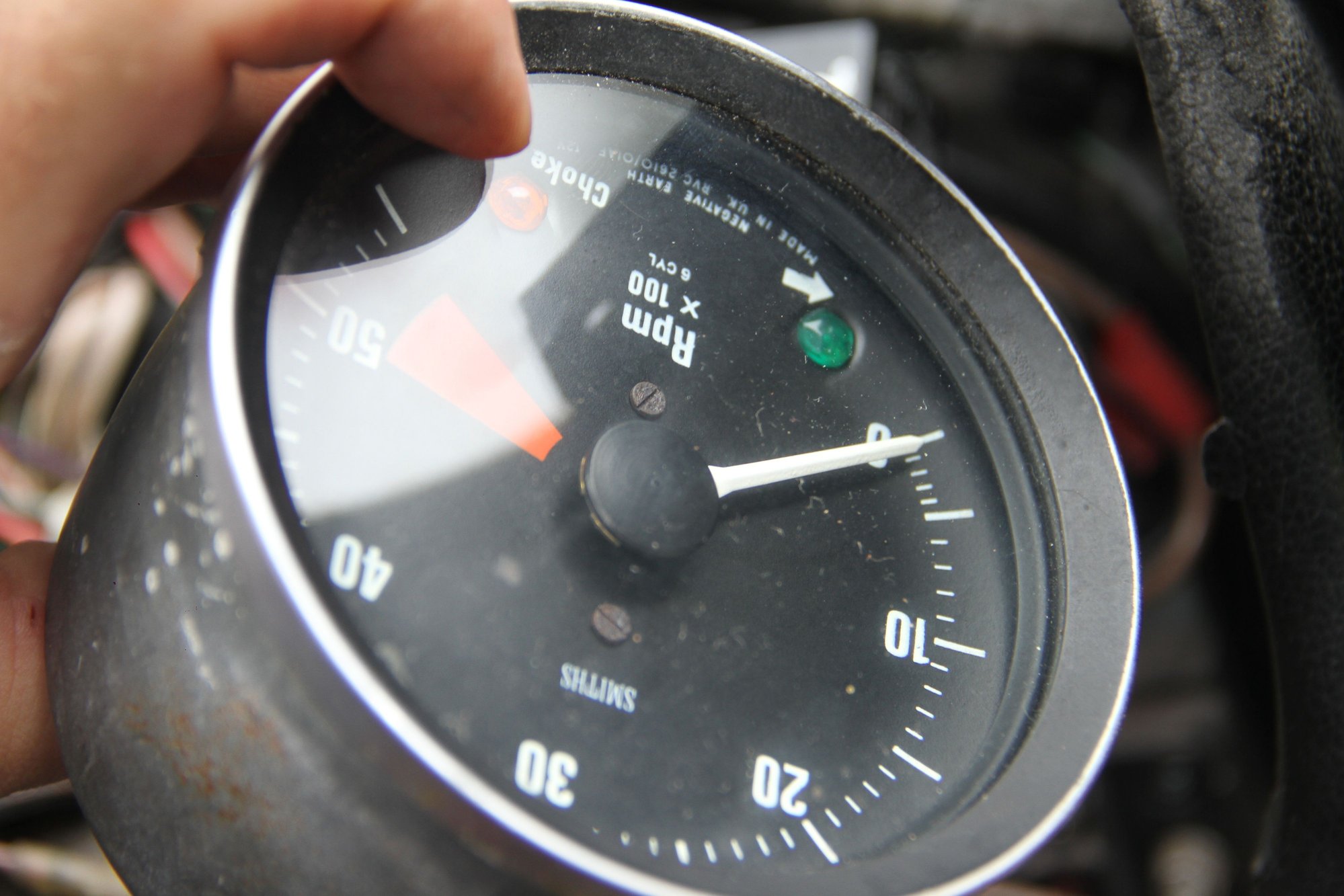

tach

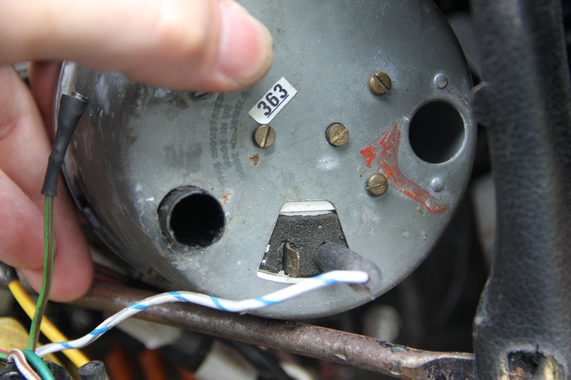

363
where the orange circle thing is seems like there should be a cap or a stopper .. problem?

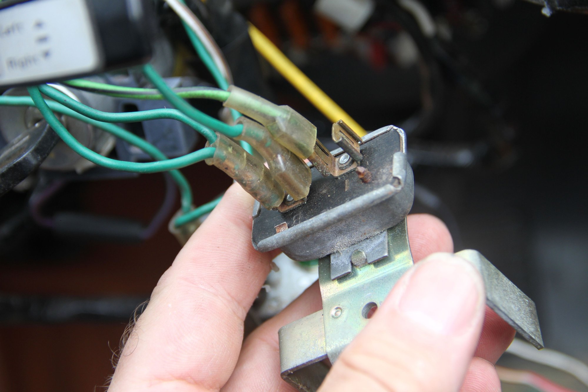

here's a white wire with a blue swirl ..! but connects here. the plug beside it don't have no plug, maybe green voltage stabliser but none free???

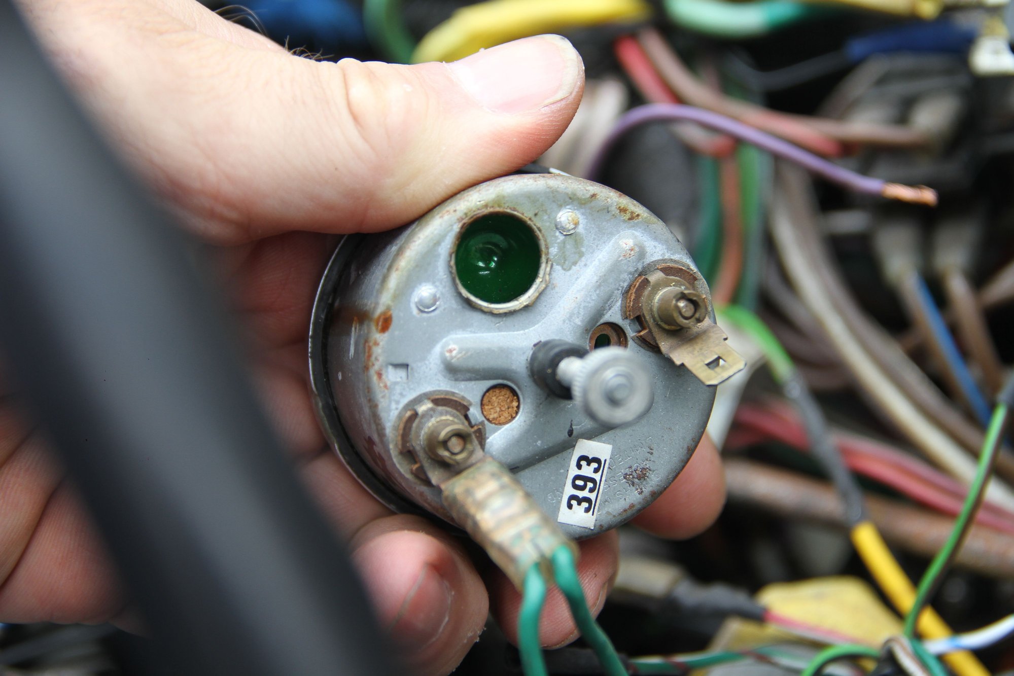

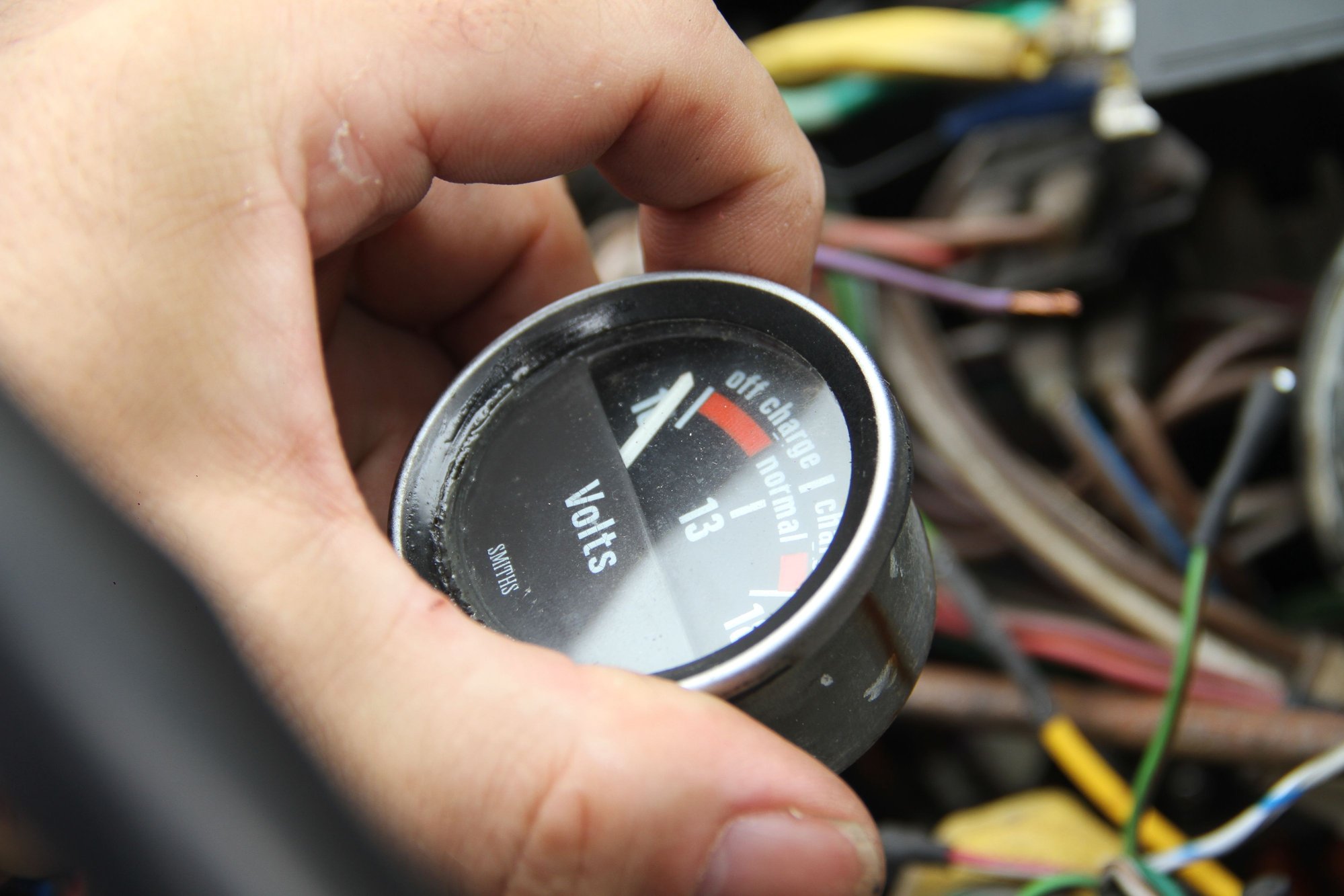

393 .. volt gauge
volt metre ... green stabliser one side but no battery lead?? what colour should this be.
the stabiliser thing .. does it need one of those blue things atatched, i have seen on some web image.

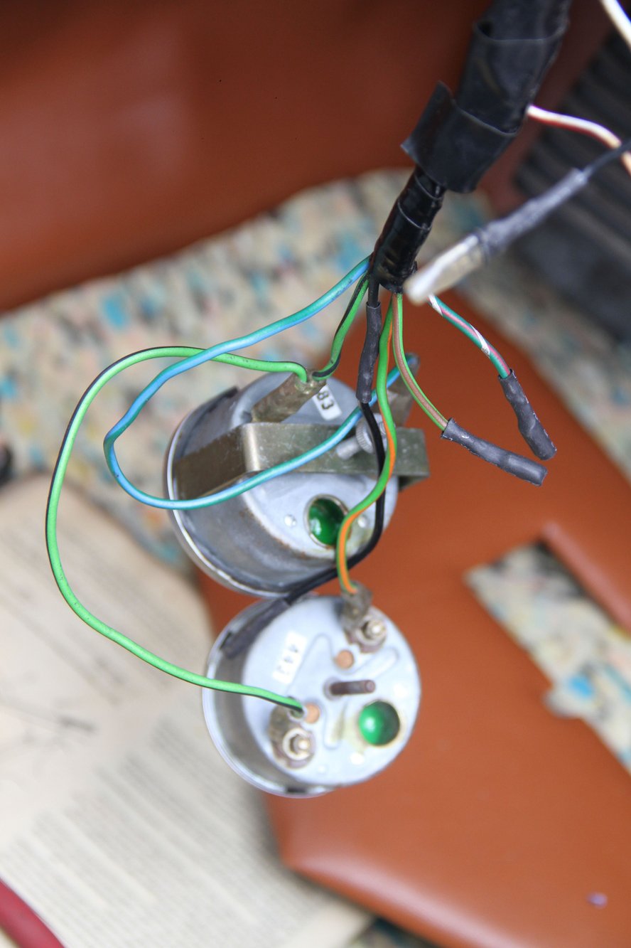

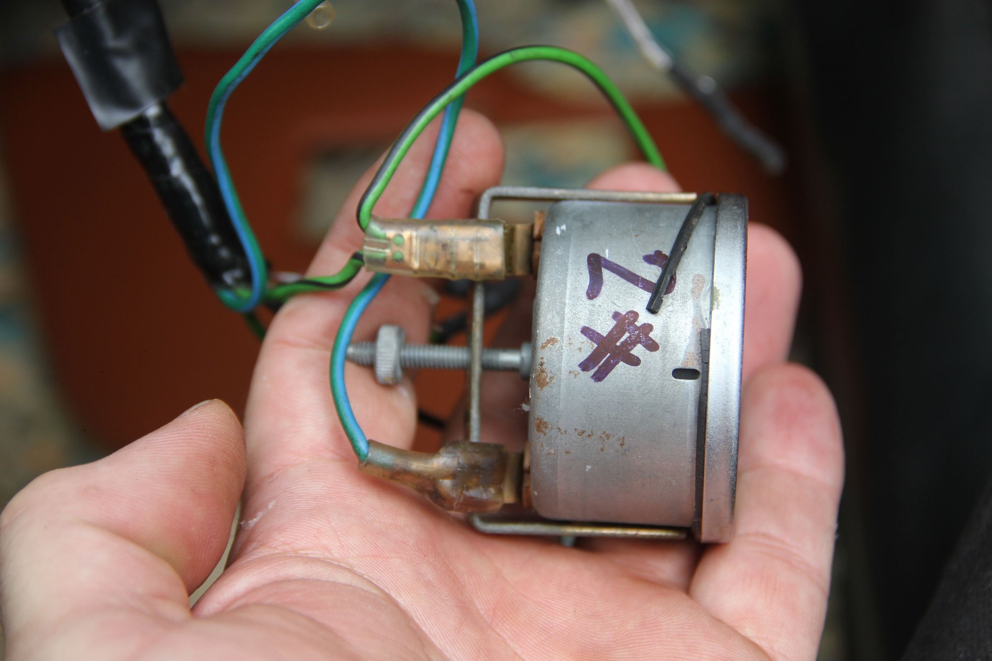

493 water gauge with brown/white wire and stabiliser green (sounds like a posh menu item)

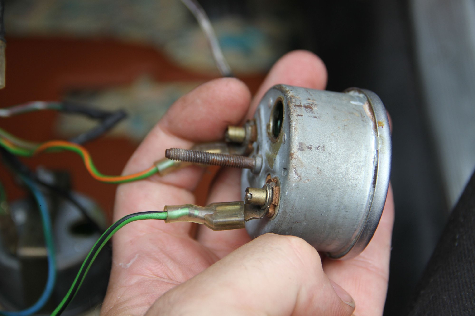

483 .. fuel gauge green/black and light green/orange
443 .. water gauge .. pale green blue wire and green stabiliser wire with daisy chain out.

There should be a cap or plug on the speedometer cable adapter. Might be on the floor !

Oh dear
thanks. been in a storage boxes for a year or so, might be quite a hunt to locate.
