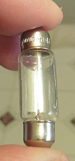

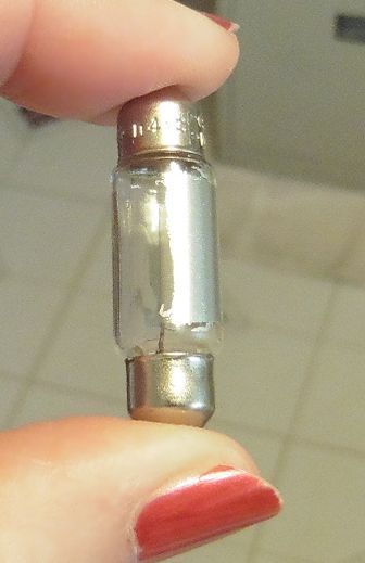

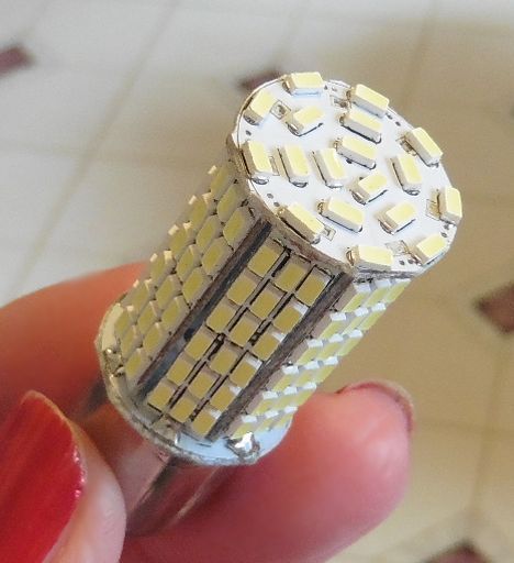

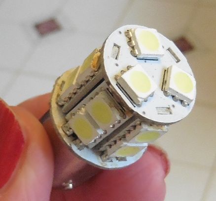

Posts: 26,776
Likes: 10,318
I tried several LED upgrades, did NOT like the dome lights in LED At All as they made the tan headliner a sickening greenish disaster.
To keep most of the light from the Festoons from being devoured inside the B-pillar, I *Carefully* taped the ends and half of one side, painted the remaining with Mirror Aluminum spray paint.
The difference is quite astounding.
The reverse lights out here in the Stix were Terrible! I replaced the bulbs with 72 element LEDs that fit Just Fine in the sockets.
The top socket has a 15 element LED, works well for me.
LED headlights are swiftly becoming less than legal locally, and I don't like them anyway, so I've merely gone to 55w H1s and H2s. They're supremely adequate for my driving style - Which, anyone who knows me will tell you, is, um, Enthusiastic!
