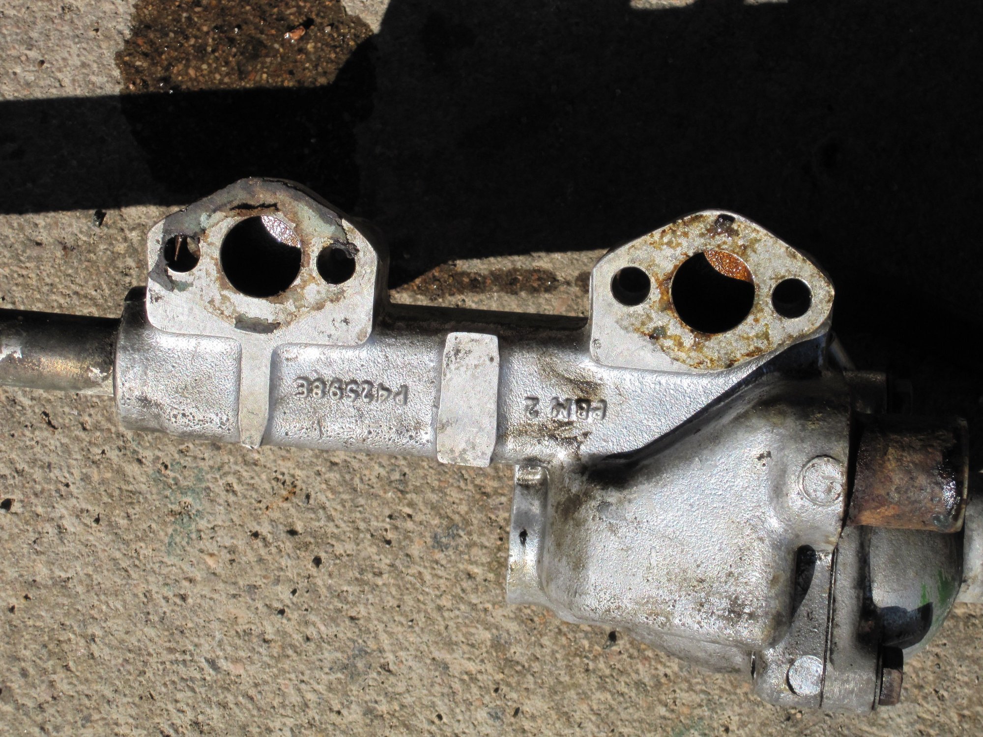

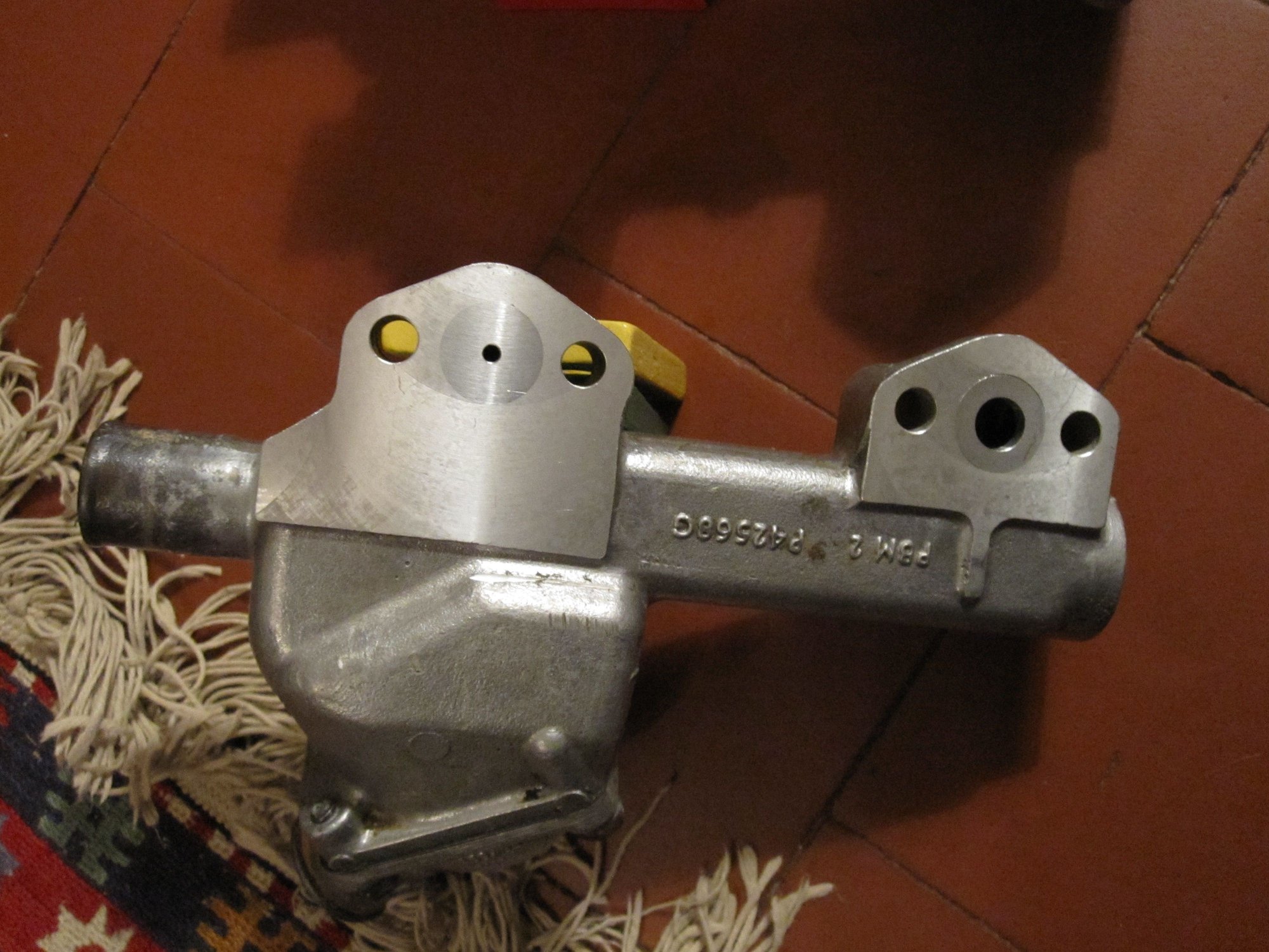

Here are some photos of the mod I did. A machine shop made up bungs with the correct Lutz sized holes in them that interference fitted into the OEM water manifold holes. For absolute certain this did help coolant flow to the rear of the engine, as the dash temp guage, the sender of which is on the front right water manifold, read a bit higher as soon as the mod was completed. This seems to me to be compelling evidence that preferential flow through the front water manifold had been reduced.
Before mod OEM sizd holes from the block into the water manifold, through which coolant returns to the radiator
Before mod OEM sized holes from the block into the water manifold, through which coolant returns to the radiator
Lutz modded holes
Lutz modded holes
Stage 1 mod holes are: Front hole:   rear hole:
Stage 1 mod hole sizes in the front water manifold are: Front hole: 1/8 inch (3mm), rear hole: 1/2 inch diameter (12mm)

Never tried blocked holes; but I do not recommend it. I think that with no exit from the block to the heads at the front you would creat a localised steam pocket at best, and a head//valve disaster at worst!
No reason not to slide in pieces of stainless with holes of the Lutz sizes in them though!
