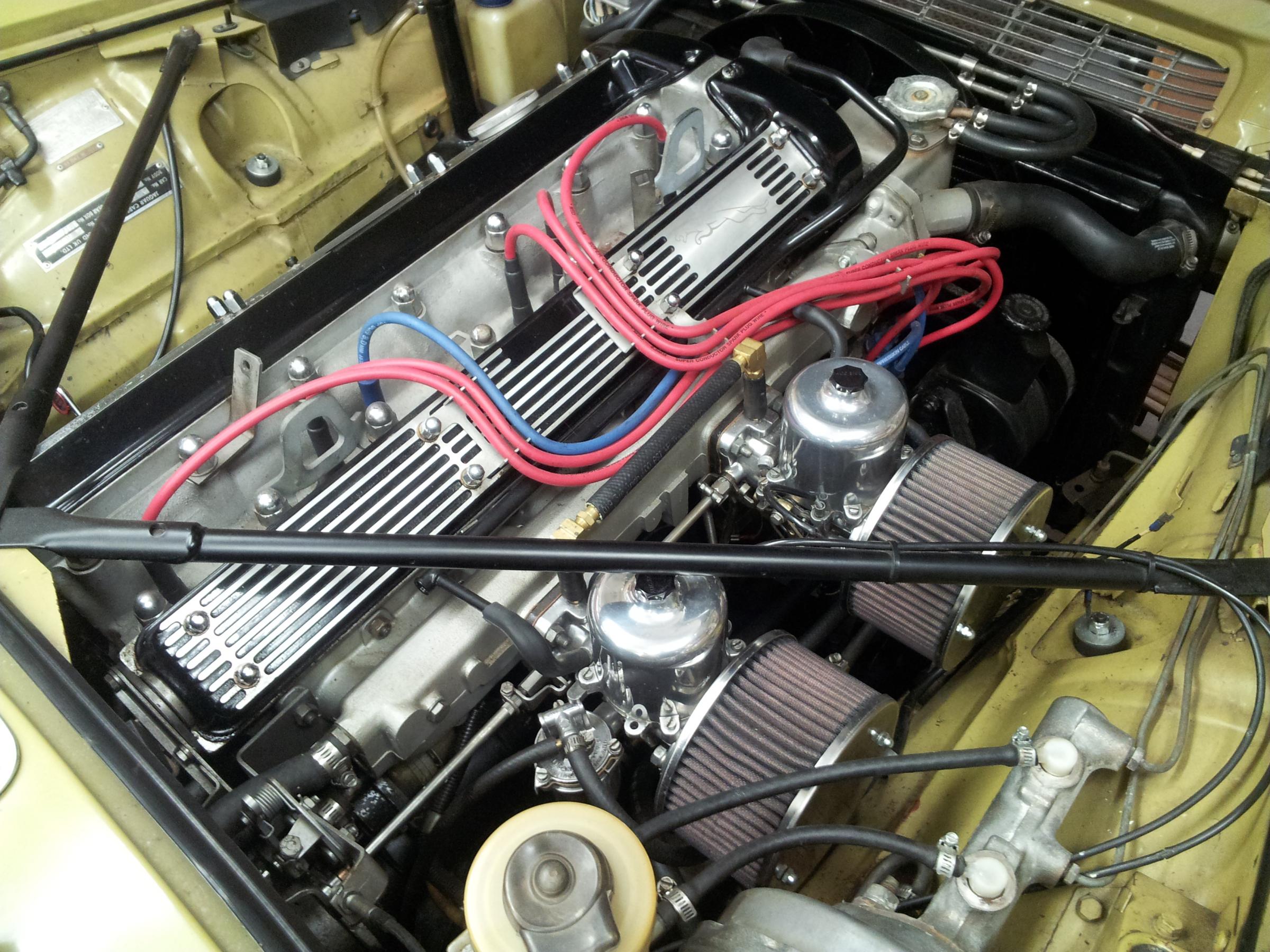

Here's a pic I came across. Not sure what year this XK6 is but someone did a nice job on it.

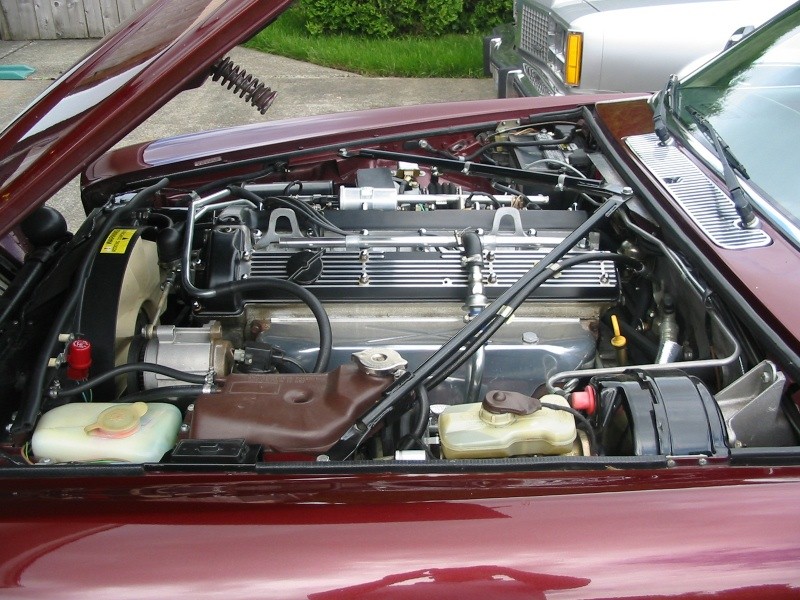

Here are a couple pics of mine. With the exception of having the exhaust manifold shield ceramic coated and a new engine fan it was a matter of simply cleaning, painting, or polishing what was already there, re-wrapping wires, and the like.
No dress-up items added, if that's what you mean

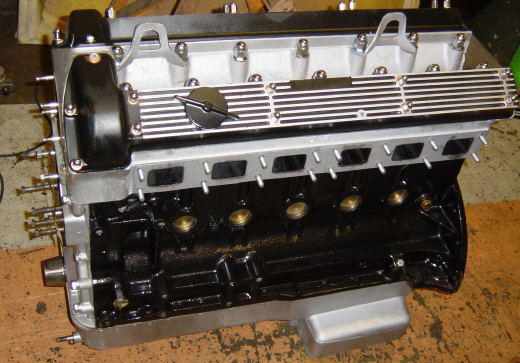

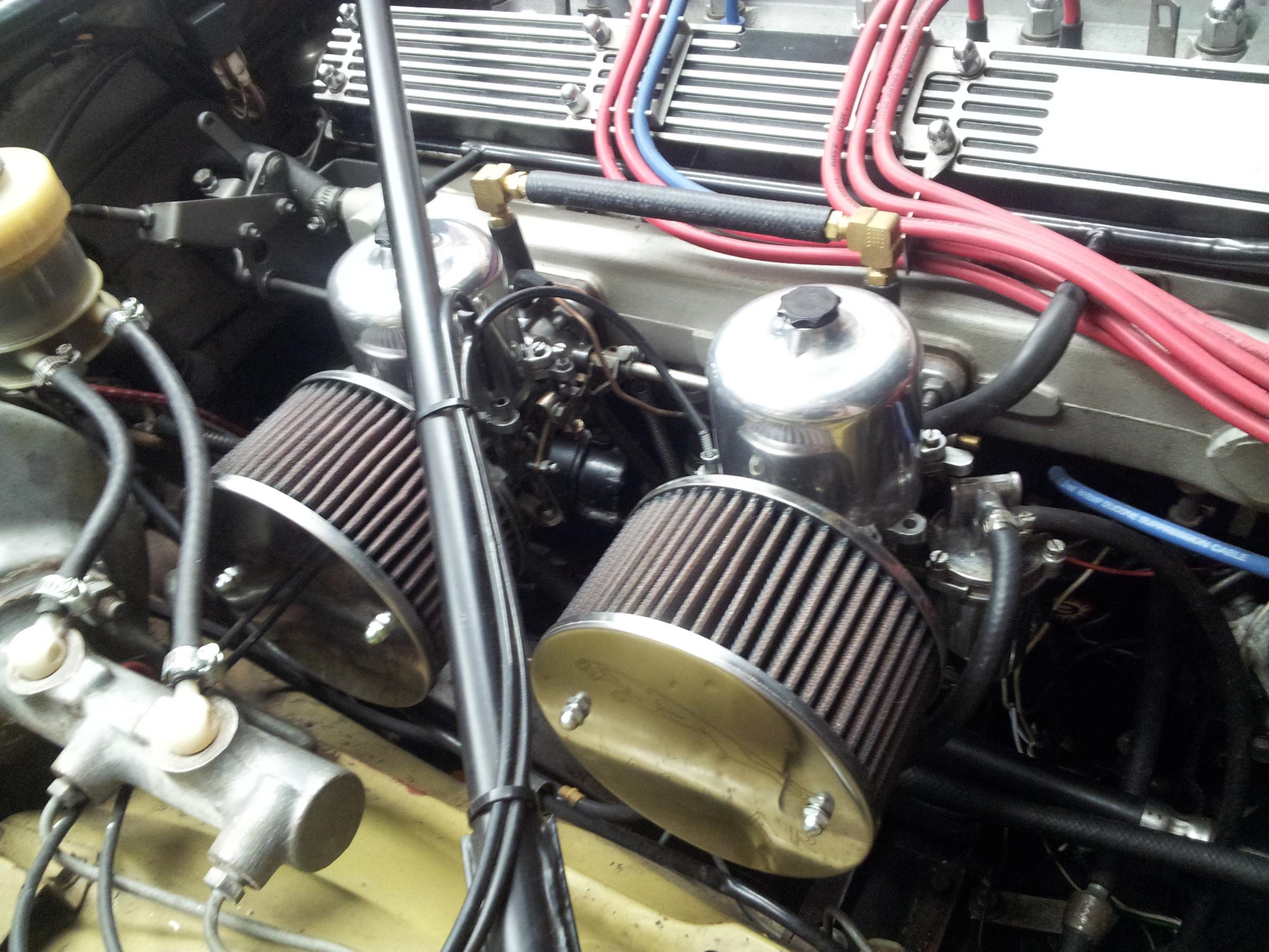

I didn't pull my engine and trans at this point but here's mine all shiny kleen. I glass bead blasted the aluminium parts and shot a clear on them. It looked ok, this time I'm going with powder coat and ceramics now that I have to rebuild the engine.
I had my shop powder coat the cam covers then machine a mm off the fins and it made them look factory fresh.

Doug: Looking pretty good under there. Did you paint a lot of the bronze parts silver? If so, what kind of paint did you use to hold up so well? What about the exposed aluminum on the head -- did you clear over it?
Napoleon: Good idea on the valve covers. Did you clear over the aluminum fins once they were machined or leave them exposed?
It was years ago so my memory is a bit foggy.
I recall that the air injection and fuel rails, breather pipes, etc were all anodized when Jaguar built the cars. Since the finish was long gone I simply polished them with increasingly finer grades of steel wool and sandpaper. In the end they looked almost like chrome.
I remember polishing the cam cover ribs to a high gloss but I don't recall clear coating them. I might have, though.
A local paint shop mixed up a couple aerosol cans of Crimson Red so I could repaint the sides of the engine bay.

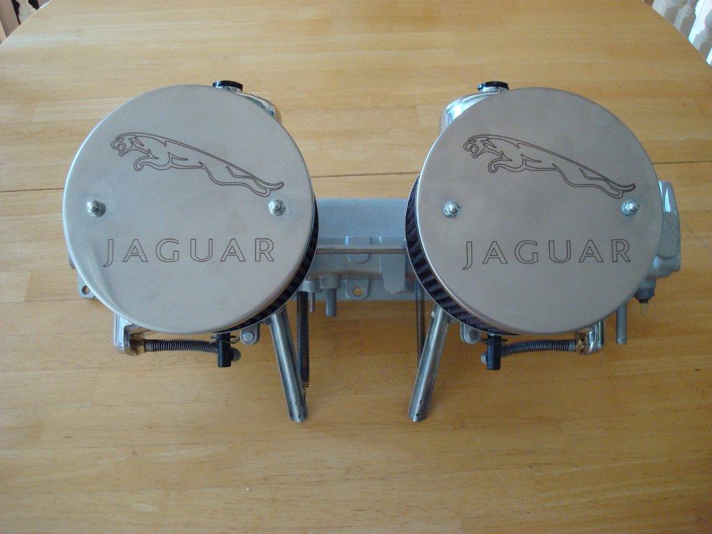

The cam covers I left as - is. Instead of going with the Jaguar sticker I had my guy laser etch the leaper on that spot, as well as on the K&N filter covers with the Jaguar text. I like things to look different but factory appearing...
I made my own wire guides and custom cut my plug wires so the leaper wasn't obscured.
