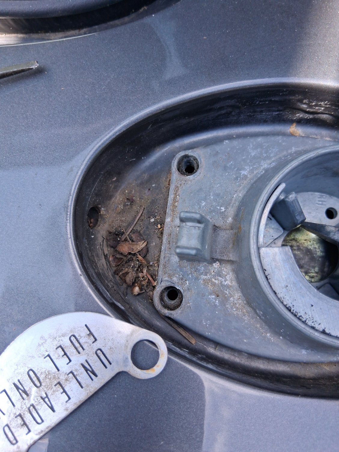

Oh just a tidbit, in case you don't know.
I started cleaning the door sills, door jambs, etc. and of course ended up detailing a lot of small bits around the car.
If you look in your gas filler caps, there is a metal tag held on by two Phillips head screws....I suspected the void would be filled with barn fodder from it's previous few years and was I right!
The drain holes were plugged on both
sides.
