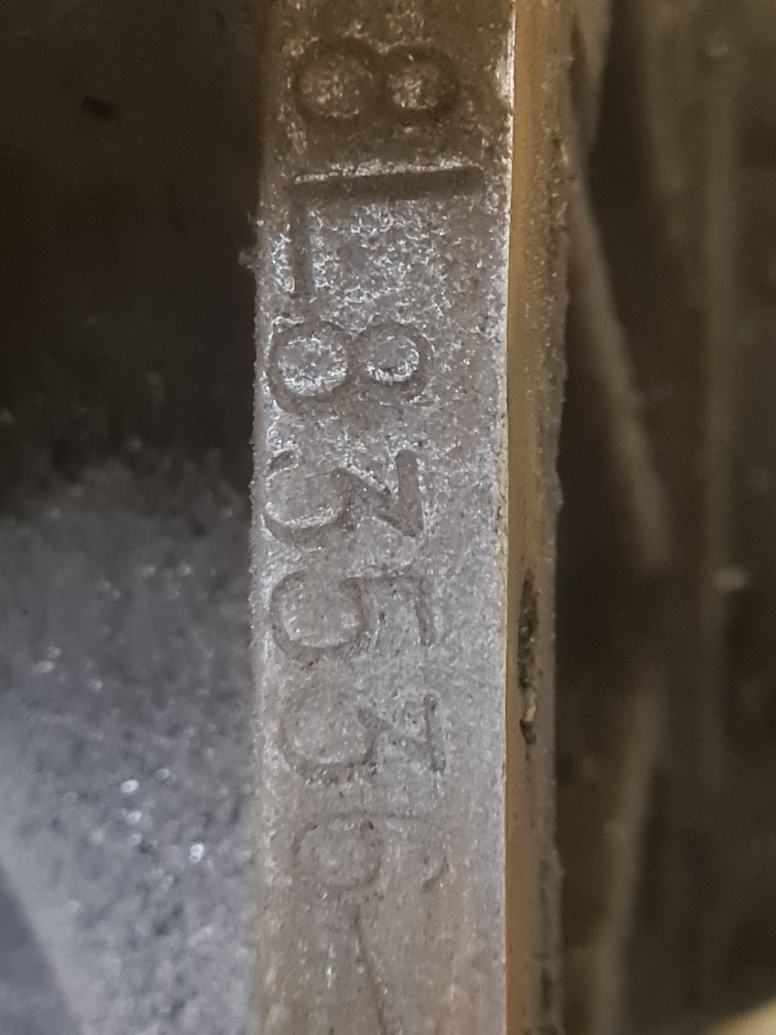

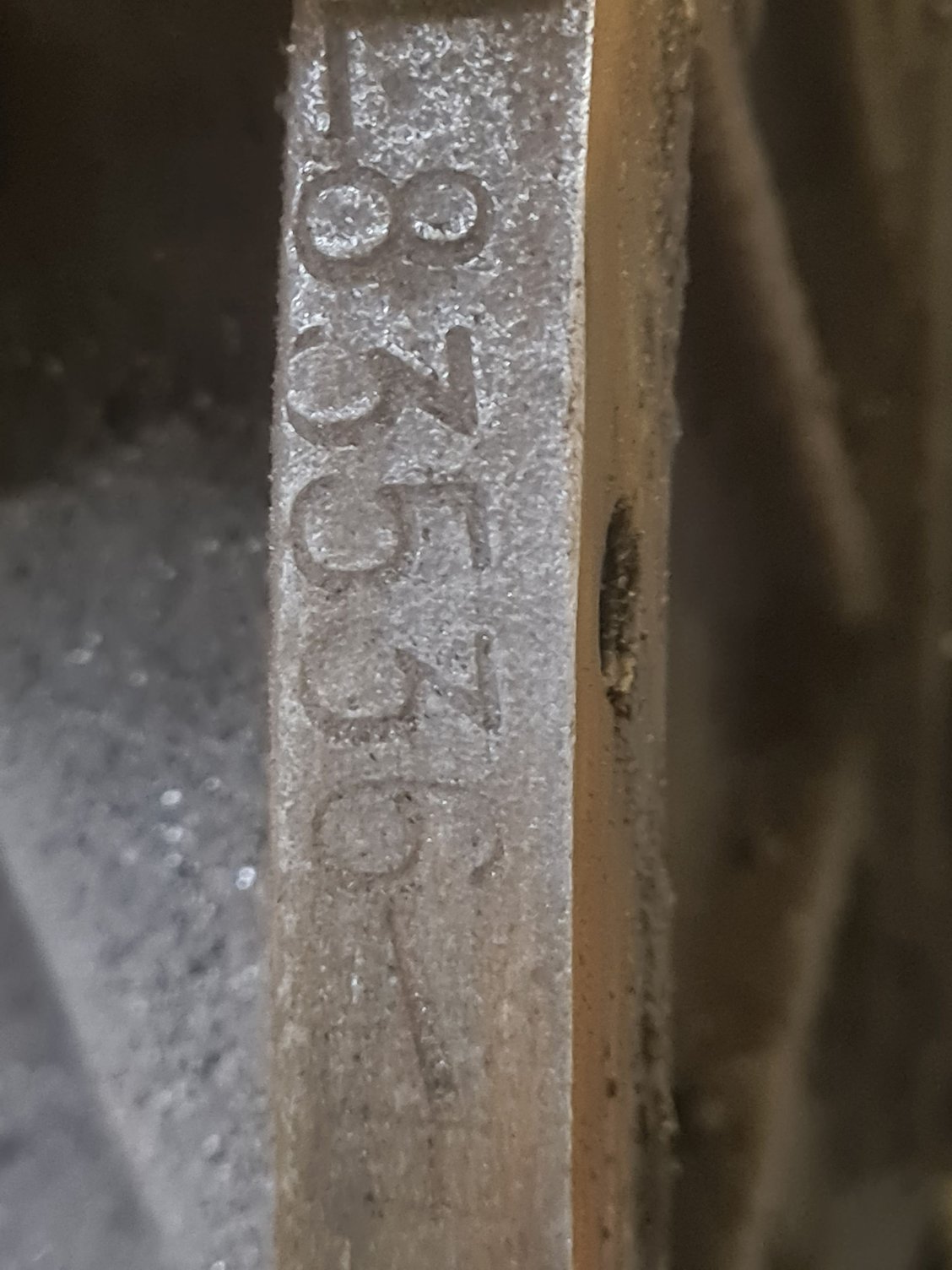

I have a XJ6 S3 m8d 1979 which has 8L8998 then hard to read stamp maybe ebds in 5916-H
Think L long studs, H High compression ratio. The S2 had 7L and
Think engine number of a spare engine is 8L83536-H on a spare engine block. Seller said it was a s3 but have got cyl head off yet and I don't know if it's got the s3 water water slits between the bores.
Anyone know if 8L83536-H is a s3 engine serial code or s2.

8L indicates the later, allegedly stronger block compared to the 7L, but both versions still suffer cracking between the bores, only cured by Jaguar changing the cross-block passages on later engines. These later engines are the so-called "slotted block" engines. This was the last modification to the venerable XK engine because Jaguar were getting ready to introduce the all-aluminiuim AJ6 engine and didn't want to spend money on an engine that was shortly to be taken out of production.

Think mine had 8L988☆☆☆-H (cannot read it fully, maybe due to dirt) but log book lists a different partial code think because engine was reconditioned and maybe block got changed for a sep 79 s3 XJ6 so expect first production s3 in Apr 79 started with 8L but maybe had 5 or 6 digits after the 8L prefix. Bought a spare engine with 8L83536-H but don't know if it's a s2 or s3 yet. Someone told me Jaguar changed water ways in s3 block and put vertical ribs lines on side of block.
Know suffix is for higher compression pistons whereas S was standard. Read somewhere they may have been a L for low compression suffix.. Some of last s2 started with 8L but has SU carbs The starting prefix L for long studs on S2 and S3
on Jag lovers site there is list of engine numbers by car type like very early SS cars and v12 or double six, but it doesnt serm to detail much about S3. One says E type was 7R not 7L so the first two digits seem denote the car type aswell. On one it gave 8L54076 onwards as possibly being S3. Also some talk about S3 being big valve heads. Wish there was a definitive list on the Web.
Hope that helps.

Think from Apr 1979 was ifirst s3
Engine numbers 8L 111640 to 111737 as April
So think your no 8L 147035 H could be a s3.
The s3 block had water slits between bores and water slits and ribs introduced down block and has
Think S2 were built from 1974 to March 1979 s3 from Apr 79.
only way to find out is to take head off.is long studs and prefix H is high compression. Think S3 had bigger valves and shorter piston stroke.
I bought a spare engine which think is a s2 as there are only 5 digits after the 8L so bought by mistake. My xj6 s3 had FI so electronic points
My block had a crack on top of water slit to one bore. Told can get block skimmed and put a Shim say 3mm on top to keep the valve clearance.
