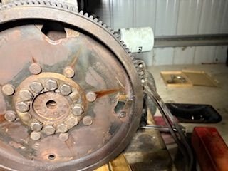

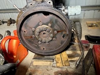

Well we found out the reason for the noisy transmission - it was indeed the flex plate - see the photos
My friend chose the series 2 engine (which turned out to be a 1983 series 3) so we shall now have to drill the end caps for the throttle linkage
The face of the original series 1 measures 35mm from the block, the series 3 plate measures 37mm, so I think bolting the original model 12 to the late block should work.

Not clear in the photos. What did you find wrong with the flexplate?
Thanks, Bill
Thanks, Bill
Look carefully - the mounting holes at 12o'clock and 3 o'clock are torn out. The ones at 6 and 9 are OK

WOW! Wasn't looking in the right place the first time. Give me a refresh - what mounts in those four holes?

Just answered my own question. The Torque Convertor.

50% damaged, yet still had the car running.
Now that's great British engineering for you!
