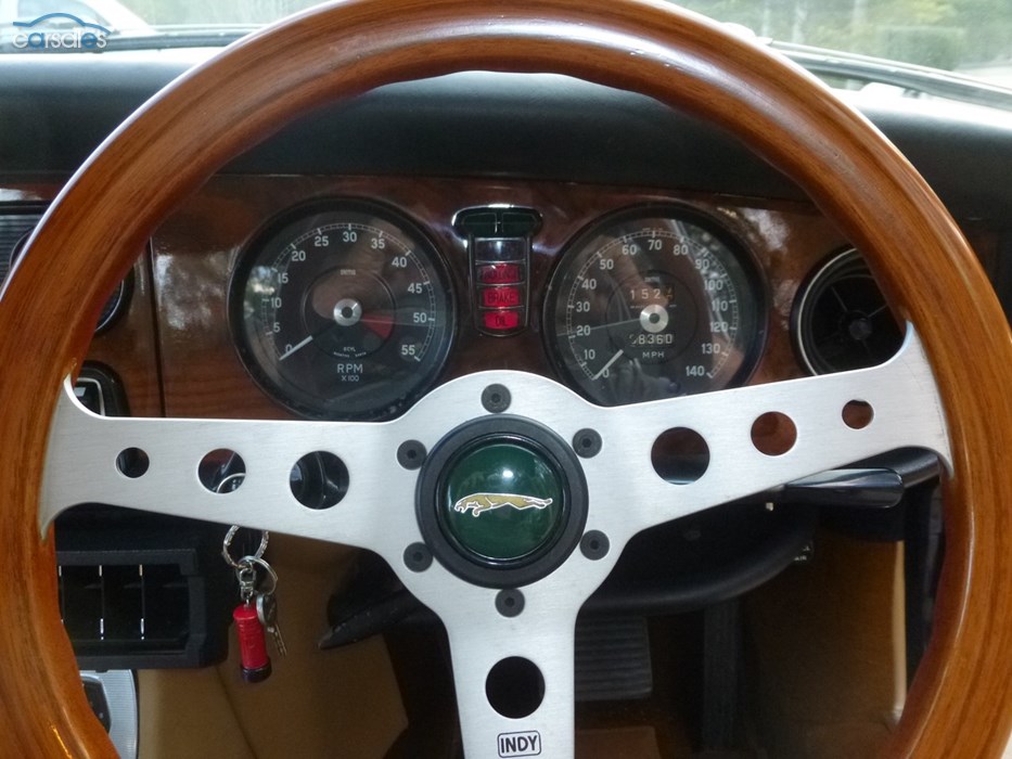

You mention a new AED trans? If the trans has been changed out or the IRS gears... the speed/rpm could be just a "wrong combination". How many gears in the new "trans"?
When the car arrives, put a portable GPS in the car and compare it to the speed on the speedometer... that will get us closer to the truth.
Get under the car safely and check the tag for the ratio on the IRS... 2000-2100
is not totally out of the question. Not sure of the gear ratio on AUS Jags for that era.
My '71 Jag with a 200R OD trans and 2:88 gears (with a tach that has been converted and a speedo that is accurate now with S3 parts) shows 1850 at 65-70 mph... but the '72 Jag with 700R OD trans and 4:09 gears shows 2350 at the same speeds.

I also noticed that the tacho appeared to be registering about 2000-2100 rpm at 60mph so I assume it is not reading correctly.
Cheers, Brendan.
Hi Brendan, just returned from a road test. So while I was out I put my GPS on and sat at 100 km/h (which is 63 mp/h) on my speedo, the tacho was reading a solid 2400 RPM.
I have a 3 speed BW12 Transmission.

Very nice car. As for oddities, not unexpected after decades of service and PO's.
But, the tacho reads engine RPM's. The speedo reads road speed. It matters not, which transmission. Third is direct in any three speed. So, as the early cars had
rather low rear end ratios, your tacho vs speedo reading is within the realm of possible. The fact that both needles read steadily is a good clue as to their health.
