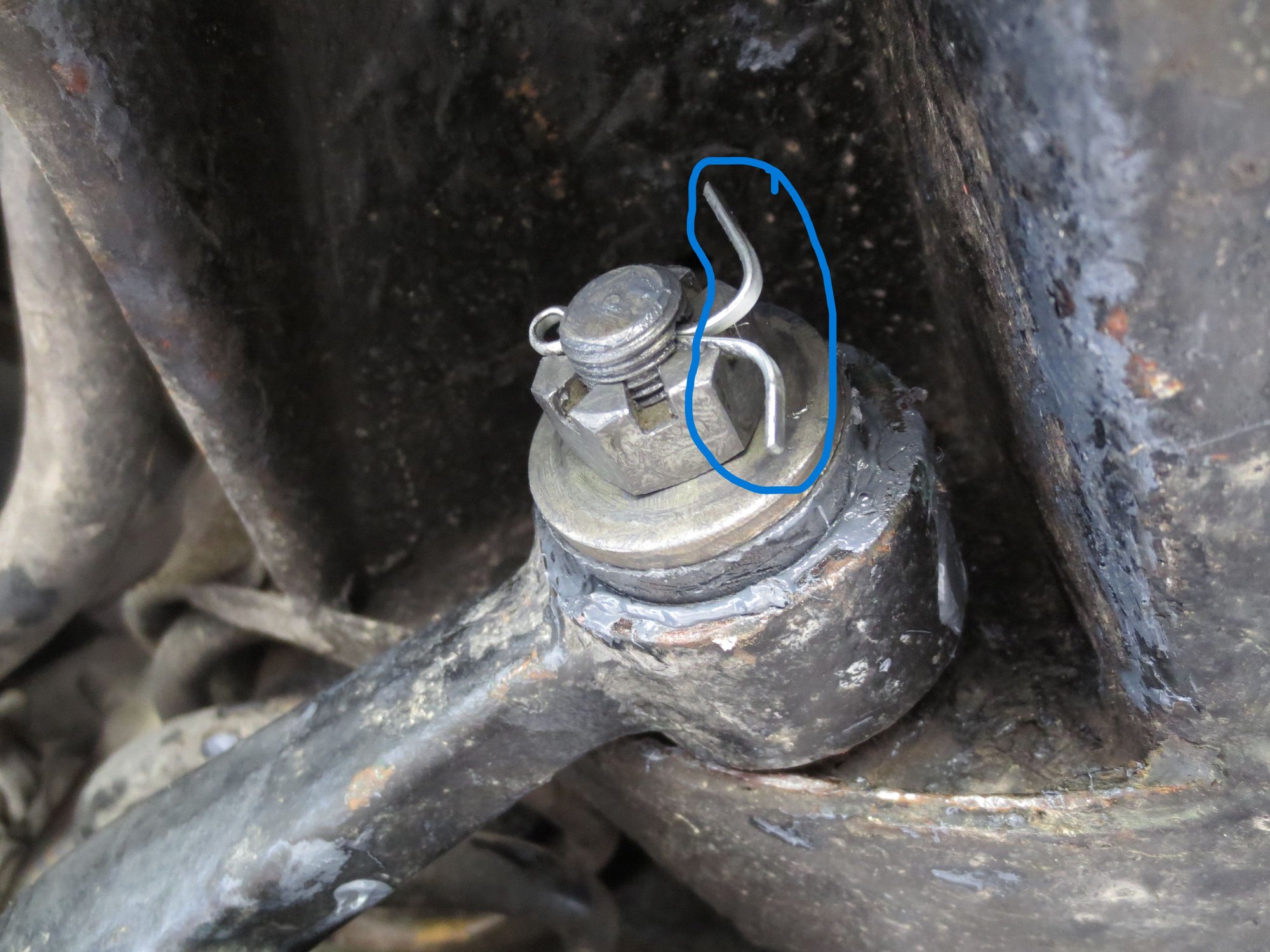

A couple of pics to show you the castellated nuts in place. They have a split pin through them when finally tightended.

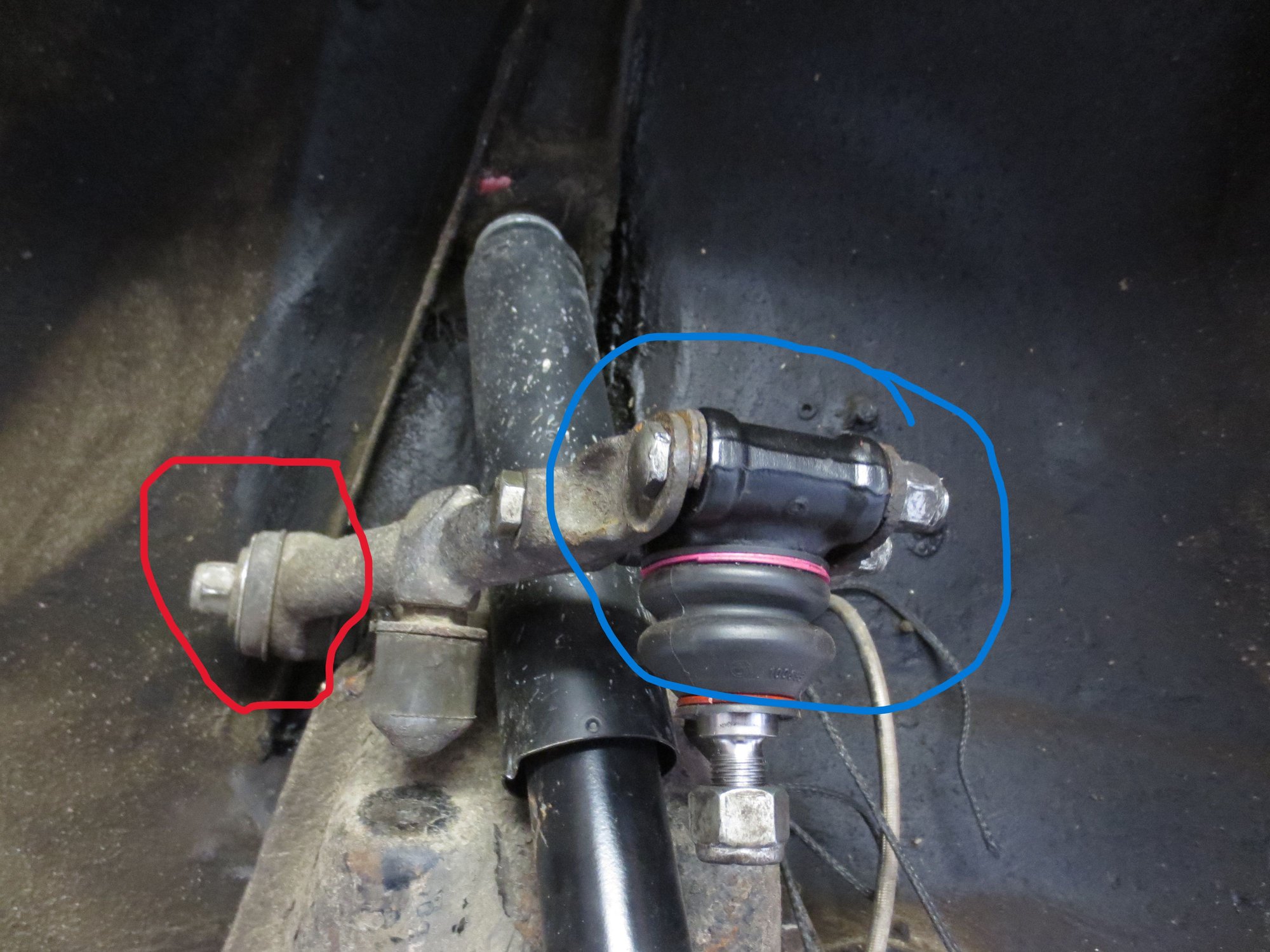

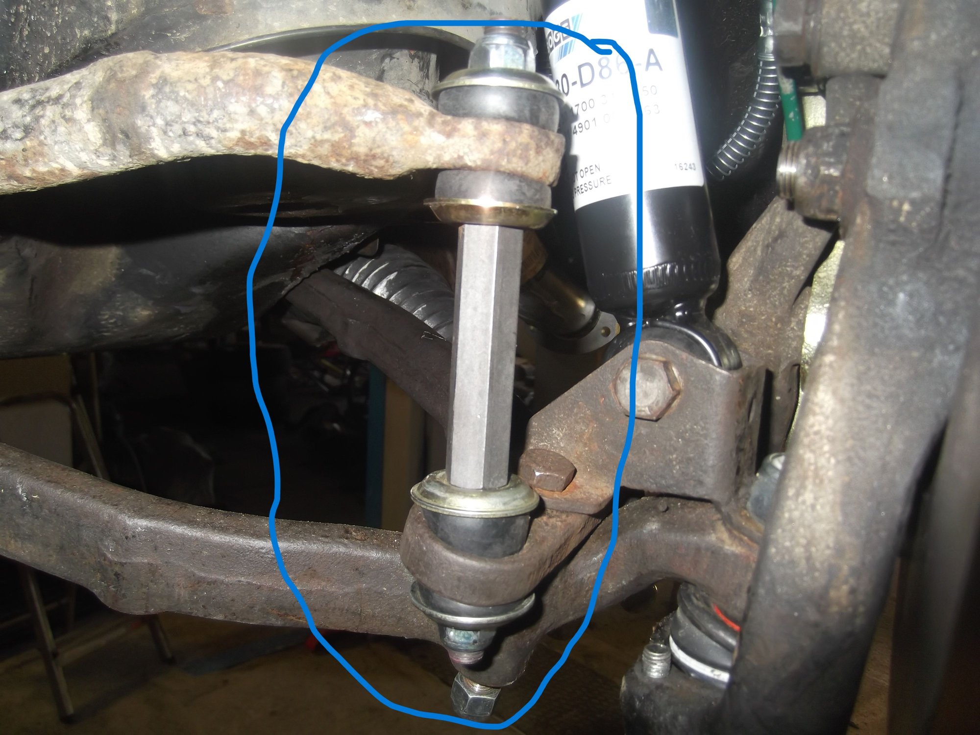

Anti roll bar drop link. The rubbers should be renewed and the metal link if worn

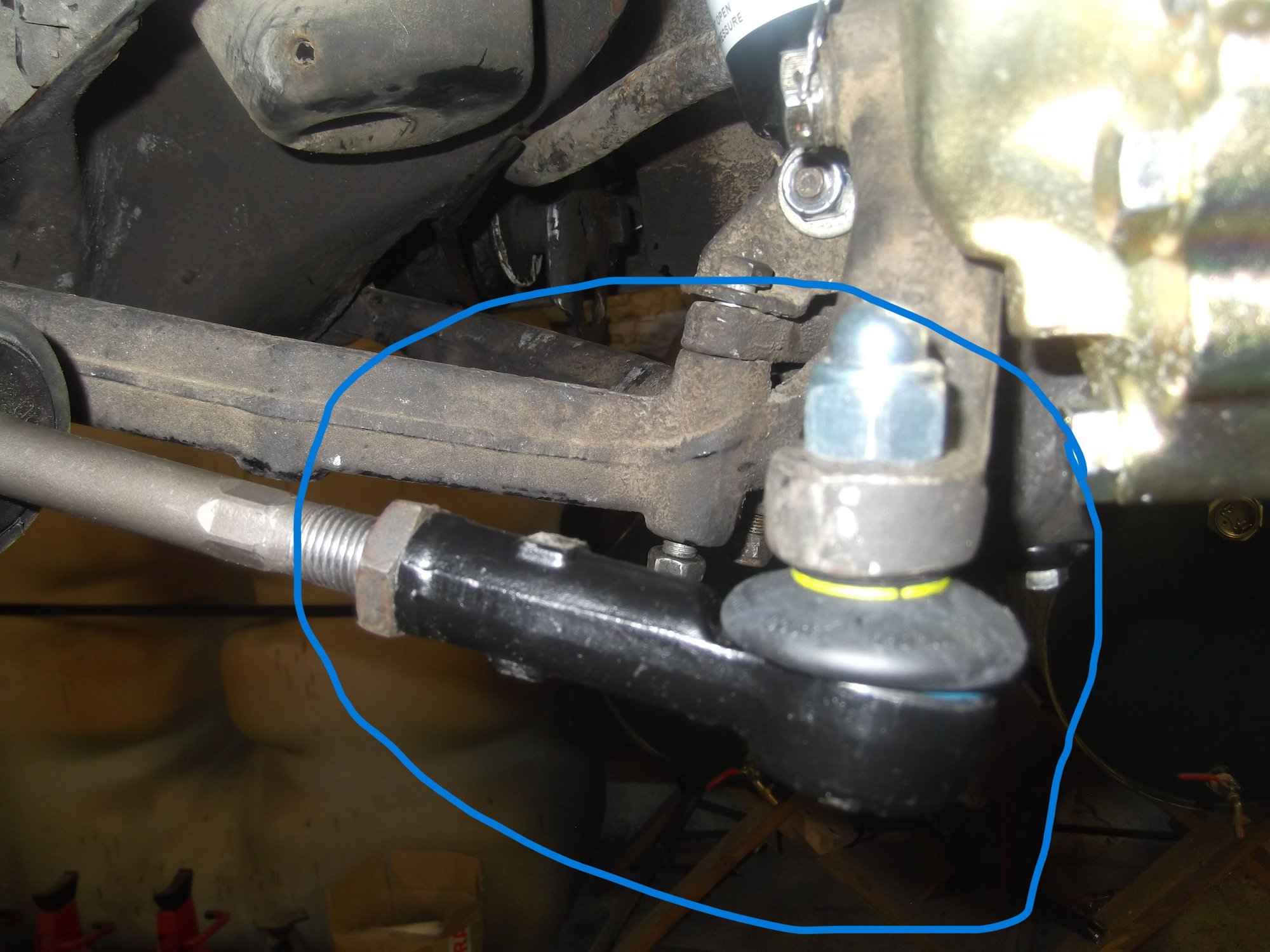

Track rod end. This threads onto the steering rack each end. Your DD6 may well have Imperial threads, rather than metric, you need to check this before ordering

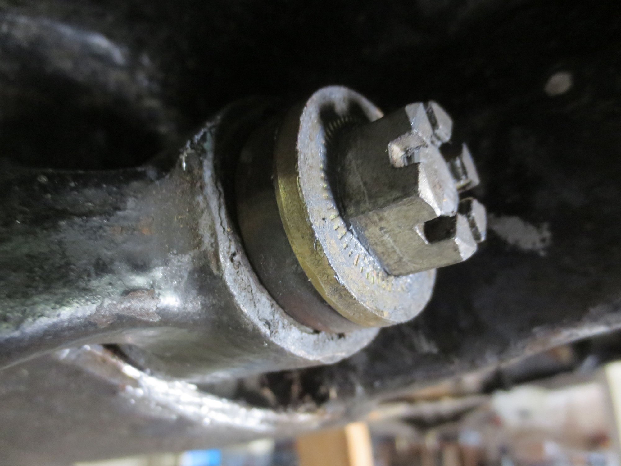

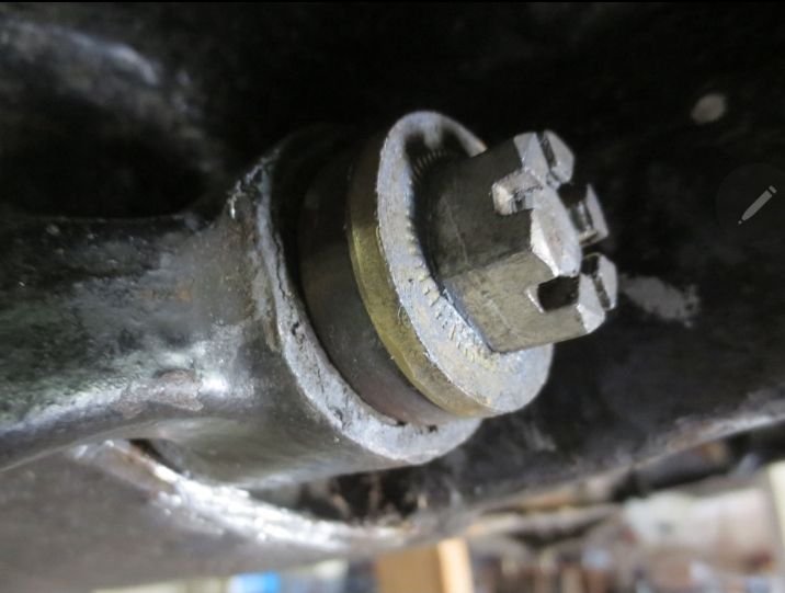

Brown wipe shows the castellated nut and the red ring the other end of the fulcrum pin. Blue stripe shows lower wishbone. Note that the subframe has to be swung down on its front fixing, and the rack removed, to drive out the pin and renew the bushes
Special washer ringed in blue, castellated nut in red. This nut has a split pin through it and through a hole in the pin which is inserted when the suspension is finally tightened. The special washers, as you can see are ridged so that when tightened up the metal interior of the bush cannot rotate. I advise you to buy new pins and special washers as a set, but MAKE SURE the fixed end of the pin (which has a thin hexagonal nut-like fitting on it) is properly welded/attached to the actual pin shaft. I had to weld my set as the attachment was so poor. Do NOT turn the pin using this hexagonal!
The order of things on the pin, starting from the hexagonal rear end is: hexagonal end of pin, special washer, bush (already pre-pressed into the wishbone eye), special washer, subframe, special washer, bush (already pre-pressed into the wishbone eye), special washer (the one with the smaller hole that fits over the threaded part of the pin only), castellated nut.
Note that the ridged side of the special washer, if only one side is ridged, goes against the bush in order to lock onto the metal centre of the bush.

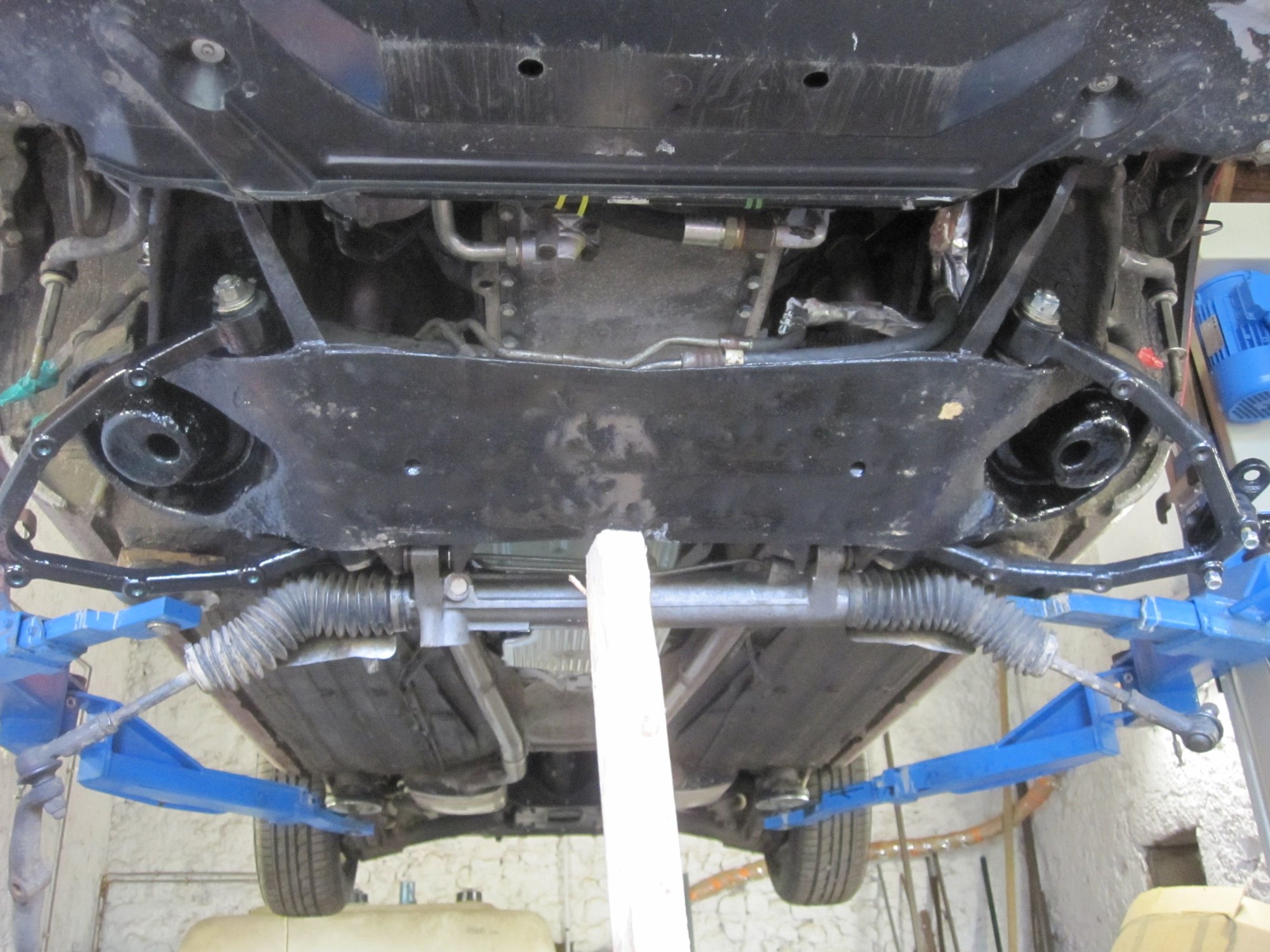

Top ball joint in blue, upper wishbone inner fulcrum bushes in red.
Split pin in place

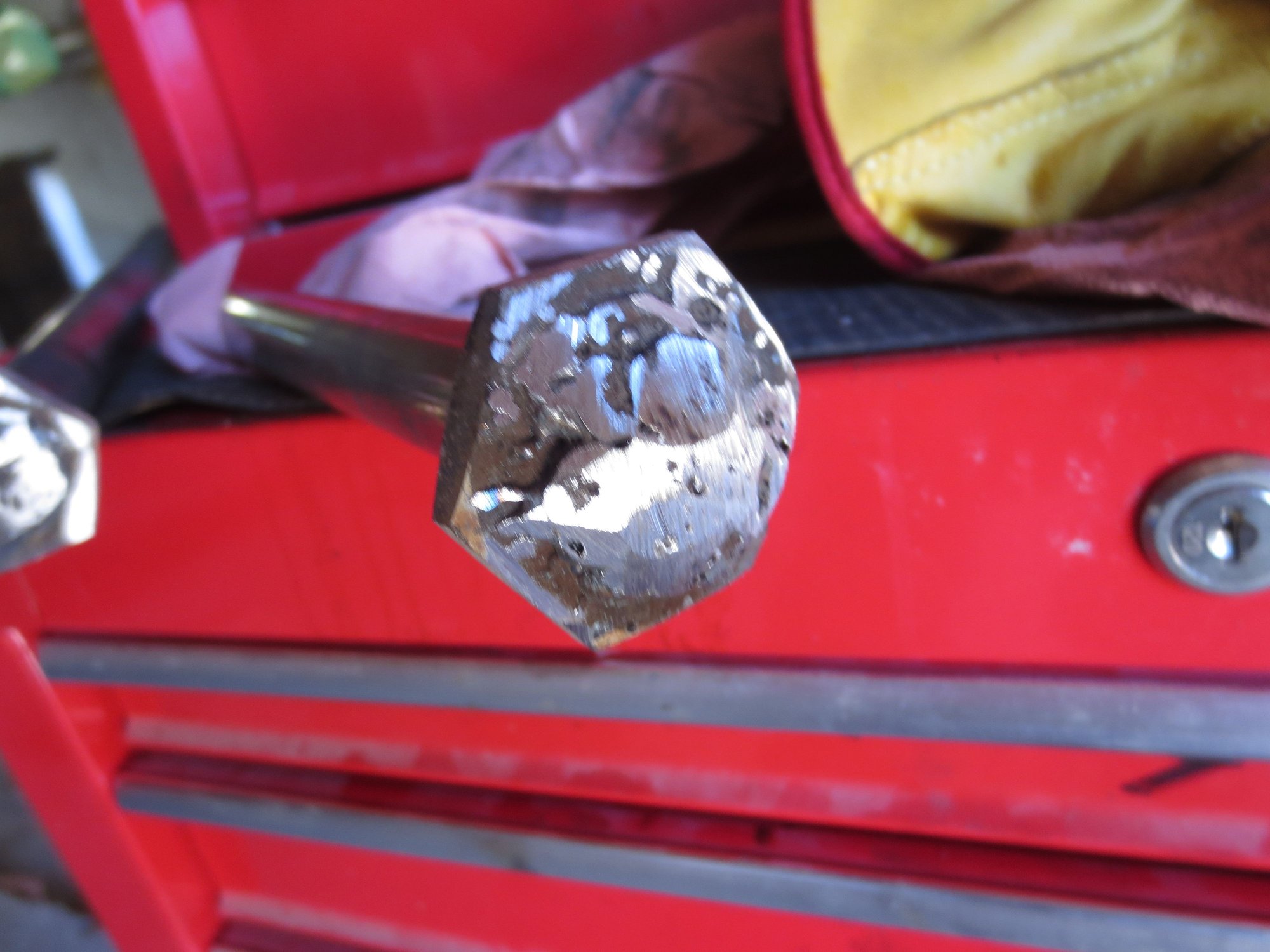

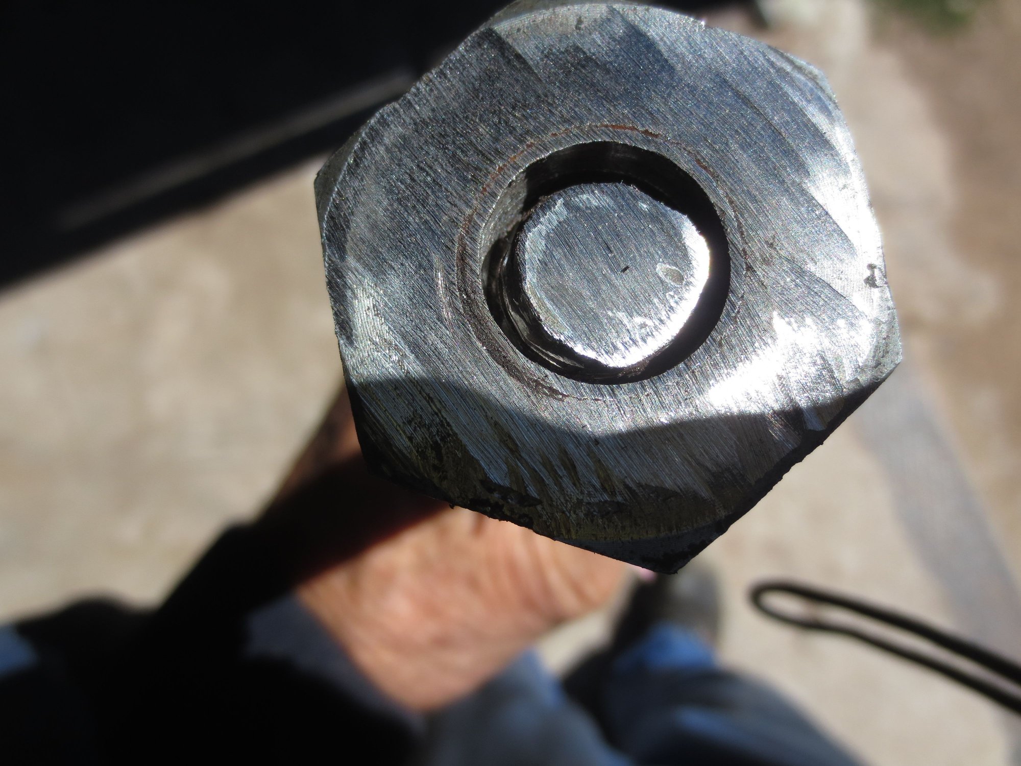

I had to welded the "fixed" end of my new but failed pin (2 in the diagram) :
The list of the order of the bits on the pin might have confused you! What I meant was:
  • You install the bushes in the wishbone eyes (you will probably have to burn out the old ones!)
  • when you thread the pin into the wishbone arm and the subframe, first you put one of the special washers on the pin, then
  • put the wishbone in place with its bushes on it
  • push the pin through the rear wishbone eye
  • then put the next special washer on the pin so the bush has one each side
  • then push the pin through the subframe
  • then put on the next special washer
  • the push the pin through the front wishbone eye
  • then put the final smaller hole diameter special washer on the pin
  • then the castellated nut.
The hole through the subframe MUST be slathered in copper grease so as to aid pin removal if ever needed!
When I did my car's front suspension it was absolutely IMPOSSIBLE to drive out the old pin from the subframe/wishbone. One reason for this is that the rubber bushes soak up the shock of the lump hammer's blows. Yours may not be as bad, but if it is, tell the guy to carefullly cut the pin each side of the subframe. Then the wishbone drops off and the bit of the pin stuck in the subframe can be driven out. An electric hacksaw blade can JUST get into the gap!

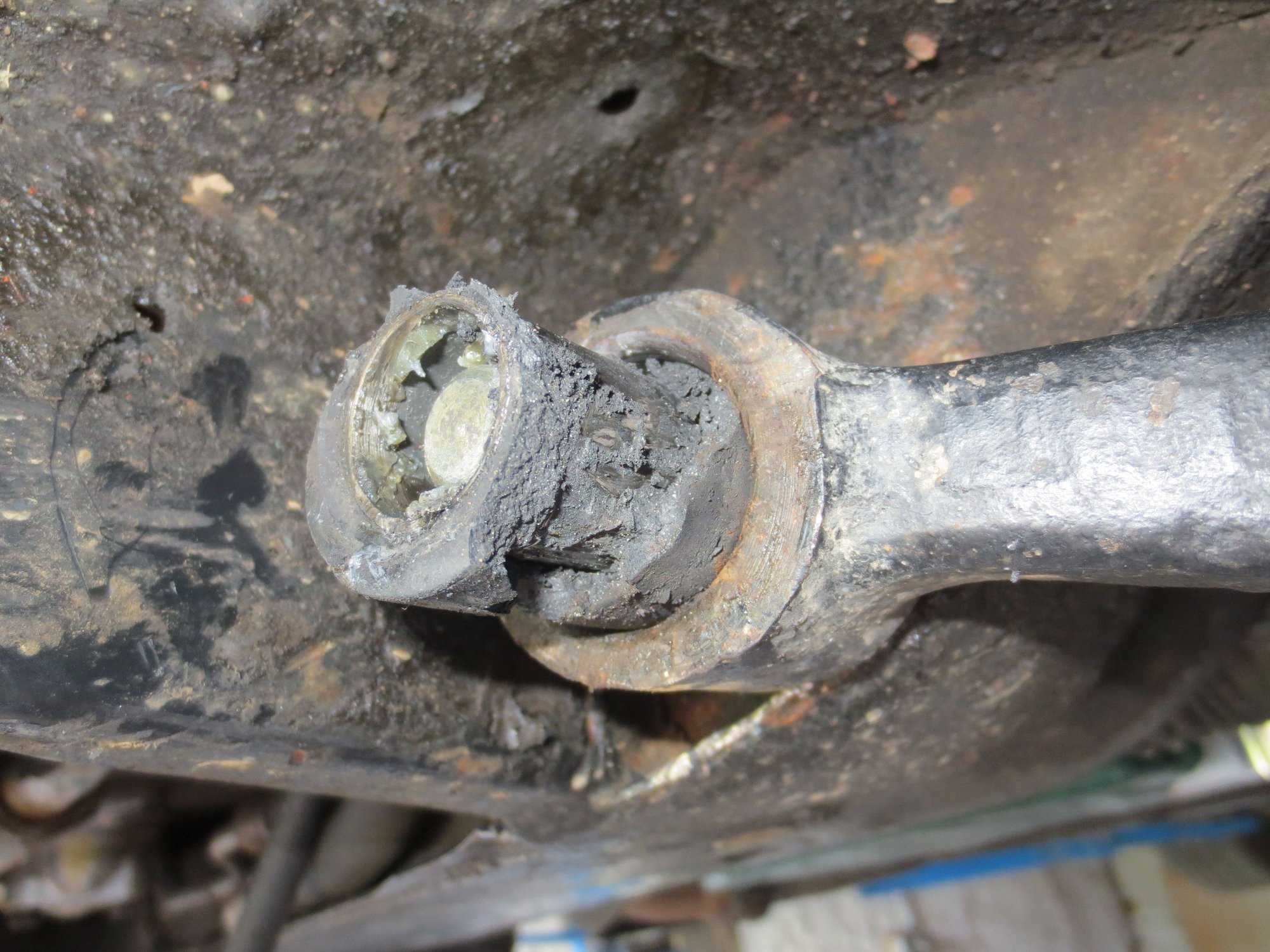

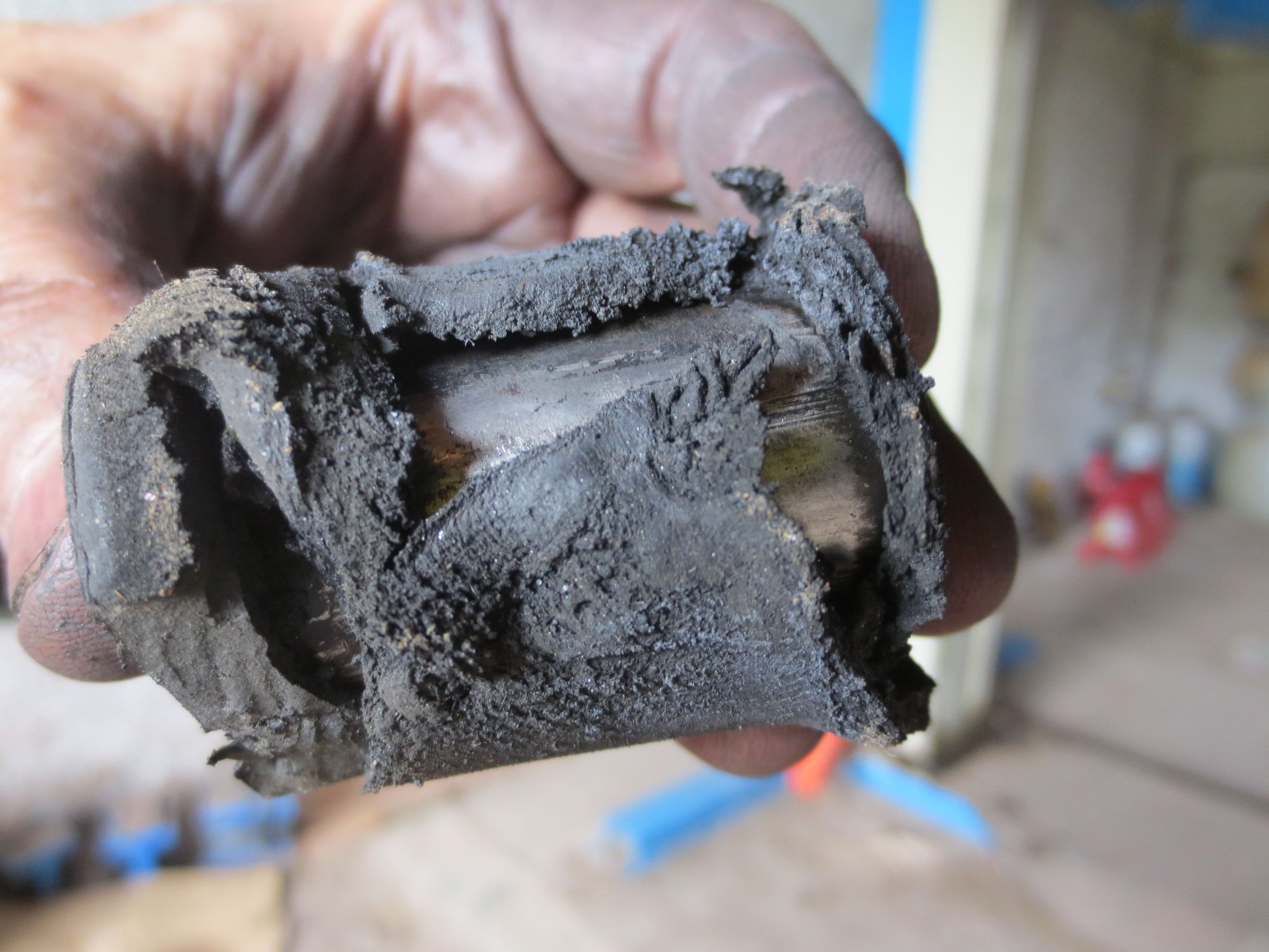

I attach an image of what I understand to be the head that fails and needs to be welded. Did I understand correctly?
I am still a bit confused as to which is the front bolt that needs to find its seat, or needs to settle into its socket, by driving the car before being tightened. Is this below the one?

Both correct. the nut tightens the special washers onto the metal inner of the bush. If this occurs with the wishbone arm at the wrong angle, (ie the car NOT at its normal settled suspensiion point) the bushes will tear.
LnR's point is that after a refurb the suspension will NOT settle to its normal point without a brief run around and a bit of braking to settle the suspension. The nut is in place during this but NOT tightened up. We are just talking of a kilometer or so.
As to welding, the pin you buy might not be poor quality, I am just warning you to look at it to be sure.
