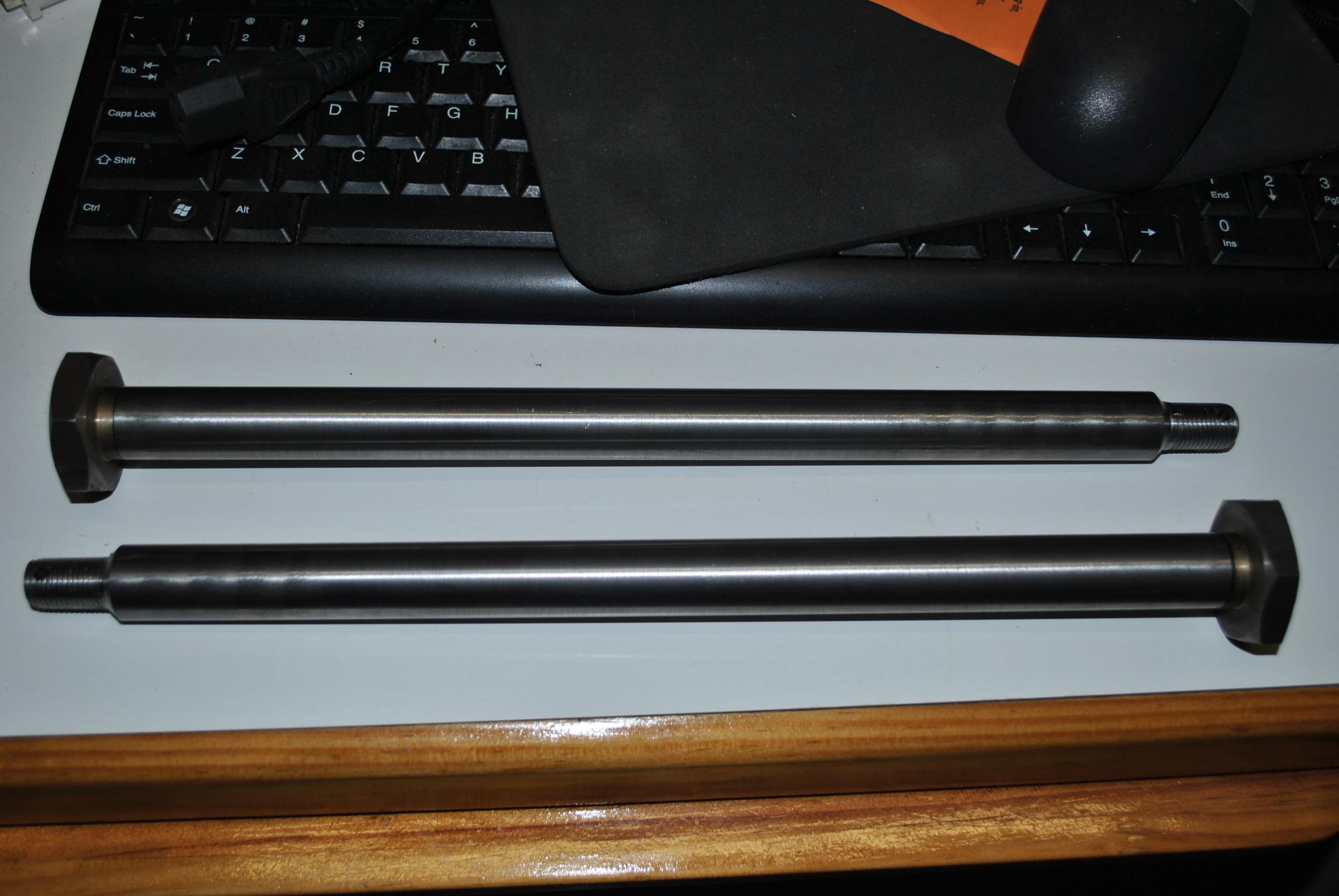

Mine were mushroomed from the beating they took to remove them. I repaired the threads but wasn't happy with them so removed them again when the new ones arrived.
I had a new pair made up locally for $40 each.

one came out with some heat and a couple hits, other one... not so much... lots of heat and took about a 1/4 inch off the threads... found some replacements for 70 bucks each sent everything off to sand blasting and powder coating
