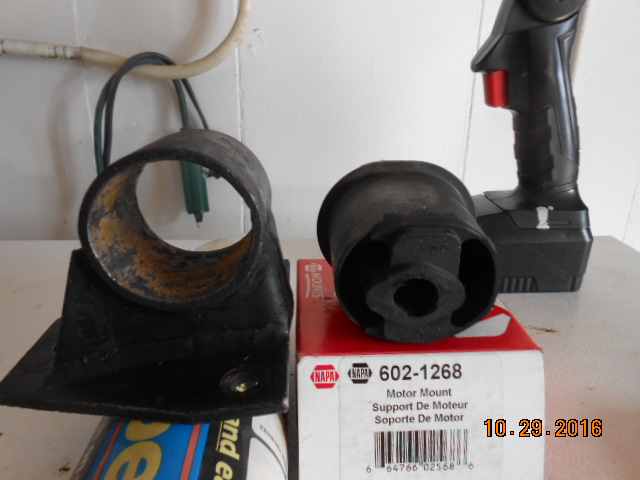

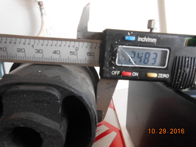

As previously stated, I ordered Napa part number 602-1268 to replace the motor mount inserts on the John's cars kit.
These motor mount inserts are way too big, so now I am stuck.
Apparently, John has not standardized his parts. If it fit Roger's car, it should fit mine.
I am looking at options, without having to purchase a complete kit since a new kit from someone else would change the position of my powertrain.
This would mean driveshaft and exhaust work.
I already f***ed up by burning out the old mount so now I am up on jack stands, with no replacement mount.
Any ideas anyone?

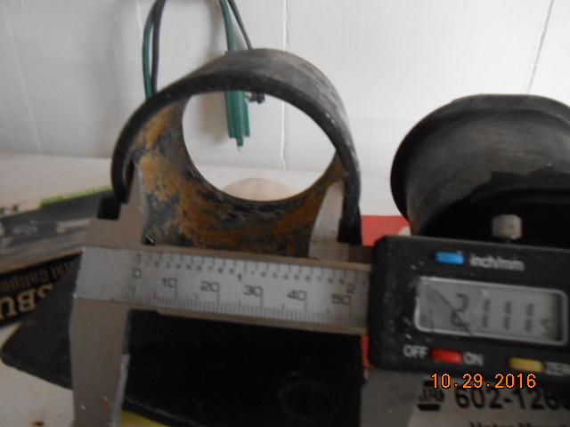

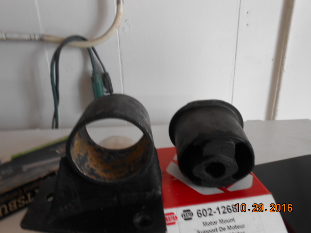

here are some pics of the measurements taken at the widest point of the oval. These mounts do look different from the ones Roger posted.
His had four round holes in the rubber, mine has two spaces. Wrong mount Roger?

1. Too big can be cut down? As opposed to too small. May or may not apply in this circumstance.
2. Visit the junk yard. A car with John's mounts in residence.
3. Wheedle John out of a pair. Cry if necessary. Not a bad guy, merely very protective of his designs. I understand that. But, as a replacement just maybe...
4. Send me some pics and I'll stare at them and see if I can conjure a fix.
5. Search Rockauto for the donor truck part. Roger Id'd it. It may be illustrated.
5. Any old time part places around your digs? Take old and new and see if they real parts guy can come up with something...

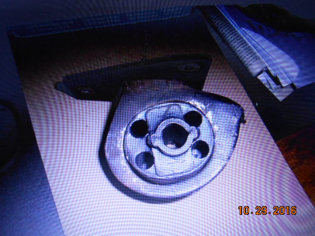

Comparing the photo Roger posted to the one I purchased, I am wondering whether the part number is incorrect, or the part number is correct and I have the wrong part. Anything is possible.
Hours of research for part # 602-1268 comes up with images of the one I purchased. I can't find any Dodge/Plymouth mounts that look like the one Roger got. Looking at the photo that he posted, it looks like the one I removed, four holes in the rubber insert. The other noticeable thing on mine, the rubber insert was molded into the oval part of the mount.
See attached photos.

Only info I still have on the mount repair from the John's Conversion..
Part number is shown in the last photo as Napa - Balkamp 602-1268. This was taken off the original box the part came in...
Good luck.. if I was going to keep the car... I would convert to Suncoast mounts... no matter the work or money involved.
I changed the Mundorf mounts that were in my 1971 when I got it... the best thing I did to the car as the engine went backwards about 1.5" from those mounts.. handles
much better with the weight to the rear more..

On that mount... Why not cut the round bit off and replace it with another length of pipe that fits a currently available insert? Or change to Suncoast mounts.

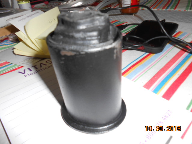

Motor Mount, Chrysler, Dodge, Plymouth, 318, 340, 360, 400, 440 Anchor part # 2369
I located this mount at Autozone at $6.00 each. The insert has the almost correct oval diameter but it is an inch to long.
I purchased 3 of them. 1 for experimental purposes and 2 for the final assembly.
The one for experimental purposes I will cut to size, using the 602-1268 as a template.

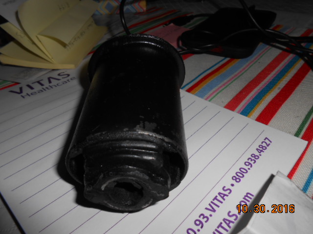

These inserts will need to installed with a hydraulic press. I tried to install one but using a vice as a press, I can only get it in about 3/4 inch. Needs a little bit of work with a file.
SEE ATTACHED PICS.
