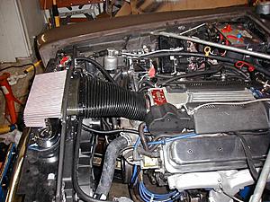

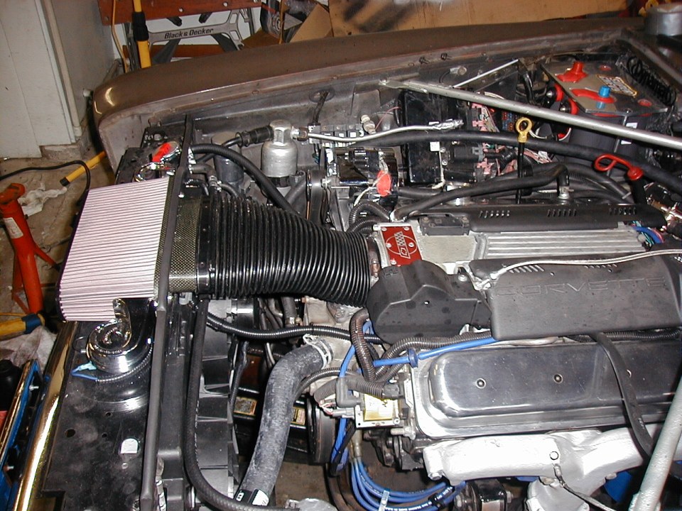

My PCM was mounted to the passenger side fenderwell. The grounds were done per GM...wanted to mount the PCM inside but the wires were too short to put the unit under the passenger seat. I do not remember a plastic connector? Been too many years now.
Attached Thumbnails Fuel injected Lumps - How To-stock-dual-fans-horns-mounted-radiator-support.jpg
