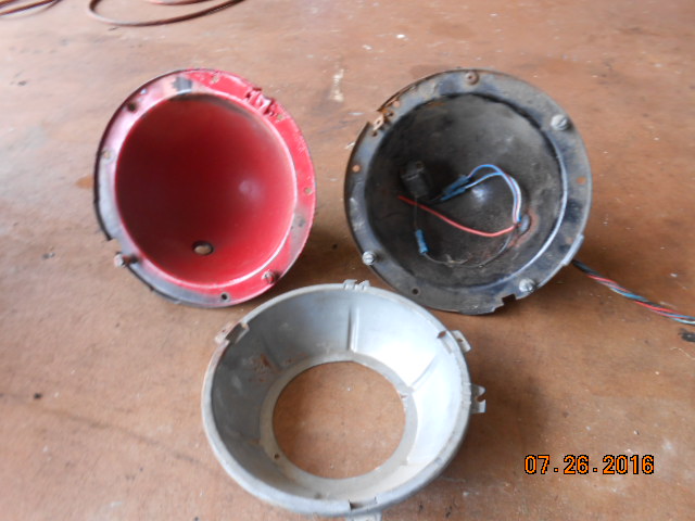

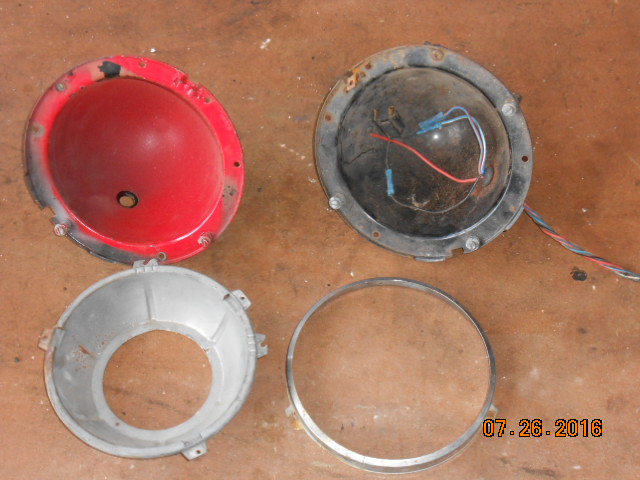

MGBs had two different styles of headlamp buckets. One that had the inside oval smooth as shown in the picture attached and the other that had the oval with an extruded part towards the front of the oval. This is the type I used. However, either one will work.
The buckets are mounted using the same screw holes that hold the adapter plate for the 5 3/4 headlamps
The second piece (the silver piece at the bottom of the picture) attaches to the bucket.
The headlamp trim rings are attached to this piece to affix the headlamp.
I have heard or read that someone on the forum used a dye grinder to open the 5 3/4 headlamp bezel. I have an extra pair and started to mark the opening for cutting but I was fortunate to acquire a pair from England
As for focusing the headlamps, the bottom of the silver piece is held in place with a spring and the angular slots slide into two spring and screws at the top and one side.
You can use the adjusting mechanism from the headlamp unit you are removing, and install them on the MGB buckets. I was missing one and used one from the headlamp assembly I removed. It was impossible for me to remove the headlamp harness as it was snagged somewhere within the fender well. I cut the headlamp socket out, passed the wires through the bucket hole and soldered it back together.
I will remove the bezels on mine and take some pics.
Carl,You can have these buckets if you so desire. They are complete with the adjusting screws and all. You will have to drill a tiny hole in the bucket to attach the spring from the back of the bucket to the tiny hole on the silver piece.

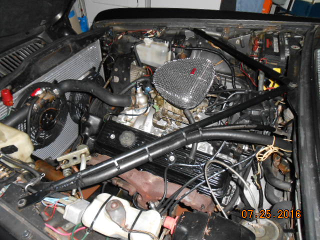

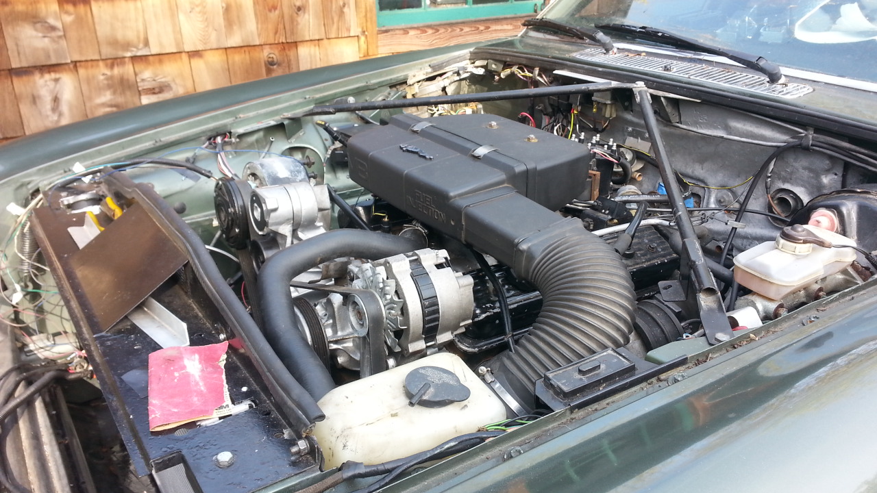

@ Carl; I have all the pieces for the TBI conversion. I just wanted to get all of the other pieces sorted out first before i did the conversion. I have already tested the harness and ECM on my test stand. Now that the engine is installed, I have to lay out the harness, decide where I am putting the ECM then cut the harness to the proper length.
One step at a time. I am looking at adapting a spare Caddy Eldorado air intake box that I have. Cadillac housed their PCM inside the Air Box within the engine compartment. Incoming air kept the PCM cool. Just looking at the different locations for installation.
