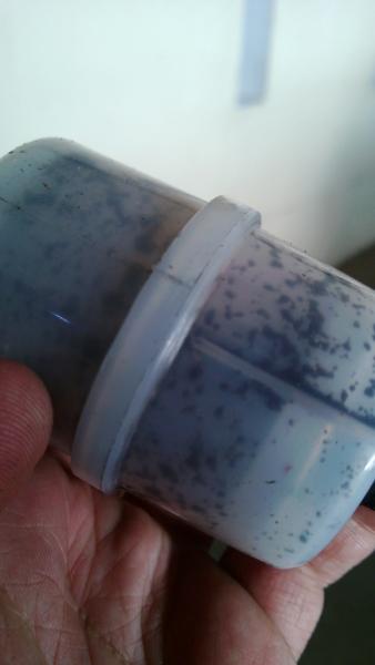

Well it seems I have found my problem... All this time I was checking the pre-pump filter while fitted and I couldn't see any dirt. However, when I removed it.. Look below (that's after blowing a lot of crap out - it was difficult to blow through it). New filter in... Bloody *******.
