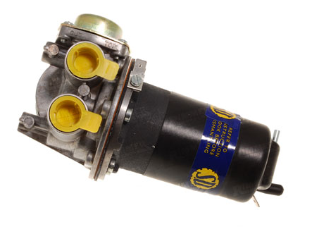

Aha, these look like the pumps that go "tick-a-tick-a-tick and were a common thing here in the UK on all cars with electric pumps. They were once made by SU Fuel Systems, but are now supplied by a company called Burlen Fuel Services, but most Jaguar suppliers sell them. They work via a solenoid that gives the ticking noise.
Fuel Pump - SU - Points type at www.rimmerbros.co.uk
How does this look: -
Attached Thumbnails Fuel Pump Replacement Recommendations-jaguar-fuel-pump.png

That's the pump! The fact that there's two of them still boggles my mind a bit.

Here's the fuel pumps listed by the maker, now Burlen Fuel Systems. YOU will see that there is a repair kit available. Surely worth trying ! I am not sure if they have a US agent, or ship directly. website has lots of info. Jaguar were a user of all their stuff when the SU company made the stuff.
Fuel pumps for AUD 647 for Jaguar 1946 onwards XJ6 4235 cc - SU Carburetters - SU Carburetters
