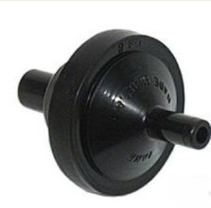

like Doug says, try the Pressure Release Valve first;
it's a black plastic GM valve and it looks like the picture below. Located between two gasoline vapors rubber hoses, themselves attached with clips to the inner fender wheel well; If you follow the "exit" hose (after the valve), it connects to the Charcoal Canister, which itself is located in the front fender wheel well behind the passenger side headlamp.
remove the valve and pierce the membrane inside pushing a 1/8" drill bit through it and pulling the bit from the other side; This has been a known issue with these cars since the 1980's and the fix is to either pierce the valve or remove it entirely by installing a hose-to-hose splicer. Notice that the valve fits the hoses one way only, one side has a bigger hose than the other. The problem is the valve's calibration, it requires too much pressure to open, so replacing the valve does NOT fix the problem.
you will have to raise the front passenger side of the car to see the valve.

there should not be any liquid fuel running through the vapor line from the fuel tanks.
the problem is obviously elsewhere, the piercing of the pressure release valve does not cause liquid fuel to come into the vapor line, it just allows the vapor pressure to be released and eliminates the vapor buildup that was expanding and contracting the tanks. One problem is already resolved, now we have to find out whiat is causing liquid fuel to travel to the vapor release line.
