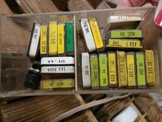

As husband is a World Class Hoarder, he had a Stash of these fuses in various amperages.
I'll have fuses for quite a while it it's still blowing them, until I discover the problem.
