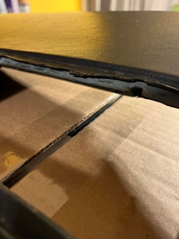

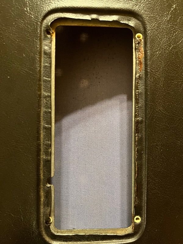

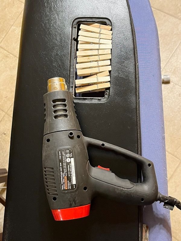

I assume, I am new to the XJ series cars, that the curled-up vinyl around the defrost vent holes in the dash is a common problem? I didn't like how it prevented the vent covers from sitting flat. Solution, a delicate application with a heat gun set on low and clothespins used to hold down the edges until they cooled in place. Once cooled a bit of two-part epoxy will help ensure they don't curl up in the future.

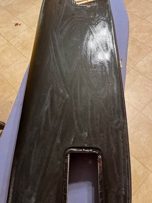

I am also a big fan of 303 Protectant. I have used it on all my cars and have great success with it. I gave the dash pad a liberal coating of it and let it soak in. l am not sure if it soaks in enough to "soften" the vinyl but is a much better product than Armor All.

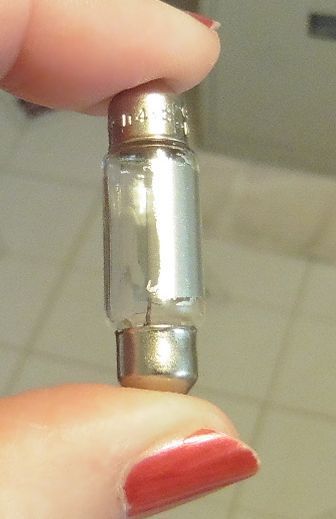

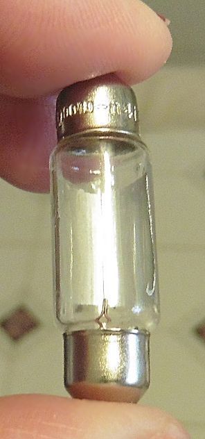

I Very Carefully painted the back of all 3 bulbs, Pillar lights and map light, with Chrome paint.
I masked the ends of the festoon bulbs to prevent short circuis.
The difference, especially with the Pillar lights was Amazing!
However, as mentioned, these are HOT lights. With all the heat/light being reflected out, the pillar lenses are greatly subject to damage from leaving the door open for example.

I tried LEDs in the pillar lights and was Massively disappointed.
First off, the natural color of LEDs is a green tinge, which is Terrible for the tan/beige interior of my Jag. Not only that, they were much more dim than I wanted (way beyond Mood Lighting), as sometimes I need to see what I'm doing and there was No Way with these puny lights.
Which is why I regressed to OEM Festoon bulbs.

The bulb out indicator and turn signal flasher both rely on the resistance of the filament in an incandescent bulb, LED's have virtually zero resistance. This makes the bulb-out indicator think the bulb's burned out and doesn't give the turn signal flasher enough on/off time to operate the turn signals properly.
Elinor, I found LED festoon bulbs and they are much brighter than the originals and the color doesn't conflict with my Biscuit interior. I can see if I can find the part #, but I bought almost all of my exterior/interior LED's from Classic Car Leds in the UK, shipping was cheaper than anywhere in the US and they have any bulb ever made (probably).

I also bought from Classic Car LEDs and can highly recommend them. I've replaced pretty much every interior bulb, including the instrument lights. Finally, I can see the instruments properly in the dark and the pillar lights properly illuminate the interior with the added benefit that the delicate pillar light glass doesn't get hot and brittle. Downside is that the rheostat doesn't work but the panel lights are still not that bright that I'd want to dim them. I'm particularly pleased with the impact of changing the bulb in the Opticell unit - the heater controls and light and ignition controls are now also nicely lit. Finally, glovebox and boot/trunk both also benefitted from LED, especially once I'd added a second light in the boot.

BA9S BRIGHT WHITE 200 LUMEN T4W 233 LED SIDELIGHT UPGRADE BULB LLB233 LLB989
Pillar Festoons:
WARM WHITE INTERIOR COURTESY / NUMBER PLATE LED BULB GLB239 GLB256 C5W 35 - 37 MM 12 VOLT FESTOON
For the Pillar I also tried this one which I used for the map light but preferred the Warm White:
INTERIOR COURTESY / NUMBER PLATE LED BULB GLB239 GLB254 C5W 35 - 37 MM 12 VOLT FESTOON
