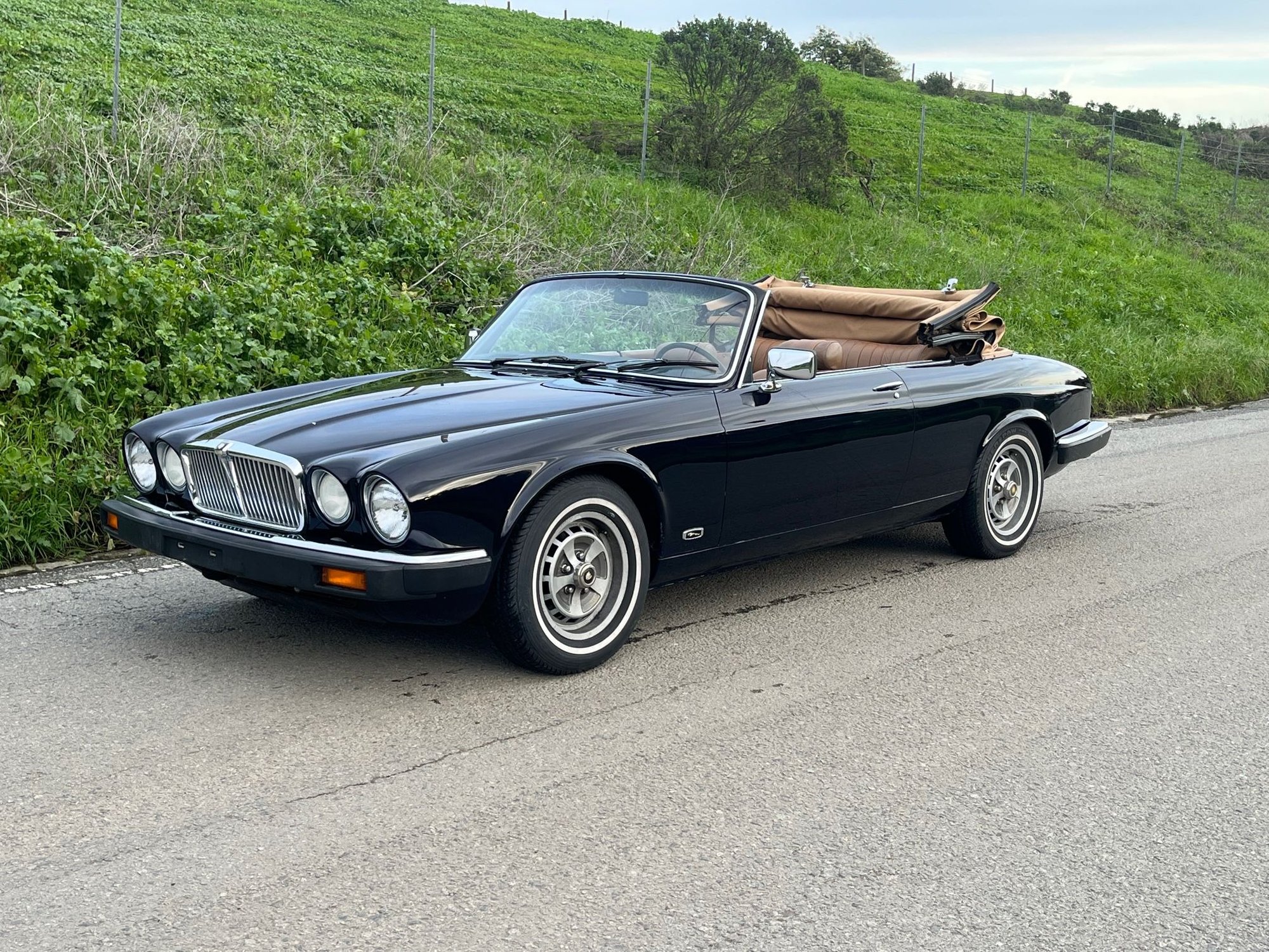

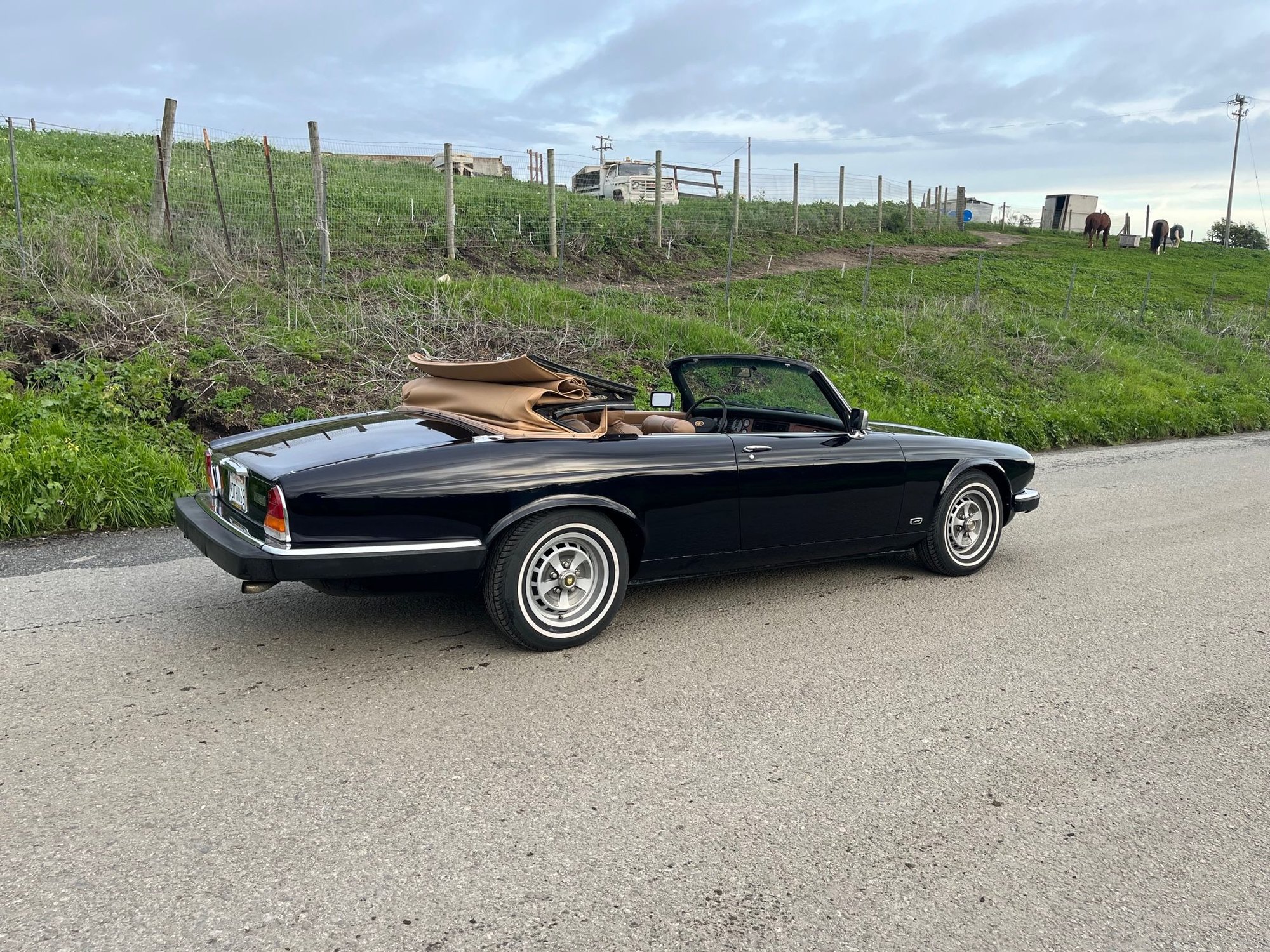

I have attached a few pictures of the car to satisfy curiousity.

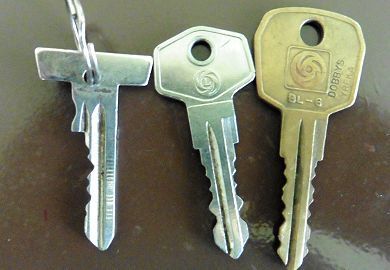

These are the keys I got with my Series 2.
Left key is what's left of Nix's original ignition key, which had a rubber nonsense that perished.
I had several copies made with Solid heads.
Center is trunk/glove box key
Right is gas cap/passenger door key.
