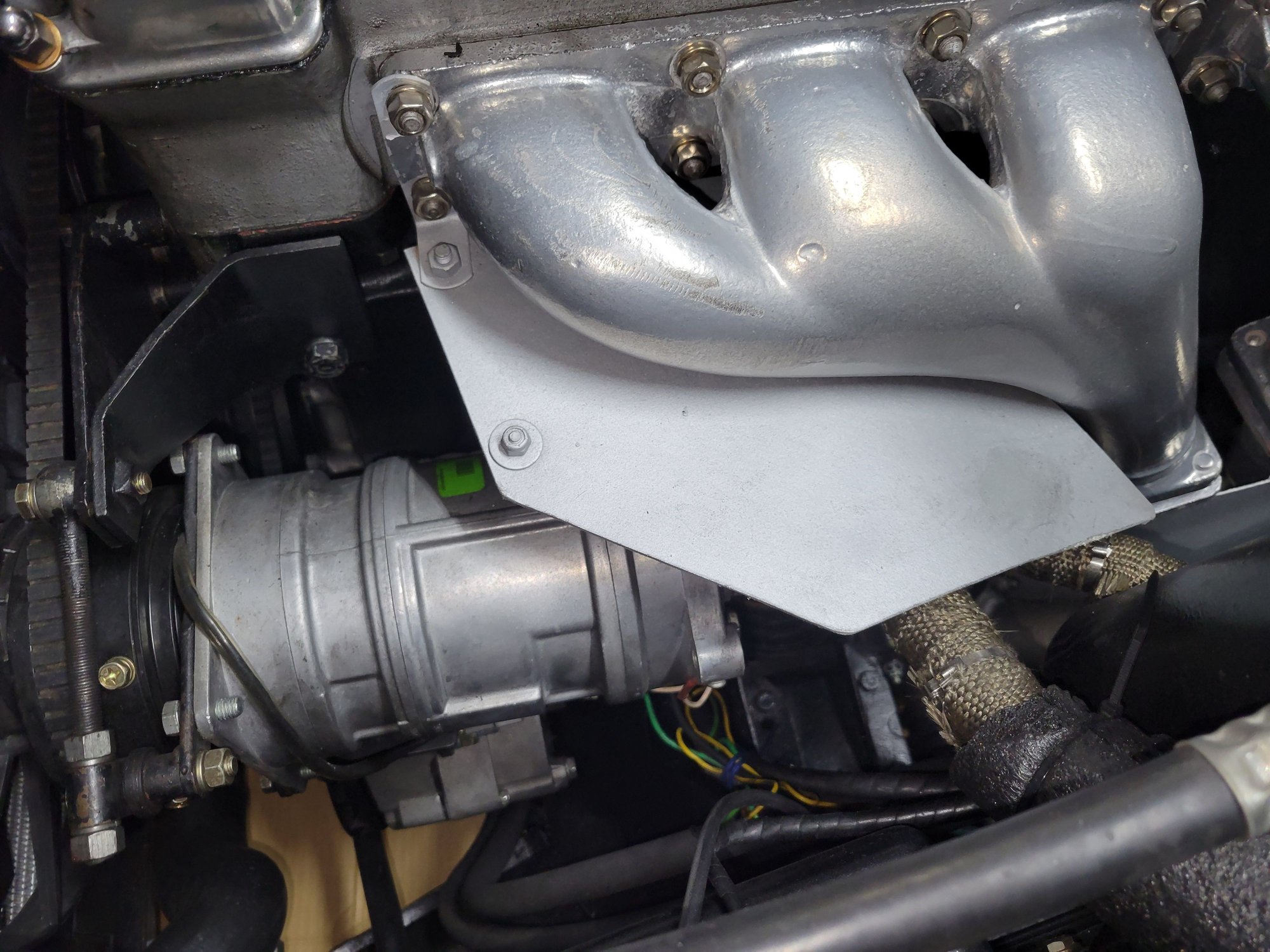

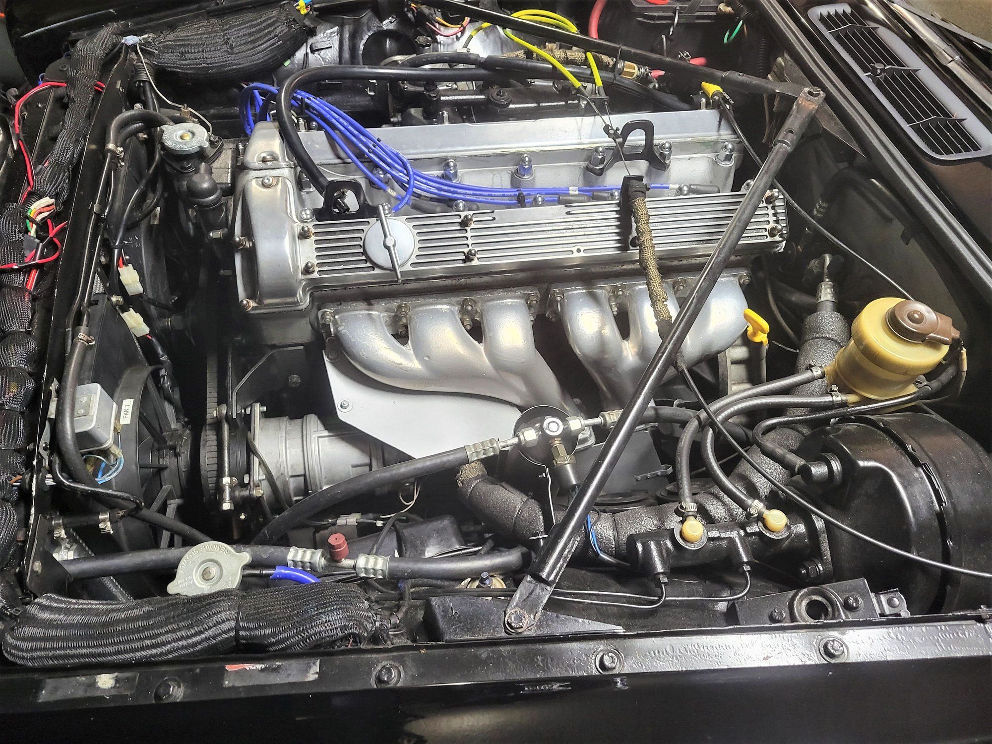

I think the heat shield on my 1975 Series II was the same? And I removed it. However,
I did fabricate an exhaust gasket and painted it silver to shield the A/C compressor just because I thought it needed it. And wrapped the A/C lines with heat shield tape. See pic.

your engine bay looks tidy. Hopefully mine will look as good some day.
So you have not experienced any problems with excessive heat to the bonnet (engine hood) such as paint or colour changes or any damage to the bonnet lining ?.

Don - I've not experienced any heat deterioration to the hood or its liner. And I live in Florida. I neglected to mention I also had Palm City Powder Coating do a Ceramic Coating on the exhaust manifolds and the "Y" downpipe. That's supposed to help keep the heat inside the manifolds.
Bill
