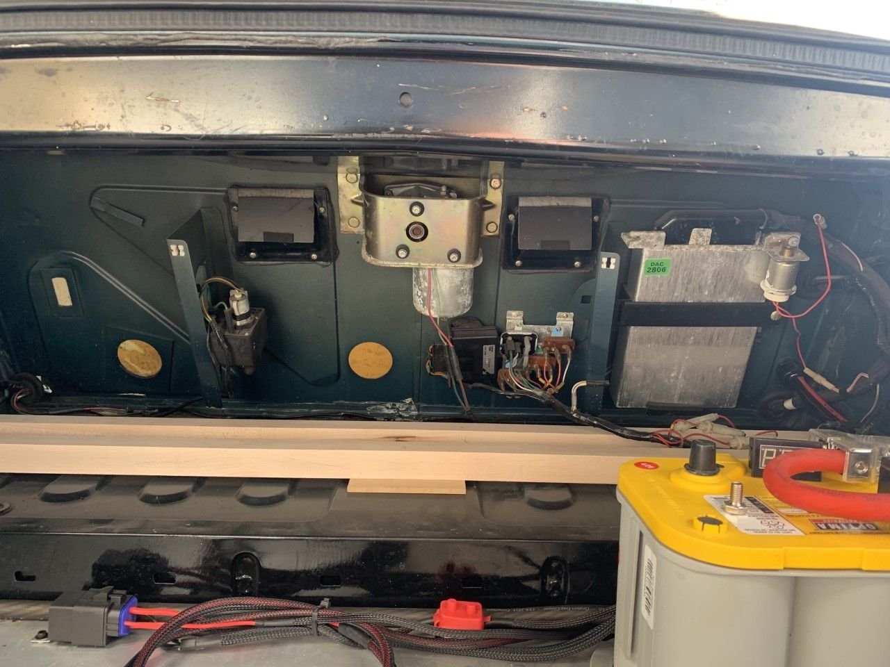

Hey Guys, looking for a little help identifying the components on the rear wall of the trunk and their purpose. I'm looking to relocate to free up space.

extreme right is the engine CPU.
gold cylinder attached to the CPU is an altitude sensor.
to the left of CPU above is a vent for the interior.
below the vent is the array of bulb failure sensors
at the center is the sunroof motor.
left of sunroof motor is another vent for the interior air.
extreme left is the O2 Sensor miles counter and dash warning light switch.
Can't remember what that other box is under the sunroof motor.

Thank You Jose! Is there any reason someone couldn't move everything out of the way? Possibly on the other side?
Looks like the Fuel Interface Unit for the trip computer
You're stuck with the sunroof motor location but I see no reason the other stuff couldn't be moved

yes, the only reason would be the sunroof motor and extending the wiring for everything else would be a nightmare wire by wire.
Still, you wouldn't get much extra space, maybe 2.5 inches in depth?

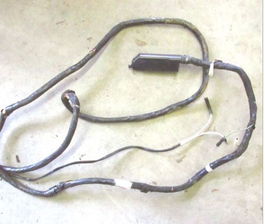

So as far as moving everything... I got a chance to ride in a converted XJ years ago, and the ECU for the LT1 had been moved into the passenger seat compartment. That would be doable in the Series 3, as that big harness that goes to the back for the ECU pretty much is only for the ECU...
Everything else on the rear bulkhead is on a single harness that splits under the seat and goes to either side of the rear of the car... (including the fuel pump, aerial, and rear lights....) I think that harness could pretty easily be split to shorten it where ever it is needed...
The problems would be the things already mentioned... The sunroof motor, and the covers for the cabin vents.... But it would be a ton of work for just a little gain for sure...

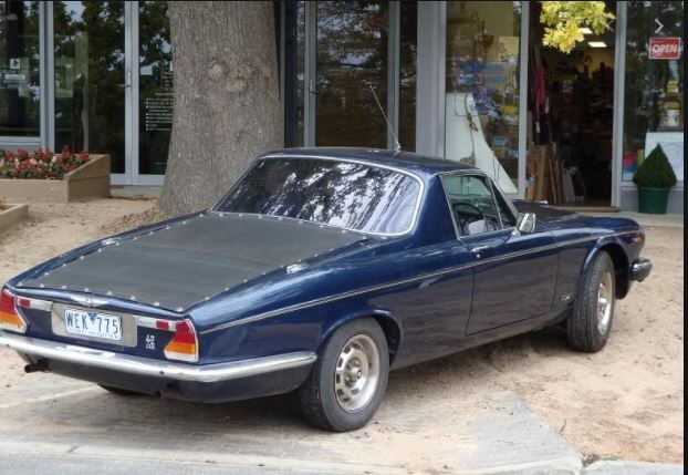

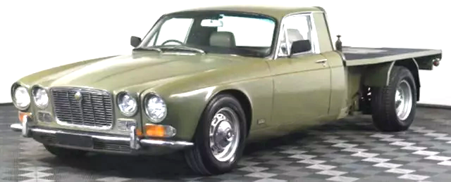

I think it was elswhere, but I did see a cargo carry enhanced XJ. But, a flat bed ! A long one. From just behind the b ost and way back and fat on each side. One could haul many bales of hay on it!!!
Old Feb 6, 2021 | 02:43 PM
con244's Avatar
Joined: Apr 2018
Posts: 68
Likes: 15
Here you go, this one's for sale here in Australia.
Carry lots of anything you want!
