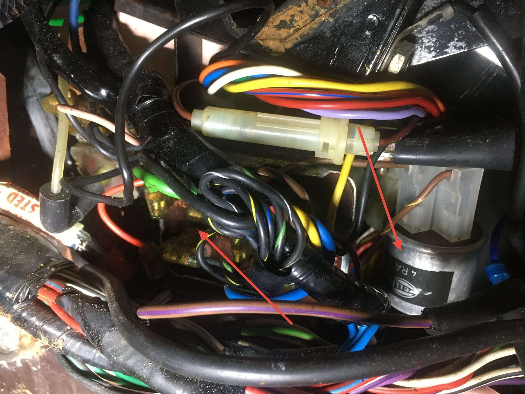

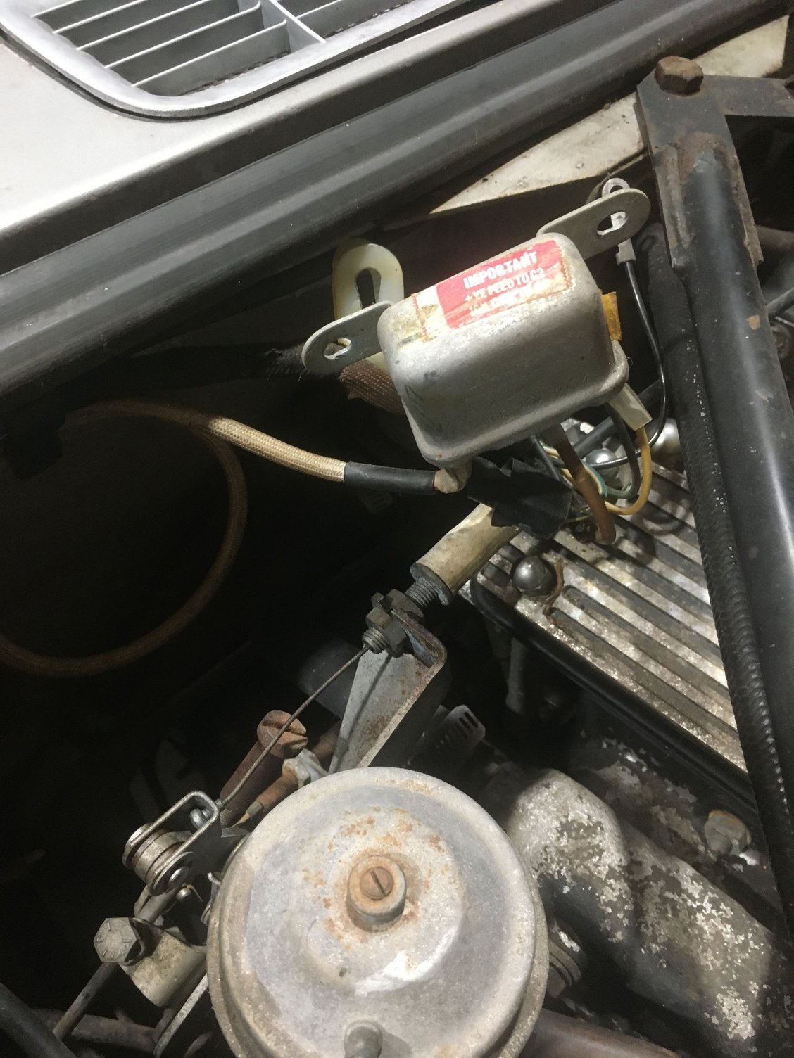

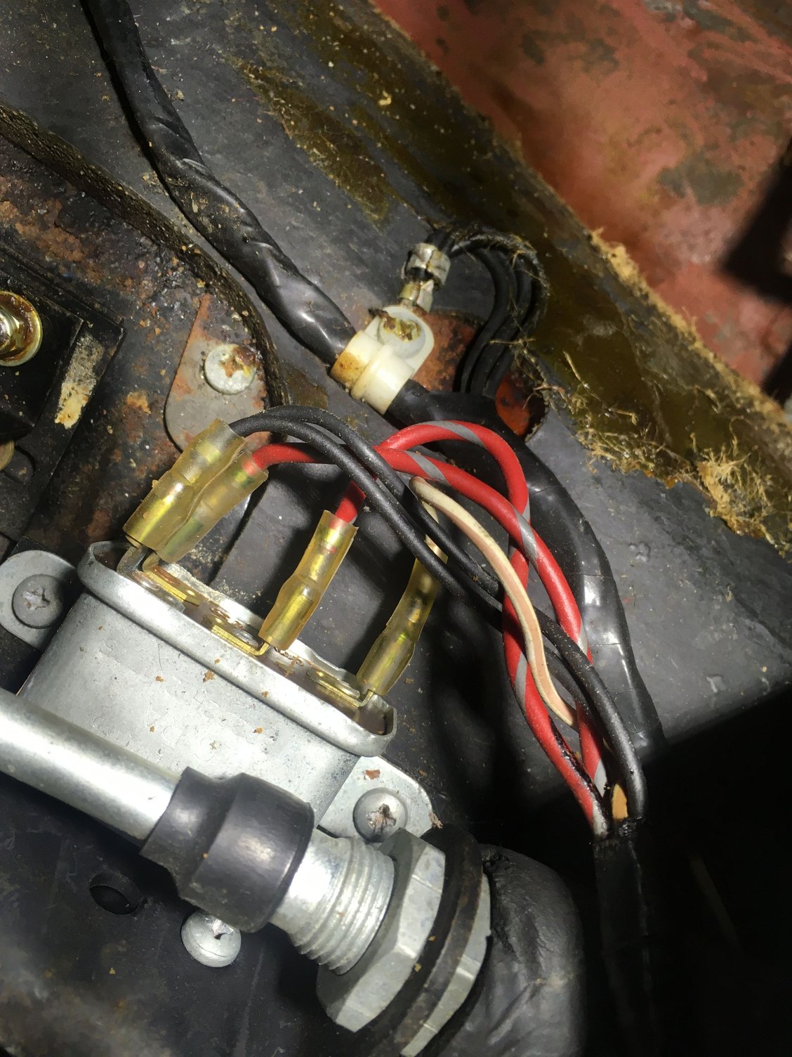

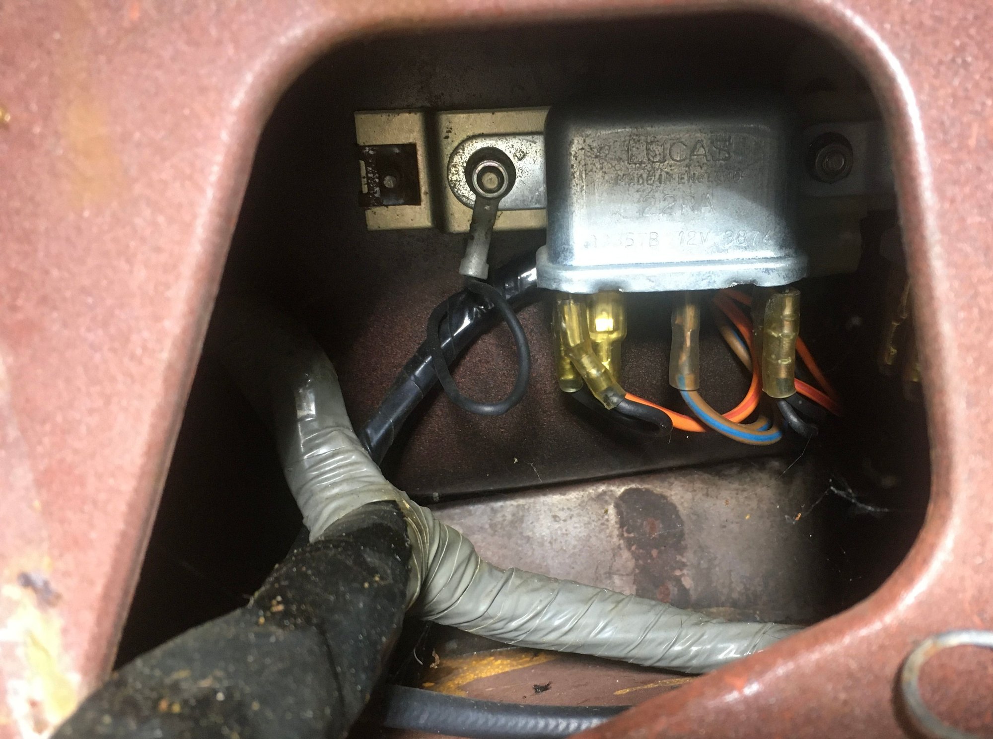

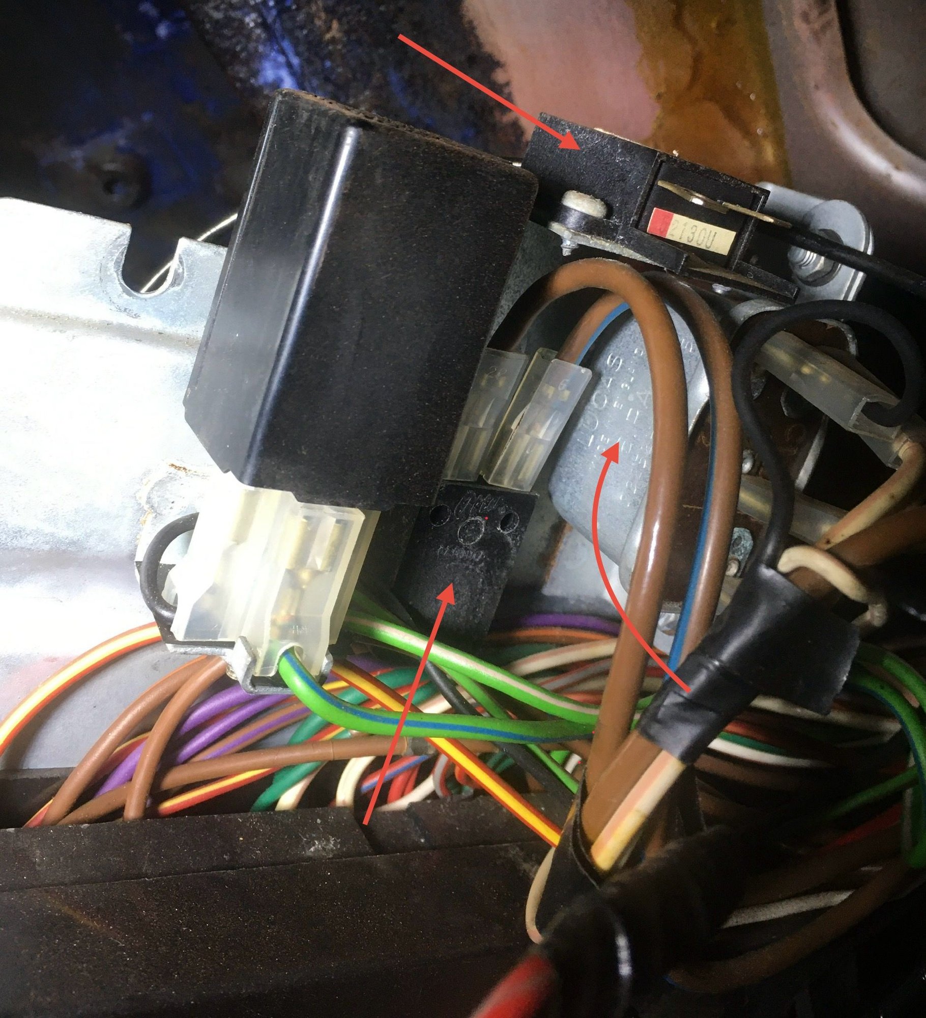

I need some help identifying these relays 1975 xj6c
thank you
rear bench lower bulkhead
above fuse box left side
below, near gear shifter

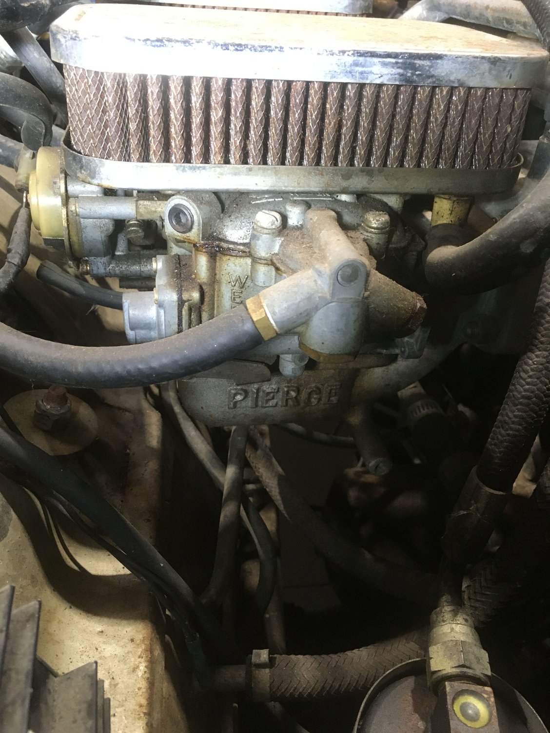

also this one has Weber carbs. Looks like a nice setup. Is this common? A good carb. ? Started right away with fuel in carb..

Pic #1 might be the starter relay.
Pic #2 looks like power locks. Is it under the rear seat?
Pic #4 those 2-prong black units are circuit breakers
Tell us the wire colors. That often helps

Ok. I’ll take picture with wires.
#2 power locks. I don’t understand why I hear power locks on the back of the coupe. Sounds like the coupe has power locks in the un openable doors…

I think you're hearing the relays clicking under the rear seat
