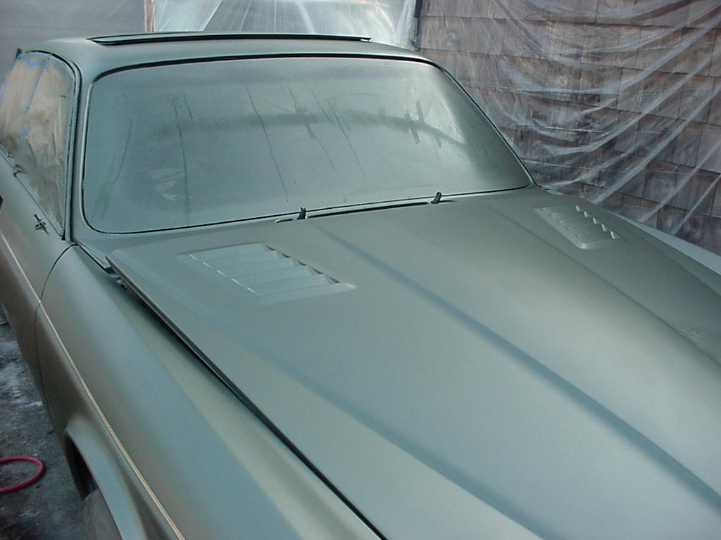

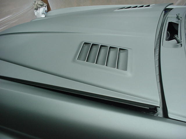

Old Jun 20, 2013 | 04:45 PM
ronbros's Avatar
Joined: Jul 2010
Posts: 7,362
Likes: 1,241
what do you think?

Old Jun 21, 2013 | 11:14 AM
LecXJ6's Avatar
Joined: Jun 2013
Posts: 16
From: Annapolis MD
Nice, is that an XJS hood?

Originally Posted by ronbros
what do you think?
What size are those looooovers?
Old Jun 17, 2015 | 04:51 PM
ronbros's Avatar
Joined: Jul 2010
Posts: 7,362
Likes: 1,241
i posted somewhere on this site!
but they are 6" wide and 1/2" tall ,they stick above the flat hood panel, considered important for drawing hot air from underhood, flat mount cast type air may slide over without much air flow , donno tho!
altho something that was studied back 50 odd yrs ago, at high speed a high pressure can build up at base of windshield(aka Camaro reverse hood scoops), and on flat mount louvers ,may force OR stall air flow out of hood!
i had a 1982 Camaro Pace car ,and installed flat mount cast louvers, but further forward and they worked well at reducing under hood temps!
so give some thought on where to mount things, NACA ducts are best at drwaing air out, and drag reduction,if its that important!
of course after shut down its a whole different story!
