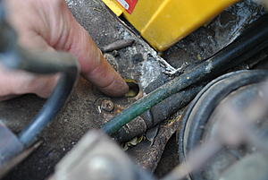

Does anybody else worry about a hood release cable breaking, or is it just me? If so what have you done for a backup plan of entry?
In my '74 TR6 I have a cable that I can reach from underneath, but it only has one latch and it pulls to the front to release. The jag pulls to the back which I guess means I'd have to create an eye or pully t pull from front.

It's happened to me. There's a small hole in the wheel well where you can stick a pointy screwdriver and trip the latch

Mine came loose from the attaching screw for the cable.. used a bladed screwdriver in the wheel well hole.
You should locate it and try it before you ever have a problem! Kinda hidden....

Hood Release-dsc_0482.jpgHood Release-dsc_0479.jpgHood Release-dsc_0477.jpgHood Release-dsc_0476.jpgHood Release-dsc_0475.jpgHood Release-dsc_0470.jpgHood Release-dsc_0469.jpg
