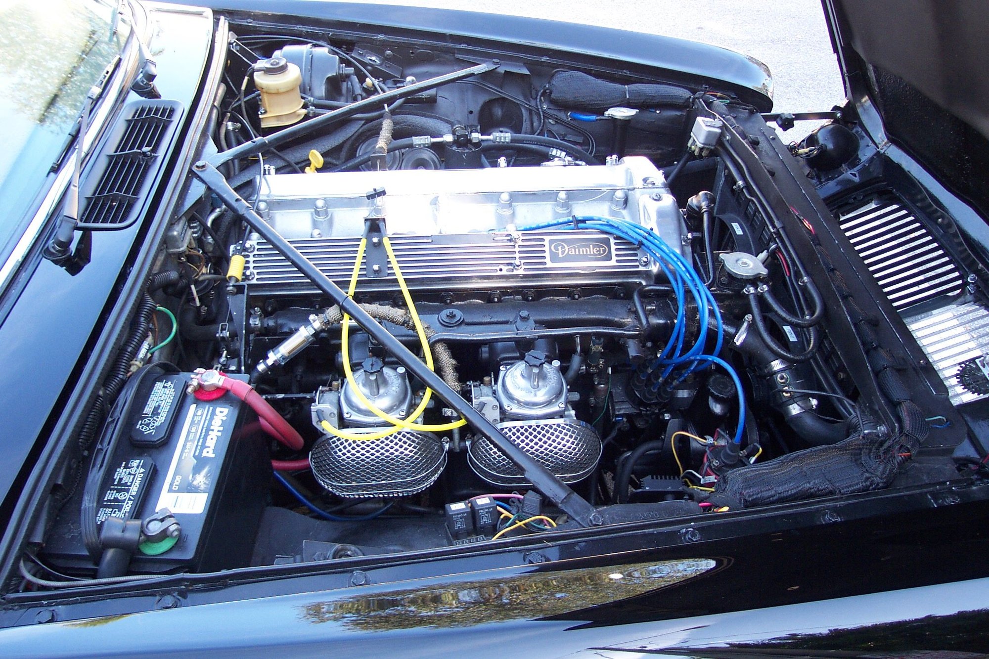

Well said sov211! My first Jag was a 72 E-type coupe. V12 of course. I rebuilt that entire car, even though it was in great shape when purchased. Using basic hand tools and a cold Canadian garage, it took 3 years, but what rewarding years they were. There can never be a more satisfying experience than spending an afternoon balancing those 4 Strombergs. When you finally hit that sweet spot with the mixtures and the idle smooths to silk, the grin from ear to ear has to be seen to be believed.
I never had anything but joy from that car, especially from the engine and I still miss it after 23 years. And that grin just gets larger each time someone say's "Can I see the engine" and you open to reveal what all those "Ooooh's" and "Aaah's "are about. Spectacular and simple to work on.

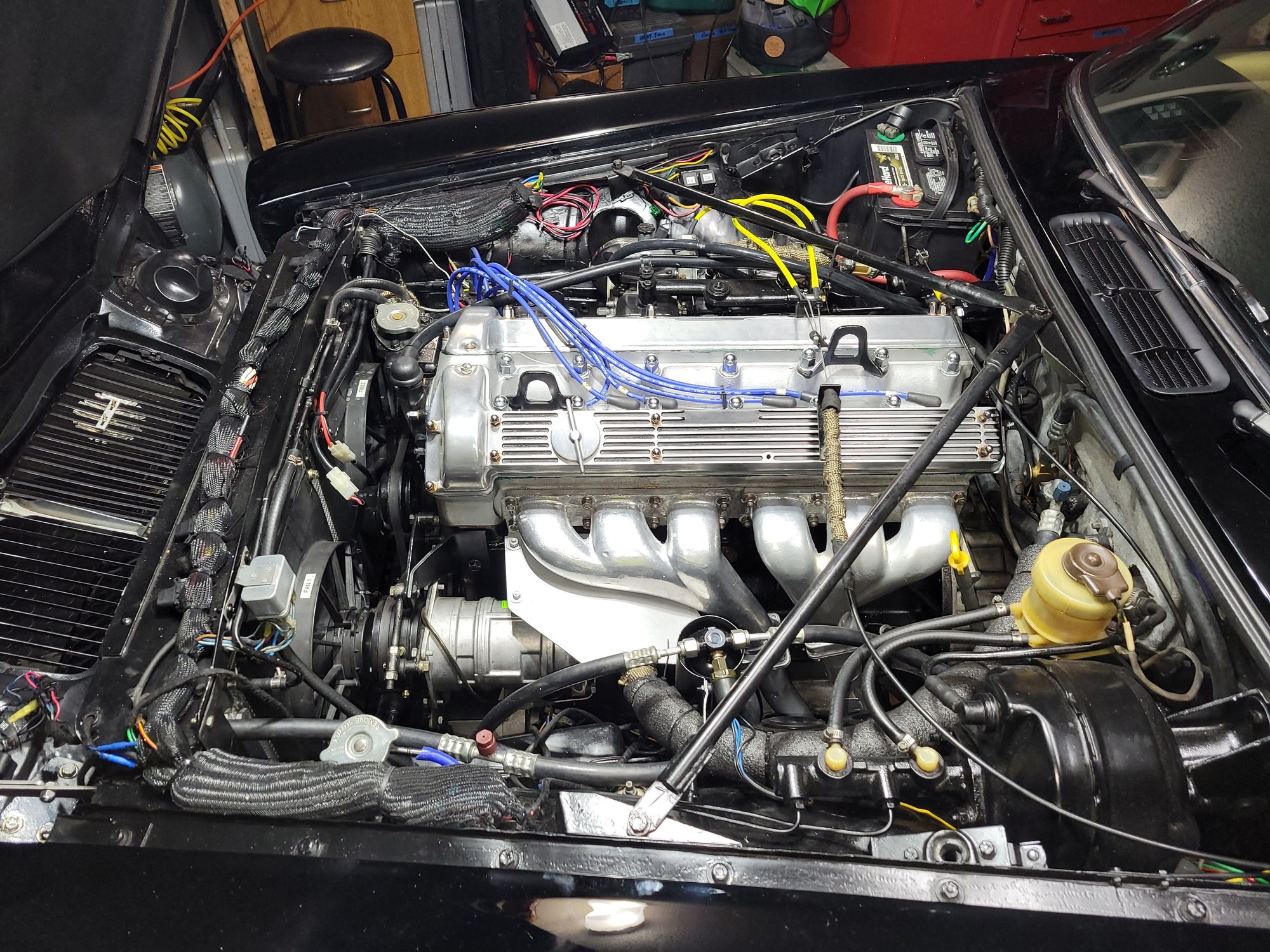

When people are looking at my car, I don't wait for them to ask to see the engine. Some people aren't interested enough to ask. So I ask "Do you want to see the engine?" And they humor me and say "yes". And that's when I get the ooohs and aaahs. They didn't expect to see that level of mechanical ART. And mine's only a 6-cylinder!
