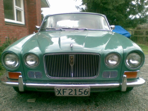

hey mate thanks for yout input, much aprecciated =) y have you been looking for so long for 1? i dont plan on using it as a daily driver i have a 79 galant that is bloody good on juice for a lil 1600. going to use the jgas to goto events and hust a weekend car. i dont want to change the body just upgrade the motor a bit. i have a mate who wants me to buy his v12 with 6 webber carbs on it lol i am pretty tempting but thatd be another huge gas bill =) i have posted 3 pics on the forum of the car. they are pretty **** but will get better 1s soon. hope u like and would enjoy learning more about the cars since u must have a fair bit of knowledge about them. im only 20 and shes my second car so yea i love it. at the moment shes not going because starter motor decided to die =( but got another 1 so its all good
