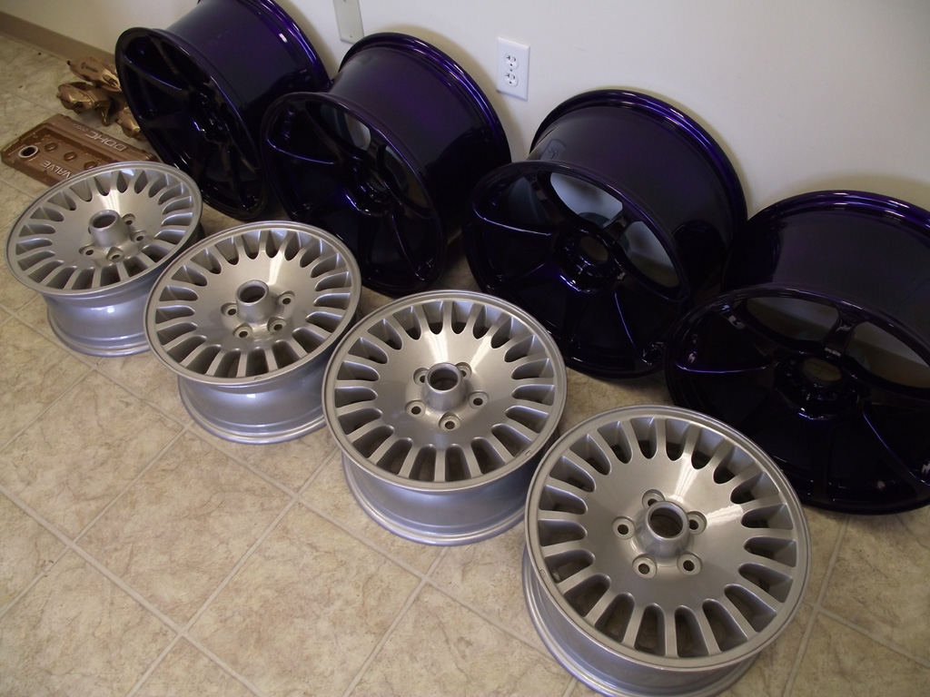

Here the my wheels. I had them stripped and powder coated silver. They are 16x7" and from a 1998 XJ8. The powder coated just finished them - can't wait to see them in person and put them on the car!
