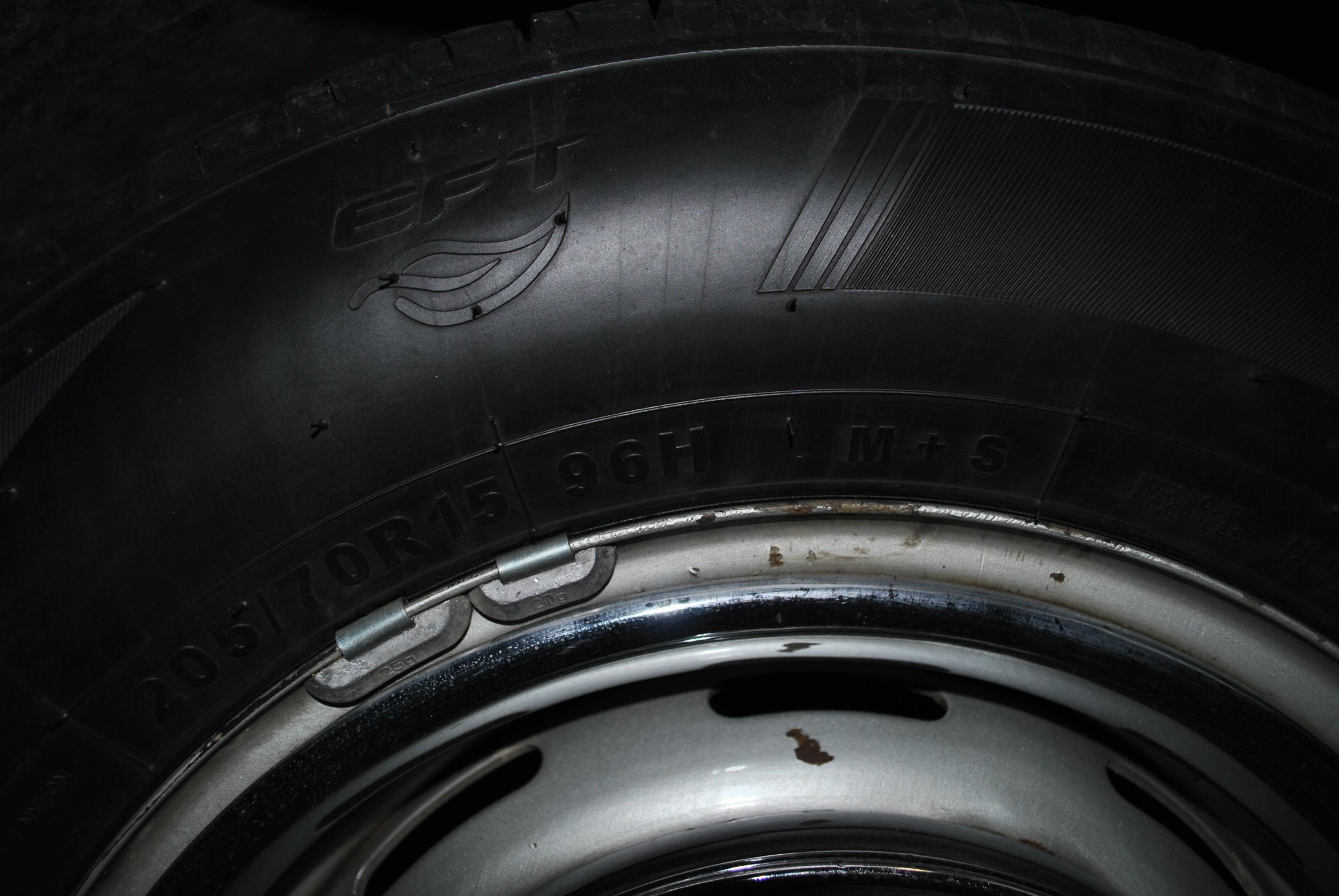

Funny you should mention that Steve, I recently fitted light truck tyres on my rears. Ones that would suit small SUV's or tray backs or delivery vans(ie Rav4, Hilux tray back).
When I needed new rears I decided to go back to the original size as I had 225/55R 15's, going to the 205/70R 15 would give be an extra 16mm of sidewall height which I need to clear the top of my driveway.
So I visited a few shops and had two options,Michelin or Pirelli at about $300+ each. One tyre shop said to me why don't you try light commercial's so I humoured him and had a look at what he was selling, When he bought one out for me to look at it didn't look unlike a passenger car tyre so I gave them a go. $245.45 for the pair fitted!! (Sailin CVR)
He said if I wasn't happy with them after 1000km he would refund the full amount towards a pair of Michy's. He said he had fitted them to an XJ6, 6 months earlier and the guy hadn't been back.
I drove 2000km over Easter mainly in the wet on highways and have have driven to work for 3 months on them. I even did laps of a race track pushing the old girl fairly well, never let go once.
They don't generate any more road noise than the old Michelin's I took off, so far happy with them as far as everyday tyres go. I have done 3224km (2015 Miles) on them so far.
