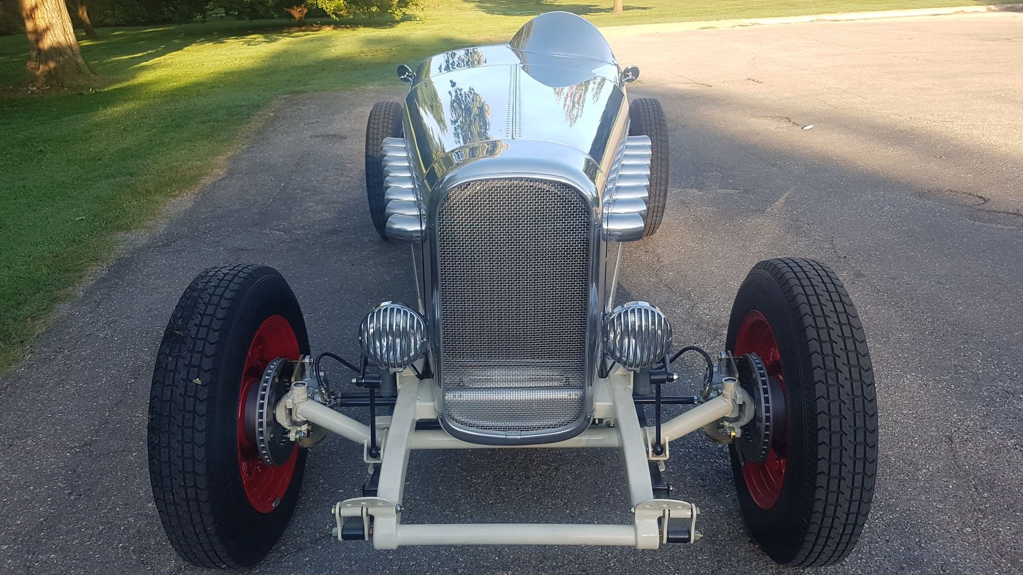

I designed and fabricated a 1930's style race car and I want to install a Jaguar XK engine. I don't have any experience with Jaguar engines or transmissions so I'll need help from the experts out there.
Here's a list of my questions:
What year did they stop using carburetors?
Are the XK engines basically the same except for emissions equipment (block, heads, cam, etc.)?
Can you remove all of the factory emission's equipment and convert it to a non-emission engine?
Is there a way to adapt a Borg Warner T5 manual transmission?
Are there any intakes that will accept Weber carburetors?
Is it practical to attempt to convert a later model emission equipped engine to a basic carbureted type setup?
If anyone is interested here's a link to a short video of my build-

I appreciate the compliment, it's my first ground-up build. The car is not very complex, had to keep it simple if there was going to be a chance at completing it.
It was built in my 2 car garage located in Tulsa, OK, would be great to have a shop.
