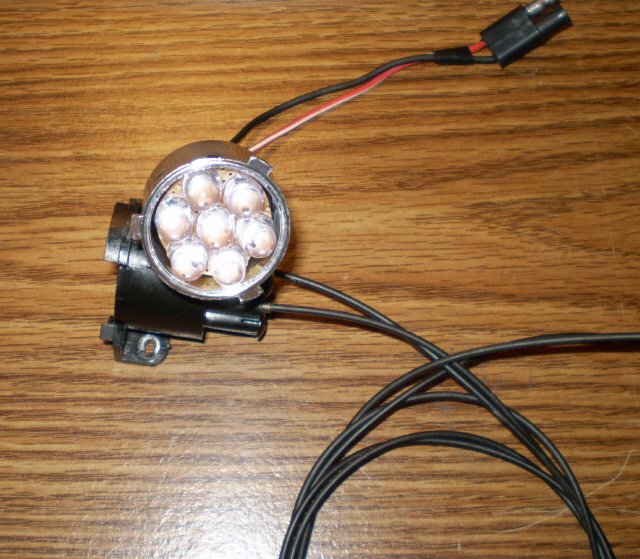

you bet Glenn, now you know it's easier to just remove the bulb socket to replace the bulb. In my car, I have seven LED's in the opticell, a friend made it for me. I can now see the Headlights switch illuminated at night !
PS: I cannot see your images, they are too small.
Attached Thumbnails Instrument panel fiber optic light upgrade-02-opticel-modded-.jpg
