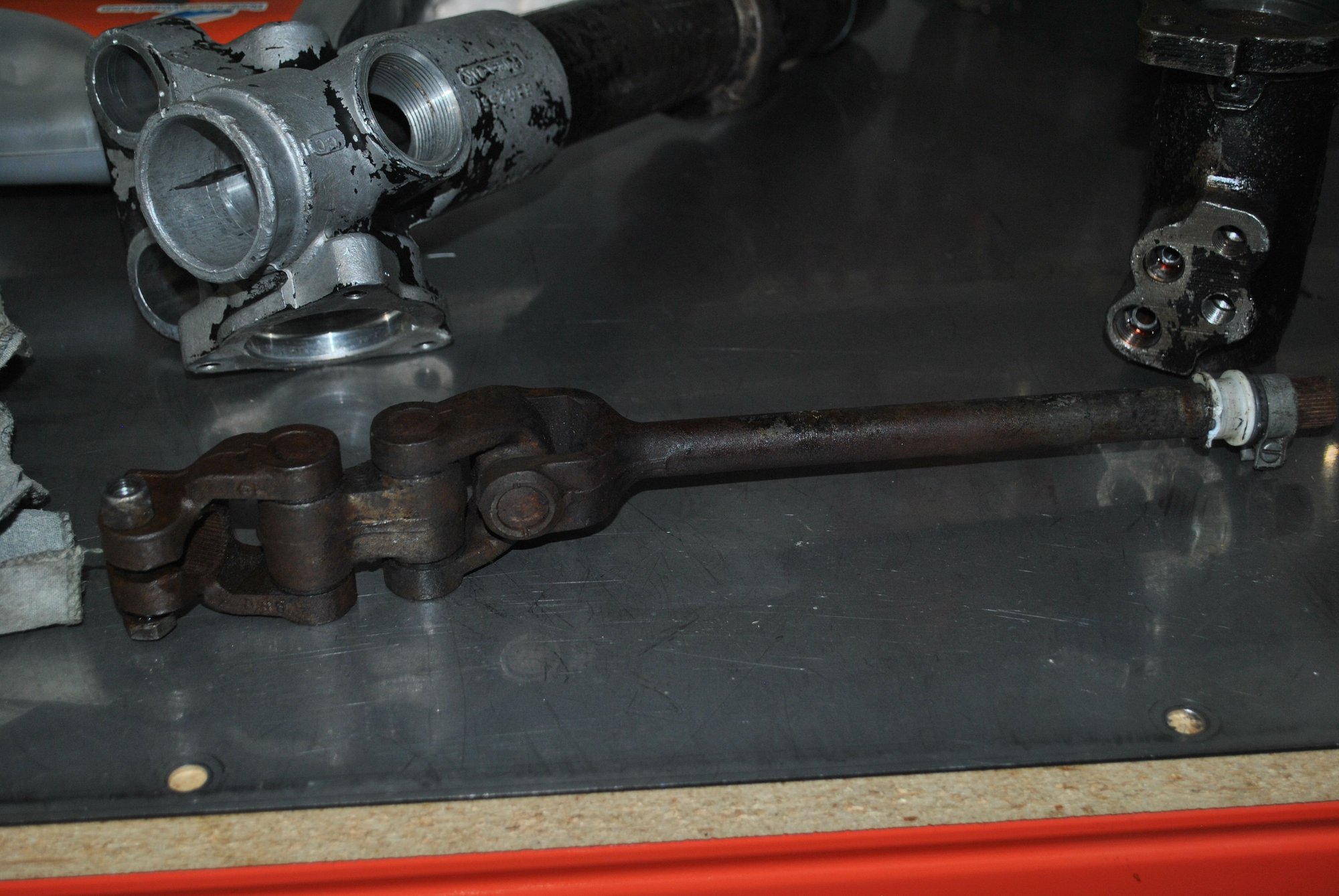

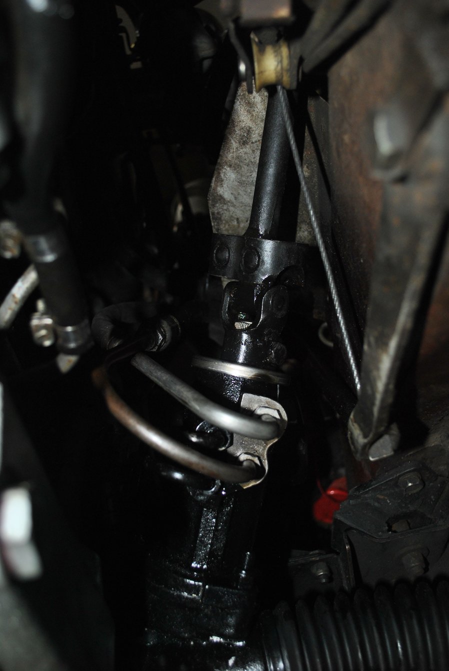

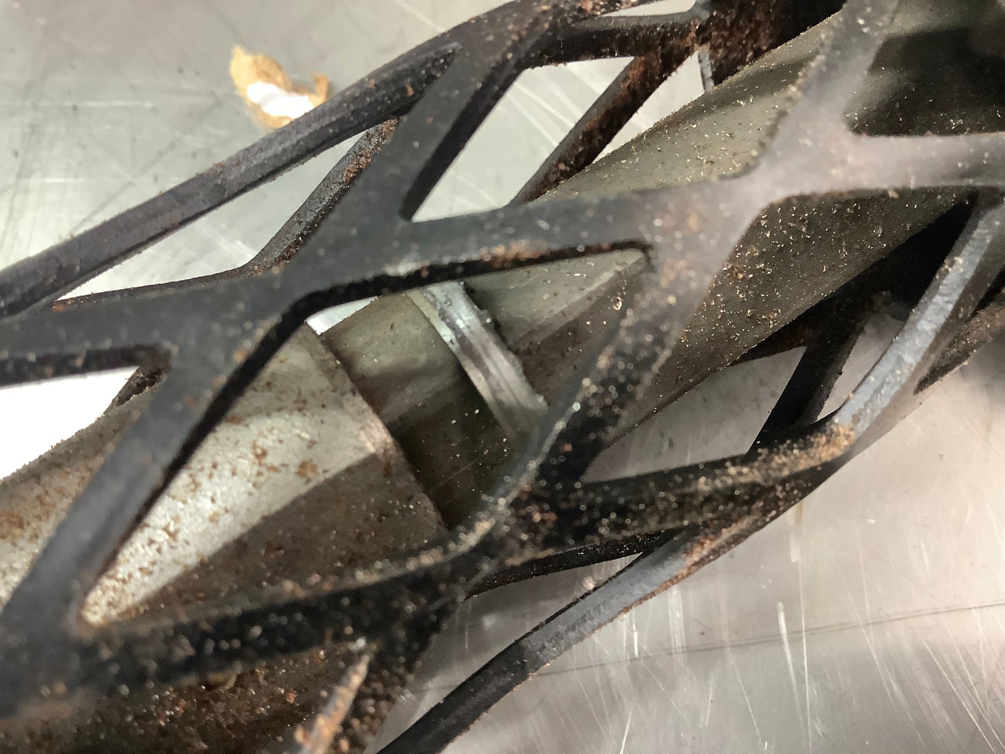

I am pretty sure the car has had the S3 steering rack upgrade, as when I gave the guy the rack to rebuild it was NFG so I gave him my spare which I was told came out of an S3 and it was the same as the one I had removed from the car.(Also looks the same as the one in my 1985 XJS)
Can anyone confirm from my pics it is a series 3 rack.

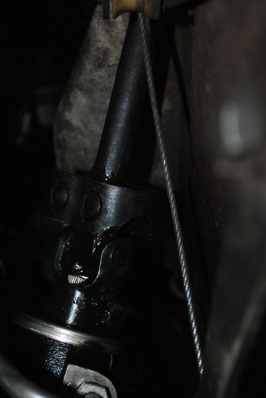

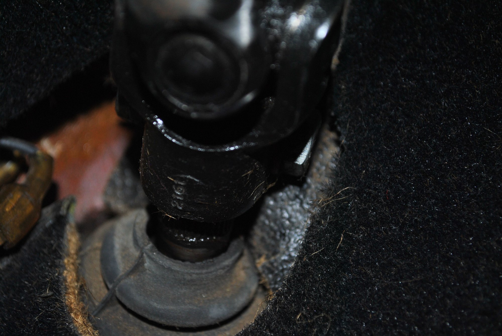

These are the two universals, he assumes the one connecting to the rack is the problem.

Not much in the column to bind like you describe.
The joints, maybe, but usually a "tight spot", not as you describe.
Slide the cotter bolt out, slip that double joint off the spline, and feel if there are rough spots. I have not had issues with that item on any of mine.

That's a S1 rack. They have a tall valve body, and hose that wrap around and enter the rack from the rear.
Later racks have short tower, and hoses enter straight in from the front.
The steering columns for each must be used, as one is longer.
FYI, swapping in a later rack, column and hoses is a nice improvement, as the later racks have less boost which improves "feel".

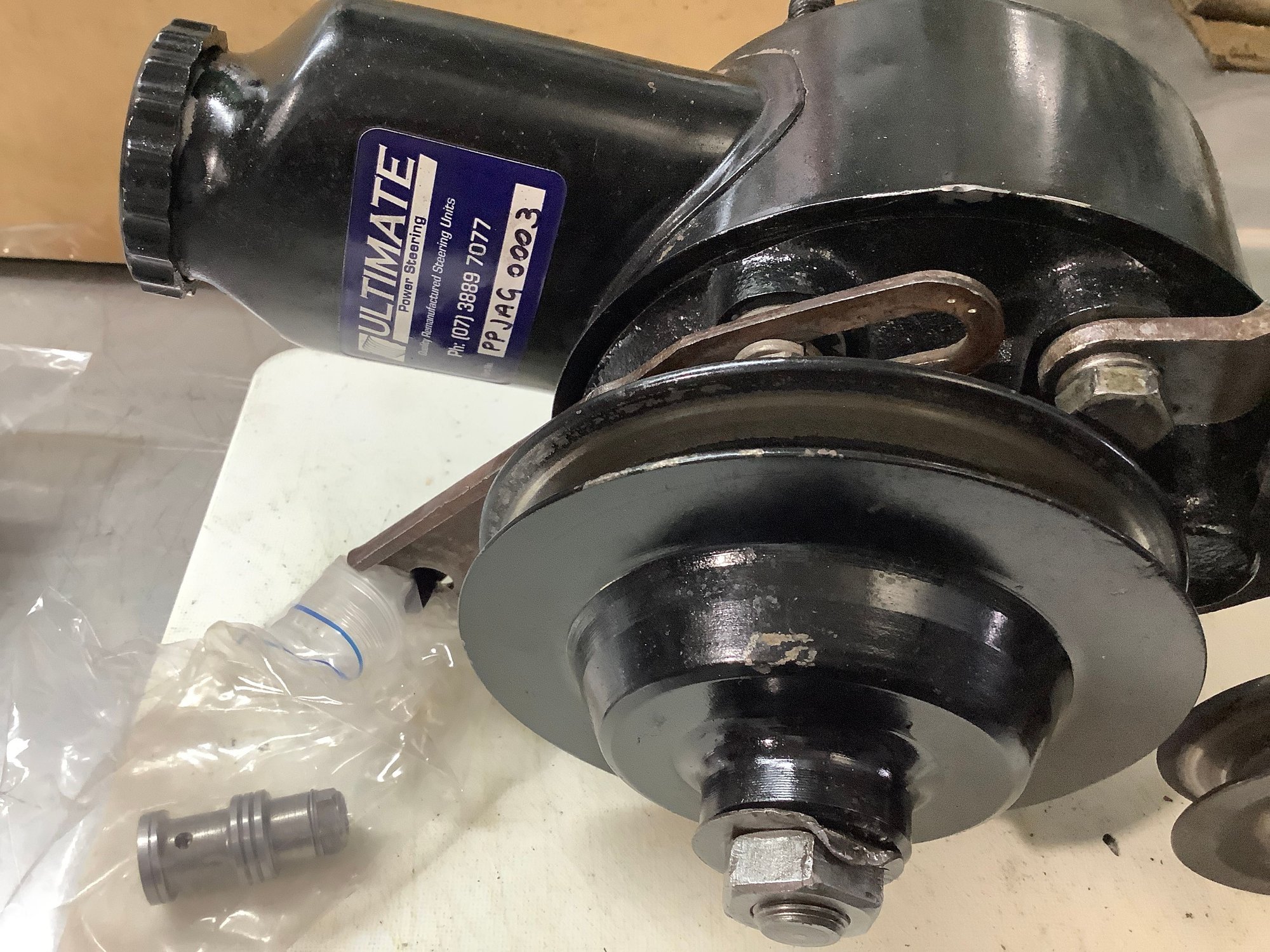

Pump is coming out tomorrow and going back to reconditioner for a once over and replace pressure relief valve.
Old Oct 20, 2020 | 05:12 AM
o1xjr's Avatar
Posts: 28,386
Likes: 6,340

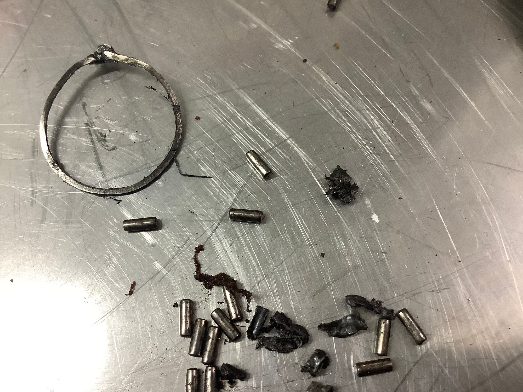

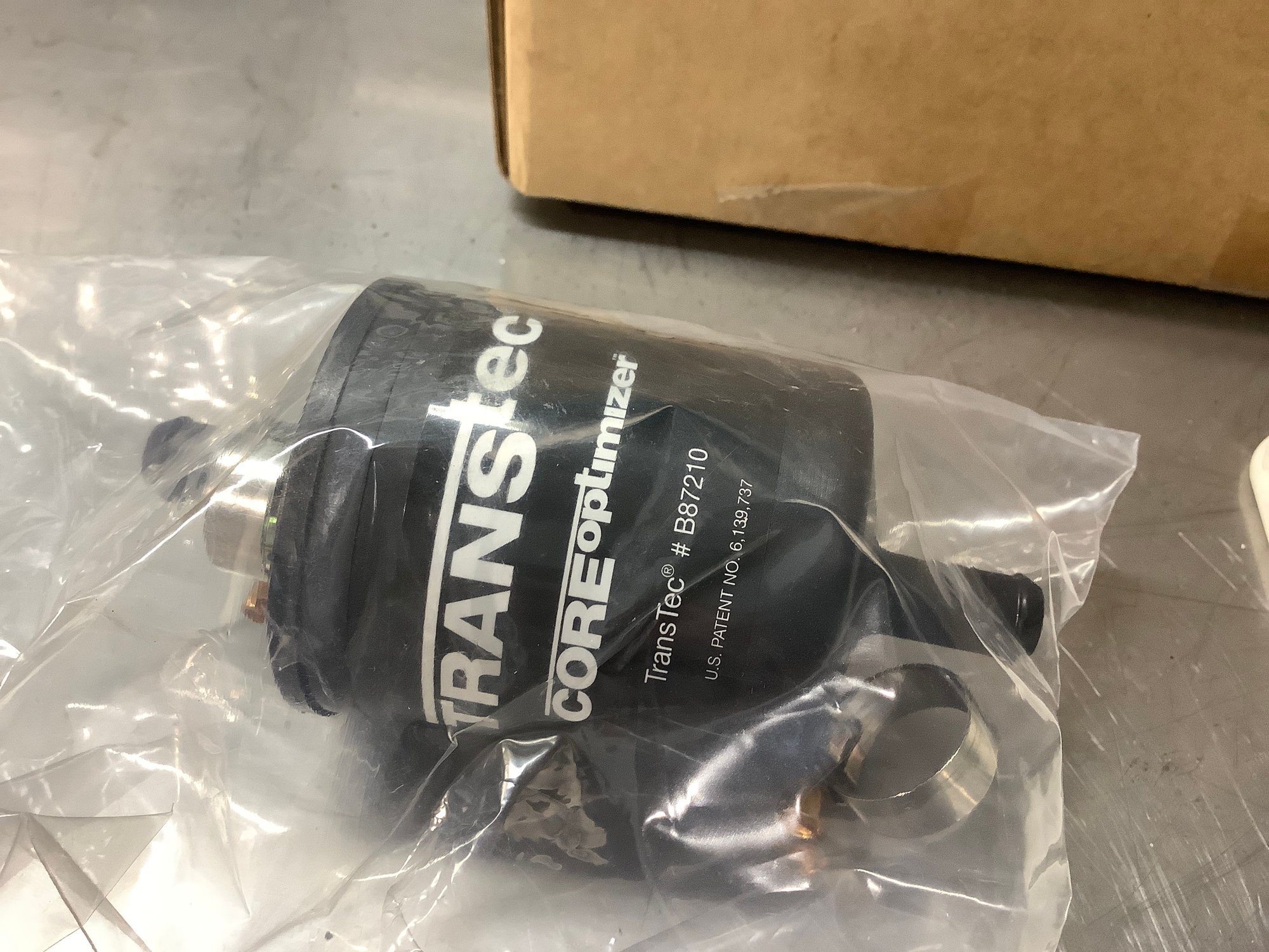

The guy took the pump apart, checked it over and cleaned it out. Replaced the pressure release valve and increased the psi. Bench tested and checked flow rate.
He supplied an inline filter for the return hose. I will get it back in and see where I am at now.

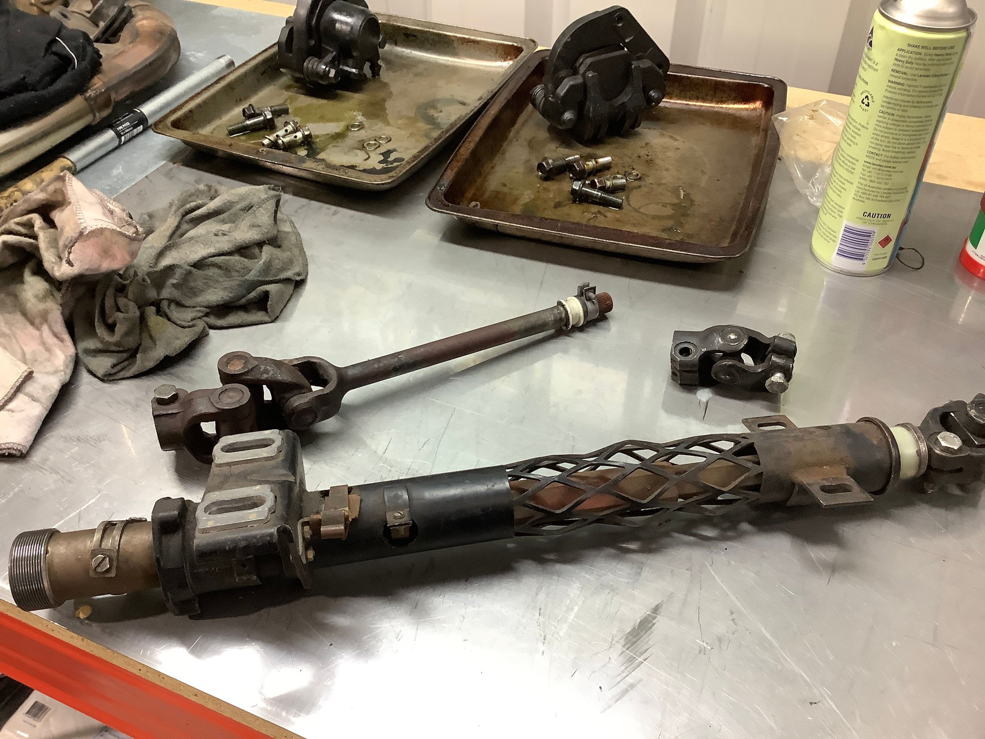

After 13 months and $2000 problem solved. There was a collapsed bearing in the bottom of the steering column.
Rack and pump needed a rebuild anyway. Steering feels better than it ever has.

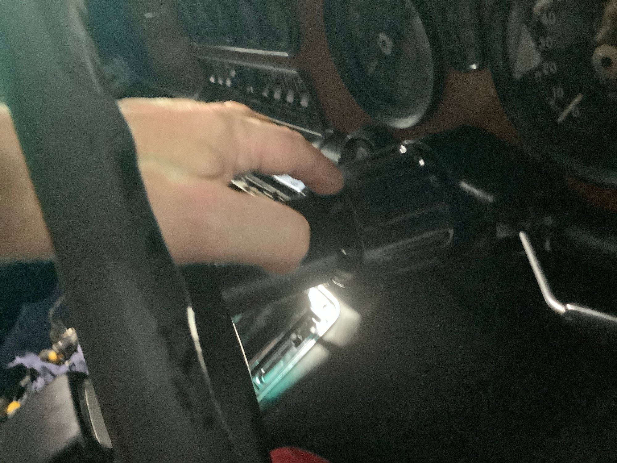

Problem now is the lock nut for steering wheel adjustment won’t lock, any ideas?
done up tight and I can slide steering wheel in and out
