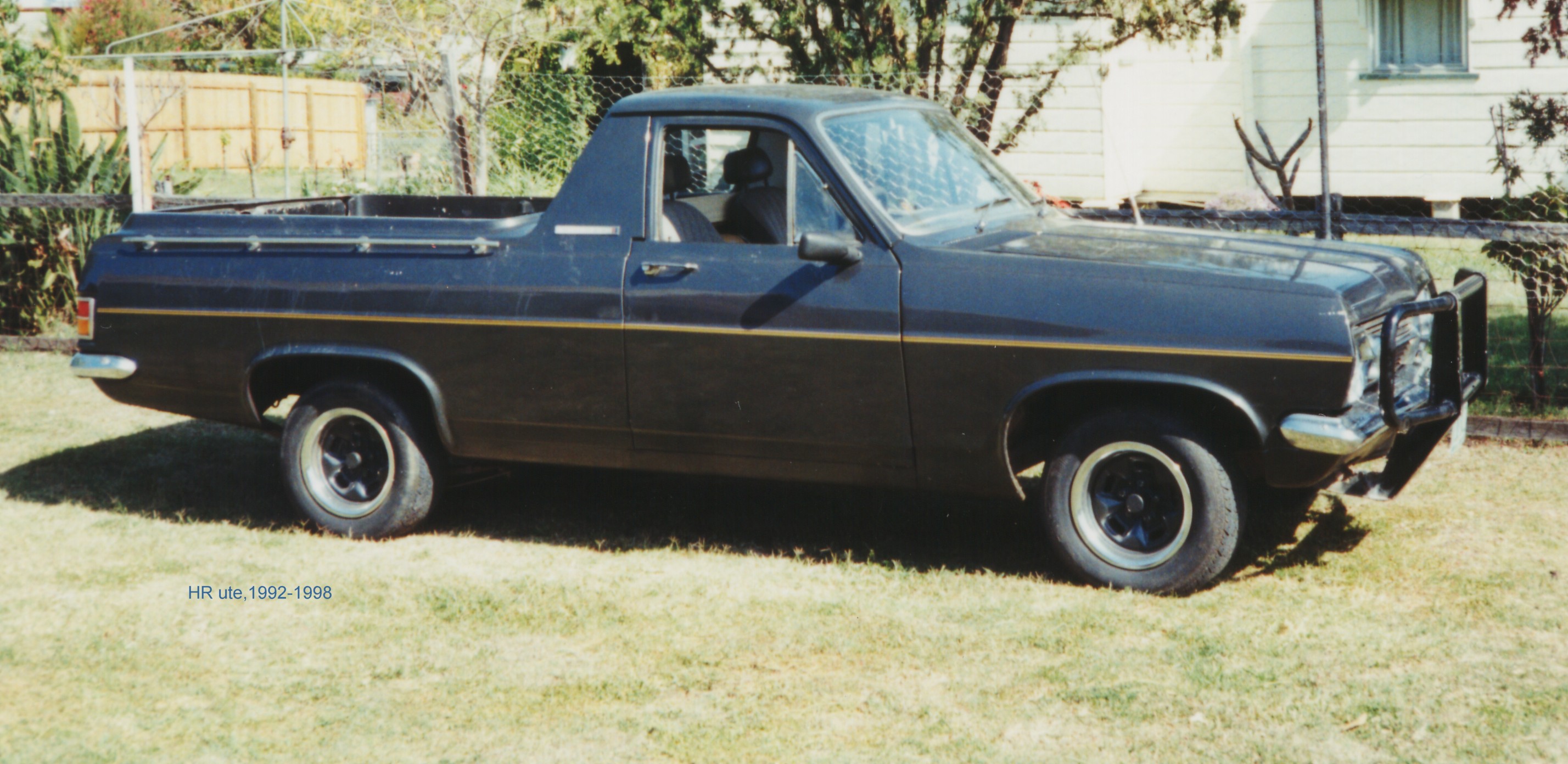

That brings back a memory of being locked out! When I bought my HR the seller neglected to tell me he removed the key locks for a cleaner line when he had it painted.
Got it home and locked the doors,only to find the next morning it had no key holes...
A length of No.8 wire through a quarter window and eventually unlocking the door from the inside worked. Never locked the doors again in 7+ years. Just fitted a kill switch under the seat.(an old floor mount hi/low beam switch I had floating around)
Good luck getting it open Elinor.
