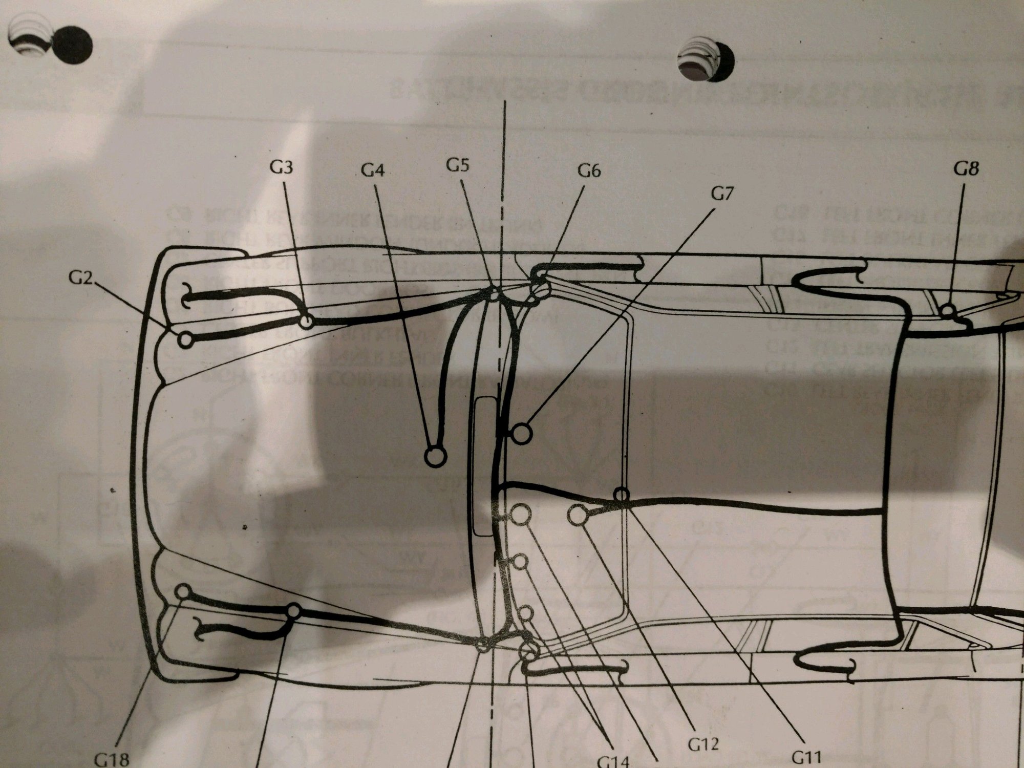

I have a new problem where my Windshield Wipers stopped working. They were working fine and then I was caught in a rain and they worked fine all through that. Next time I tried to turn them on nothing. I've checked the fuse and it is fine. Before I jump to the conclusion that it is the wiper switch (doesn't work on any setting) I want to rule out a bad ground. On the diagram it shows the location as "Right Bulkhead Connector (Below)". I have looked behind and around the battery on Passenger side and removed the glove box but I see no ground point. Before I remove the crash roll or more stuff, I thought I'd ask if anyone knows where this ground point is. "Right Bulkhead Connector (Below)" is not a very good description.

Unluckily, I am knee deep in my electrical. The G5 ground is on the edge of a strengthening rib directly outboard of the wiring bulkhead connector (right side). It's just a small 4mm bolt with star washers through a small hole the stiffener. Everybody is correct-ground are the root of most evils.
