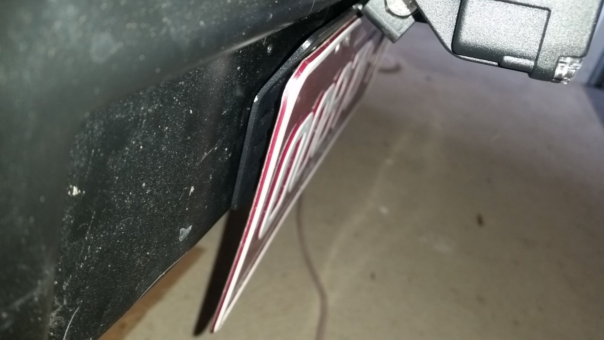

First problem is that the provided mounting plate that goes behind the licence plate doesn't play well with the recess in the s3 bumper. If fitted low enough to fit in the recess the bumper then interferes with fitting the light bar mounting and any upwards adjustment. Putting a lengthwise bend in the mounting plate to push the top out about 20mm made it all hang together. The mounting plate bolted to the bumper with a couple small stainless bolts and the licence plate with existing fittings and holes.

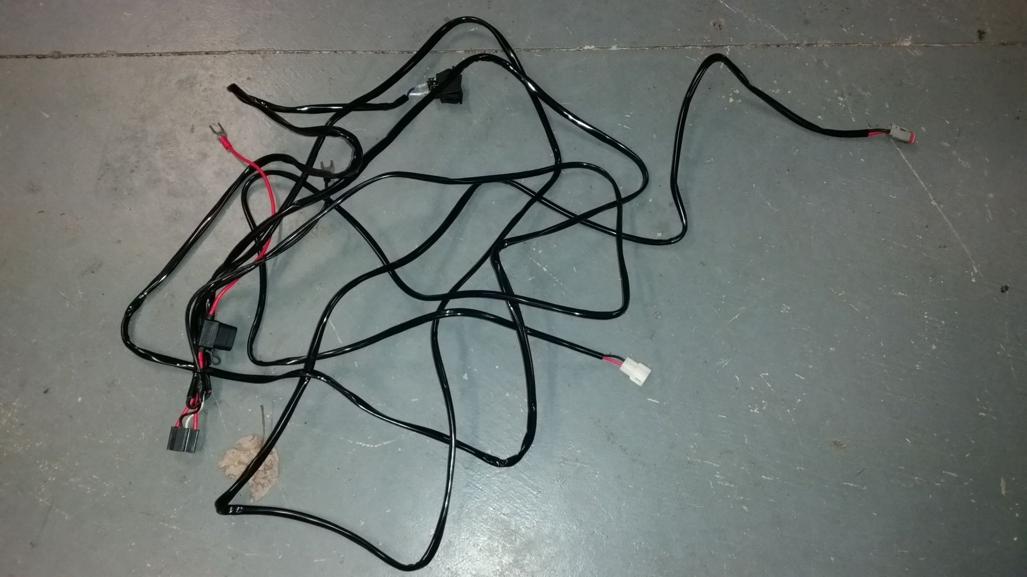

Probably best to layout the harness and test the package before installing. Just to be sure its working and likes whatever you are using for the relay signal leads. Issues can arise with different cars being switched +ve or switched -ve. This harness was faulty and replaced by the vendor , but they didn't bother taking this one back. After repairing what ailed this harness, it tested OK with a simple connection to +12v at the high beam connector

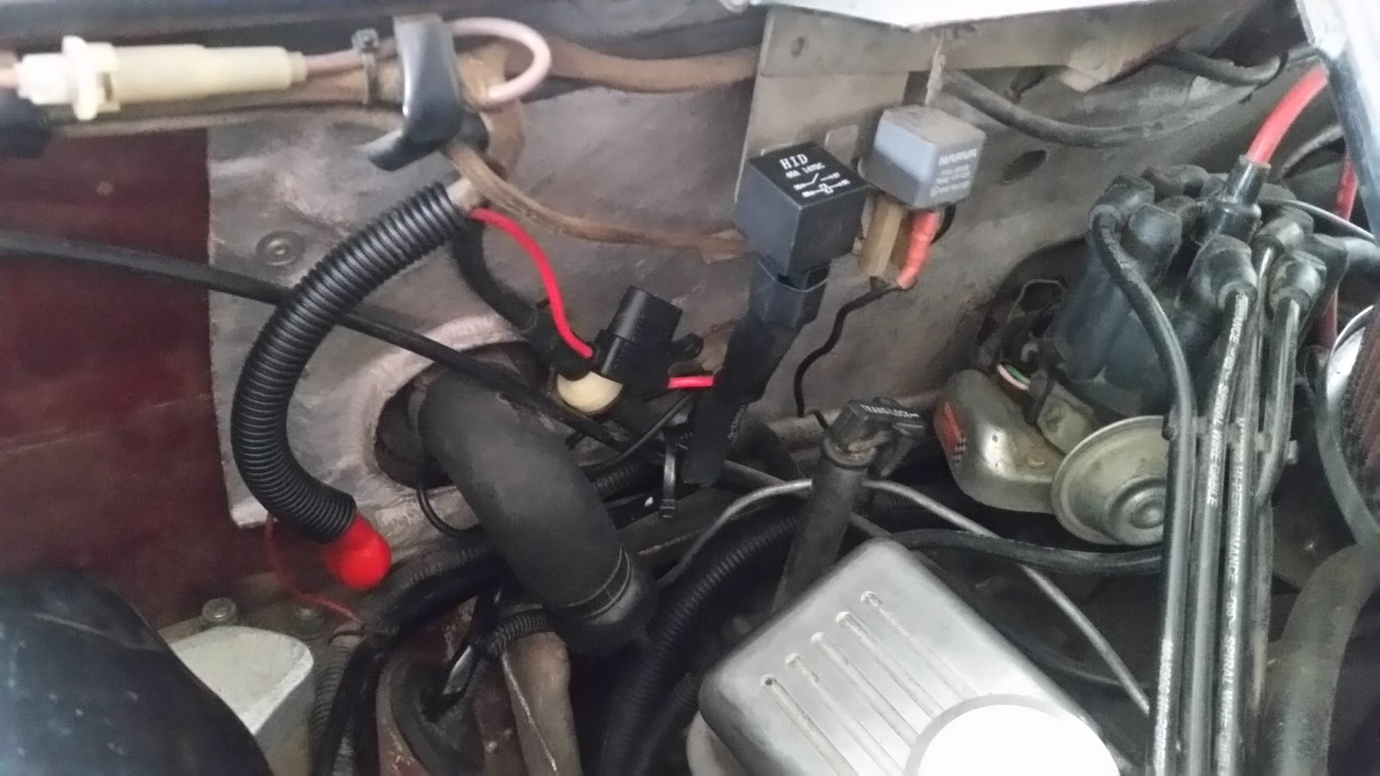

The harness went on the less cluttered drivers side (RHD) as we have the luxury of battery lug on the Jag to pick up a good battery supply on either side (I hate the 17 leads on the battery terminal syndrome). The standard relay holder is right above the power lug and a couple of good earthing options. The harness length going forward to pick up the high beam signal and connect the light bar are pretty much perfect with little need to stow excess. I cut away the black wire and connector that normally goes to a headlight wiring adapter and just connected the red wire with a bullet connector to the existing wiring to pick up a high beam signal. In my State extra lights must activate with high beam only and also must be able to be separately switched off, so I am emulating Clarke @o1xjr with an in ashtray super turbo switch for the light, Be warned that this does open up the whole ski slope fantasy land to be able to re-install the ashtray base but makes for a nice out of sight installation.

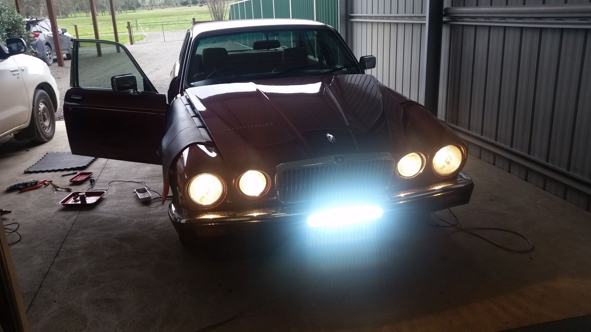

If the other cars are a guide, the lightbar gives a slight increase in distance but a big increase in overall brightness and width of beam which is good for picking up critters on the side of the road. For less than $100, well worth having I think. It does interfere with the classic lines and all that, however if I don't see that wombat or Bambi I wont have any classic lines to worry about. Will probably also add some brighter H4s in the low beams as well as they are pretty dismal and are only going to look worse when the lightbar goes off when dipping the headlights.
