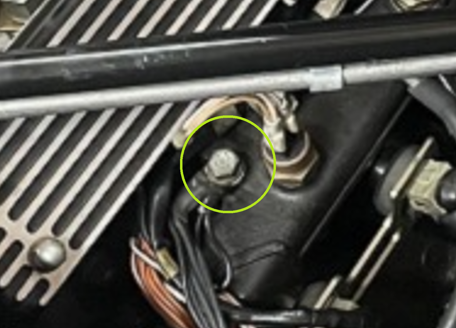

I was recently reading about the common grounding point for the fuel system at the back of the water rail on the right side of the engine.
and was wondering if it made any sense to connect this bolt directly to the negative terminal of the battery via a long ground strap rather than relying on the grounding path through the engine block to the chassis and back to the battery. Could there be any downside to doing this?

I see no downside to grounding those wires as you've described.
Along the same lines check for voltage drop to the ECU when cranking. The ECU really likes full voltage. Long story short I fixed a "extended cranking" problem on my XJ6 by simply replacing the battery....after pulling my hair out pursuing other causes.

Re: the extra grounding strap. I did notice the grounding bolt at the back of the water rail. I see that there are 4 thicker black wires and one thinner black wire grounded to it and all these black wires are part of what looks like the fuel injection harness. There is also a tiny ground strap that goes from the bolt to a nut on the intake (presumably to better ground it to the head).
Five black wires is an interesting number. There are six injectors and a cold start one as well. Makes me think they must be combining wires somewhere in that harness to get just 5. I know the engine runs perfectly smooth once driving so I assume there is no grounding issue with the injectors.
My problems seem to more ECU/voltage related.

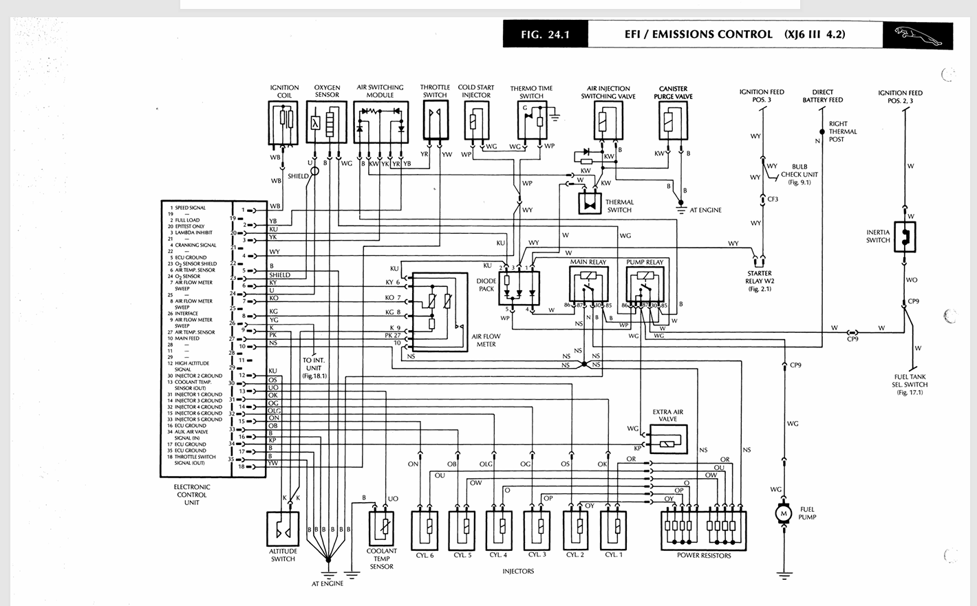

The five ground wires at the water rail are not for the injectors per se. They ground several components, one of them being the ECU. The ECU in turn grounds the injectors
The diagram below will illustrate. Look at the bottom for those ground wires
If you wanted to do some digging check the voltage at the ECU terminal 10, which is the main power feed to the ECU....supplied by the main relay...which itself is grounded at the water rail
DD

Now that I see this diagram, that grounding point is much more significant than I thought. It seems the ECU, main relay and some of the sensors all ground at that one spot and it is right there on top of the engine. I will make sure to add a dedicated grounding strap to it that goes directly to the battery negative terminal. If nothing else, doing so might add a little voltage as seen by the ECU if this improves the ground reference.
