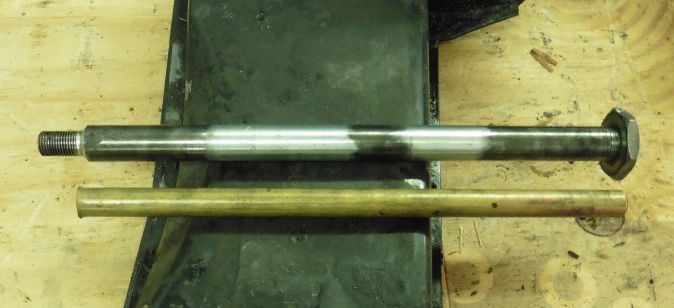

When we did this, we used a loooong brass drift to beat the fulcrum bolt out and it took quite a lot of bashing. NO damage occurred to threads as you can see in the picture below!
Of course, it's a little late now, as you've already boogered up the threads.
But next time..........
EDIT: If this was my problem, I would grind a taper on the threads until I was past all the jimmied ones, and then run a tap. Of course, I do a Lot of things different./EDIT

Ohhh I was so excited. My new fulcrum shaft and bushings came. Same F' in problem!! The bushings won't slide over either the new shaft or the old one. 4 brand new Uro bushings and none of them fit!!!
I am doing something wrong here? The lower wishbone bushings should slide up and down the fulcrum shaft freely shouldn't they?
I need to figure out how to make these bushings fit. Any ideas?
Old Sep 20, 2018 | 11:11 PM
Posts: 26,779
Likes: 10,318
Then you got the Wrong bushings Again!
They should slide over the shaft and be snug, lubricated with a bit of anti-seize compound, but they should Definitely slide over the shaft. Especially a new, unscarred one.
