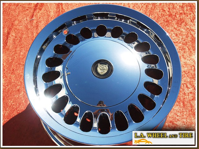

I think they are Xj40 wheels, teardrop chromed. Image attached. Although we were given receipts for almost everything else, papers for the wheels weren't included.
I wouldn't be surprised to learn the PO got them out of a wrecking yard somewhere so they probably weren't in Pristine condition. At any rate, I now understand more about chromed wheels, their care and feeding, and probably the next time I get new tires, I'll have all the wheels inspected, including the spare.
I just looked up replacement cost and I'm a little shocked. So I guess I'll have them re-chromed when that time comes. <shudder>
