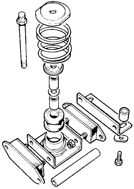

Looked at my transmission mount today and noticed there is a 1 1/2" threaded rod coming vertically down from the mount plate. There is nothing attached to it, but Jag would not have put it there for no reason. Any thoughts as to what it is for? I cannot find any reference or pictures to explain what it is there for.

it must be the transmission support?
Attached Thumbnails Mystery threaded rod behind transmission?-xj-6-trans-mount.jpg

Here's a pic of the transmission mount assembly

I call that the 'tongue'.
The tongue extends under the transmission pan and should be parallel to the pan. If not parallel the rubber mounting blocks are sagging or broken.
The mounting system is designed to allow the trans to move up-down a bit against the big spring. The central 'cotton reel' cushion limits the movement.
The two rubber blocks seen in the other picture are the actual 'mountings'
Crazy system. Too many parts and it's quite possible to assemble the thing upside down. Ask me how I know. Gotta pay close attention on disassembly.
But, it works !
DD

The picture makes it all clear now. The rod that points upwards holds the spring and cotton reel but the "Threaded Rod" that I was referring to in fact points downwards and you can just see it in your picture. It is close to the "tongue" mounting bolt holes and is offset to the RH side. Yours seems to have something round mounted on it.

Originally Posted by iramphal
Thanks Doug,
Hmmmm. Not sure; can't remember.
The pic isn't mine; just something I grabbed of the internet (and actually originated from this forum). Post a clear pic of what you have and it may ring some bells!

Thanks Doug,
The picture I posted is what I have and you can clearly see the "stud" pointing downwards. I cannot believe it's there for no good purpose. Perhaps a shield or cover of some sort? I've re-attached it below.
https://cimg0.ibsrv.net/gimg/www.jag...6c75048e78.jpg
