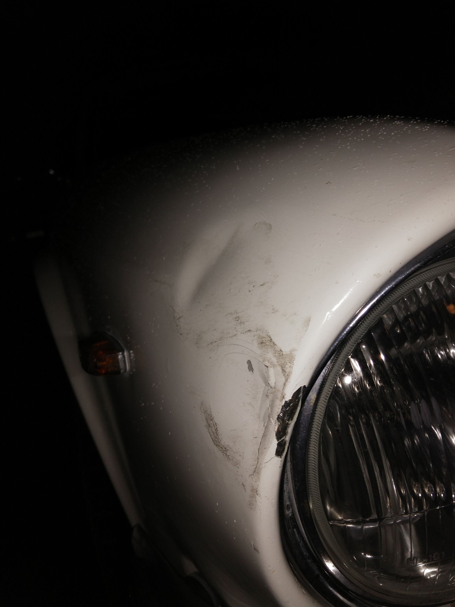

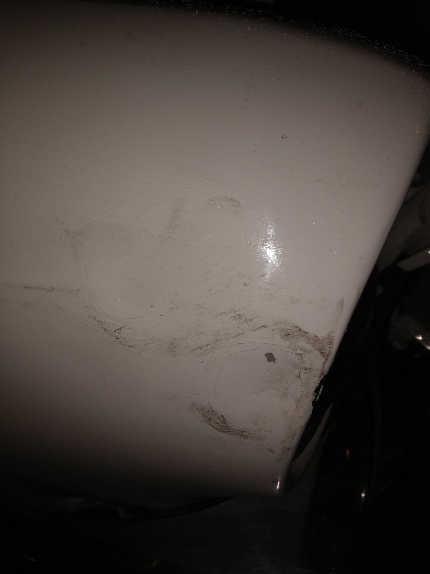

It was a sad day today...i crashed my car to another car today, and my Jag got couple dents and paint cracked, is it possible to fix this? If it is, can you please help me, thanks already!

I would have thought that the simplest fix would be a replacement panel from a wrecker's yard. If your car is still in its original paint you may get lucky and find a match.
The fender (wing) is just bolted on and fairly simple to replace for someone at all handy. Having just taken these off my project, some of the bolts are difficult, but not impossible, to remove. You could probably replace it in about half a day.

Yeah, a couple of thoughts. One would be to ask where you are.
1, In the USA we have "dent doctors". Their tools and skills are directed to minor scrapes and bruises. The pictures indicate this might be within their skills. Paint touchup is included.
2. If you remove the out board head light, you might be able to
push pry that "low" spot back in to alignment with the rest of the wing. The issue is how much the metal was "stretched". Shrinking is
a way to solve that, but the paint suffers!!!
Same comments for the other part.
3. I conclude that you chose not to buy "collision" insurance that would cover the damage to your car. With a deductible, though!!!
4. Swap out the fender aka wing!!! As stated, with luck, with one of the same color!!!
On the damaged one, do as the pro's do. Cut the metal away to reveal the fasteners, on the damaged one, of course. If it is a pik an pull yard, you'll work hard to get the wing off sans damage.
5. OTH, other listers have recovered from far worse !!!
