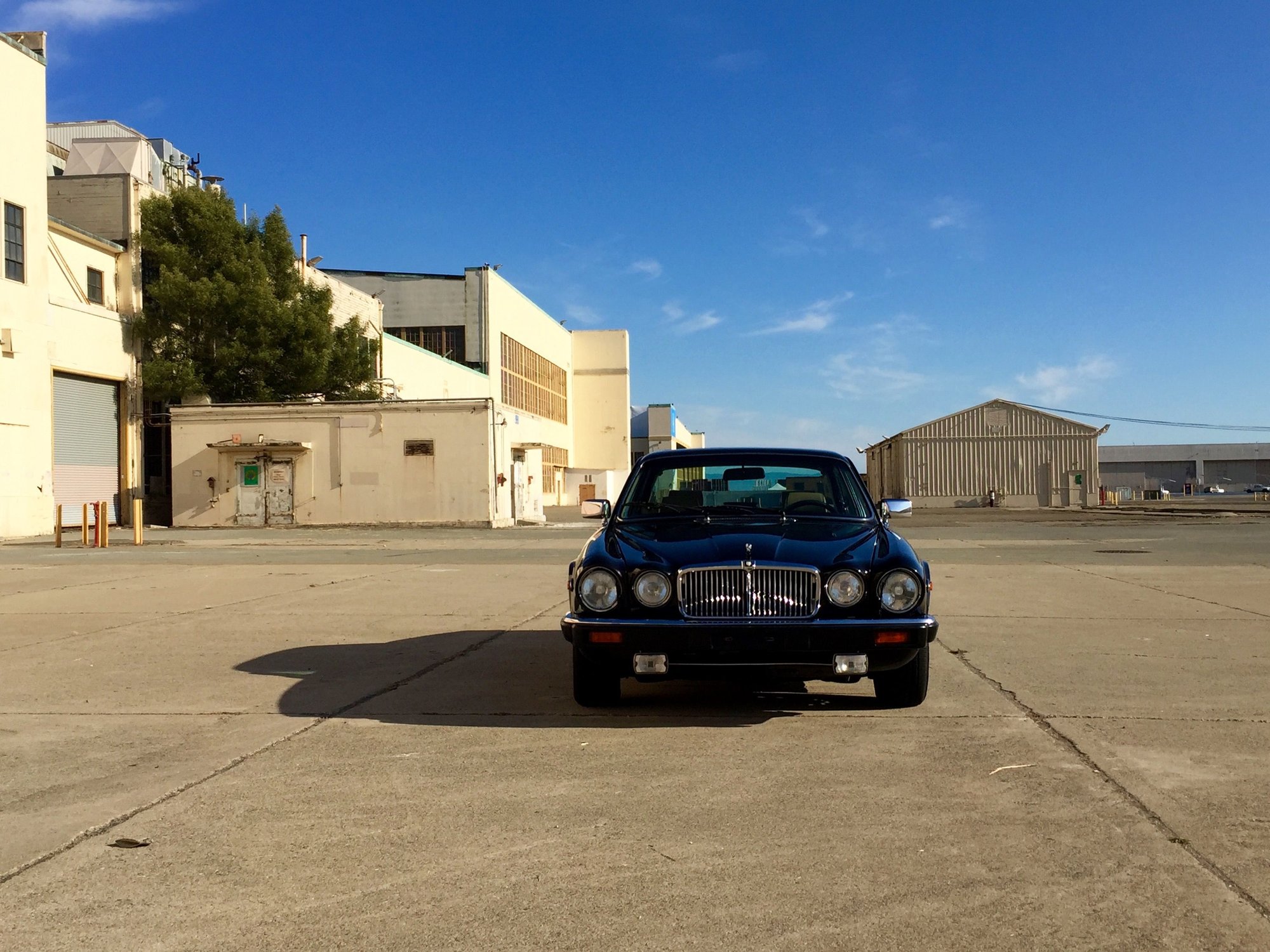

Hello fellow members,

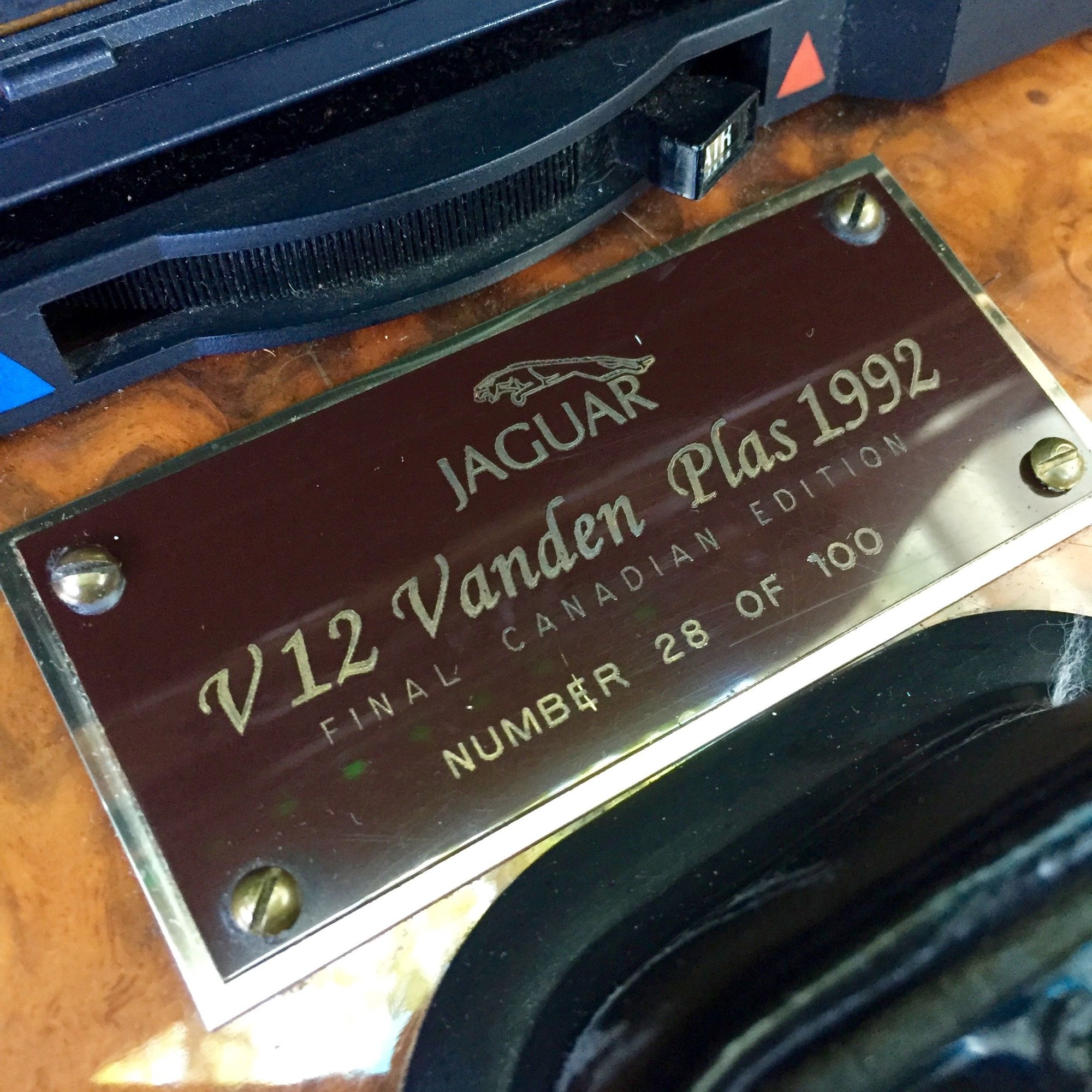

It pleases me great to share that since last week I am the (very) proud owner of #28 of the last 100 S3 VandenPlas V12s from 1992. Yes, this last line produced for the Canadian market. Full with a commemorative plate and all.
The cat is exceptional. In her lifetime, she has been driven, and driven some more, well-maintained, and always garaged. The result is stunning: original body and paint in close to mint condition (Black Cherry), and better interior condition than my like-new 2001 VdP. Even the switches are still crisp. And the driving is very tight, solid, and robust. No clunks, no rattles, not an inkling of shimmer.

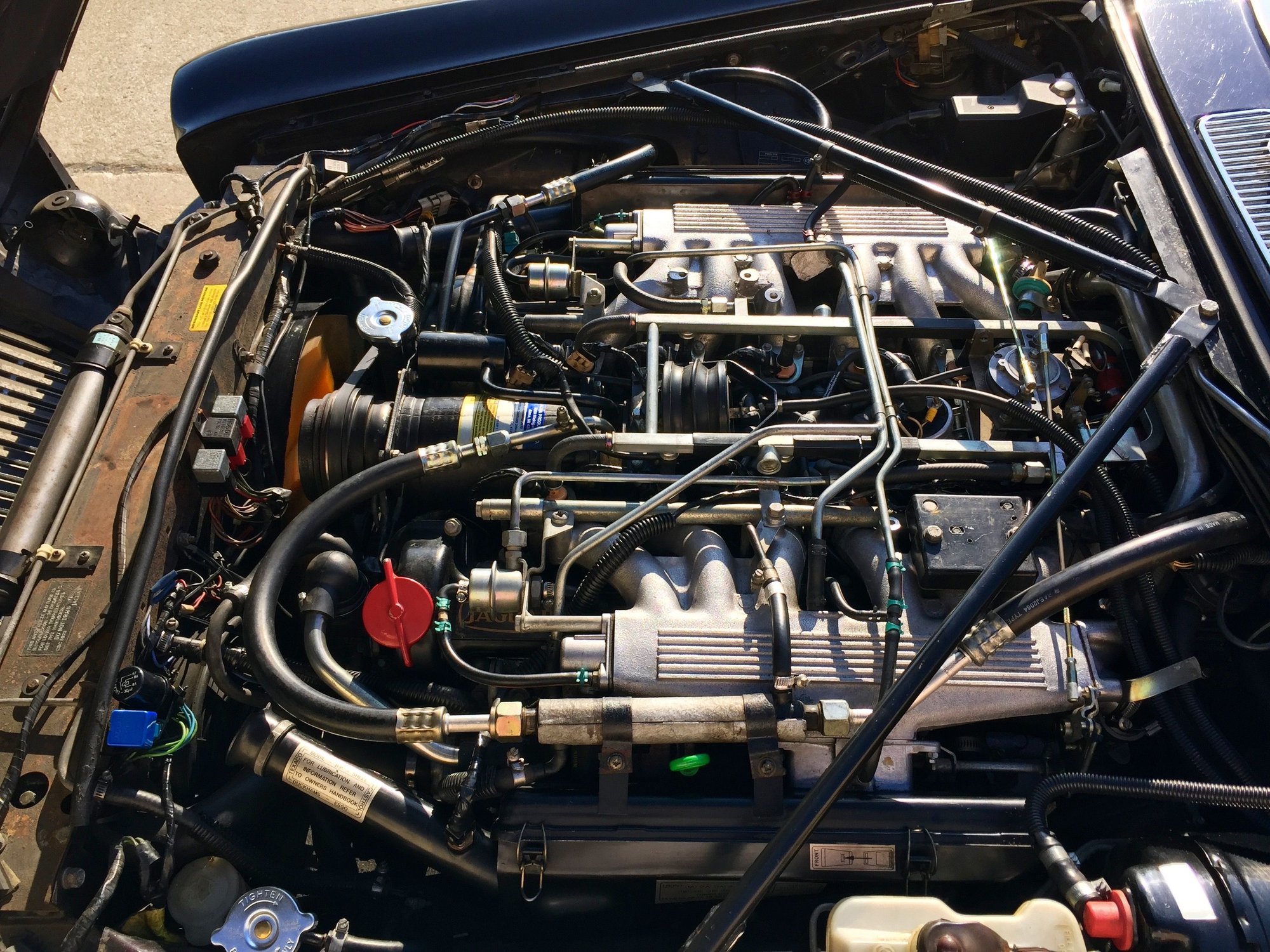

The infamous V12 yielded a wonderful ~205 ±10 compression on all 12 cylinders in yesterday's check (followed by new plugs), it sat through Friday rush hour traffic for 2hrs with no signs of overheating, the transmission is smooth and brisk. She's very quiet and eager at once - I'm sure you all know the feeling.
She'd been mostly sitting for awhile (about 6-12 months), so I'm going through all the checks and corrections, a full tune-up, fluids and filters change.
My main concern is the non-op speedo/odometer. The connections in the back are perfectly fine, so I'm wondering if the problem originates in the source. My question is: does the speedo get its reading from the infamous transducer in the transmission, or did this change with ABS-fitted models? Meaning, are there speed sensors, or the like? And the transducer, where do I find it?
I will update here with more news as I investigate, but any ideas and pointers are very welcome. I also will post some pictures once I get the chance to get some good ones.
Thank you!

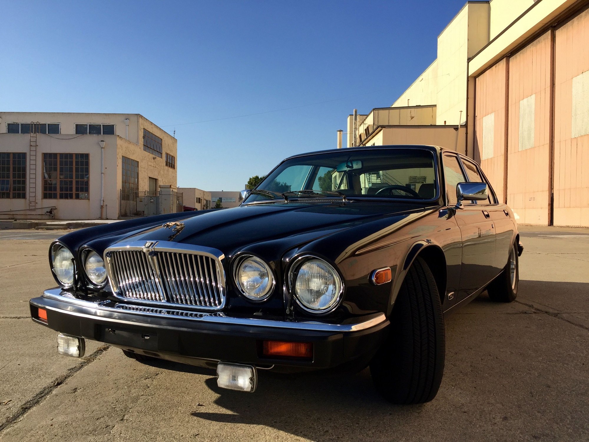

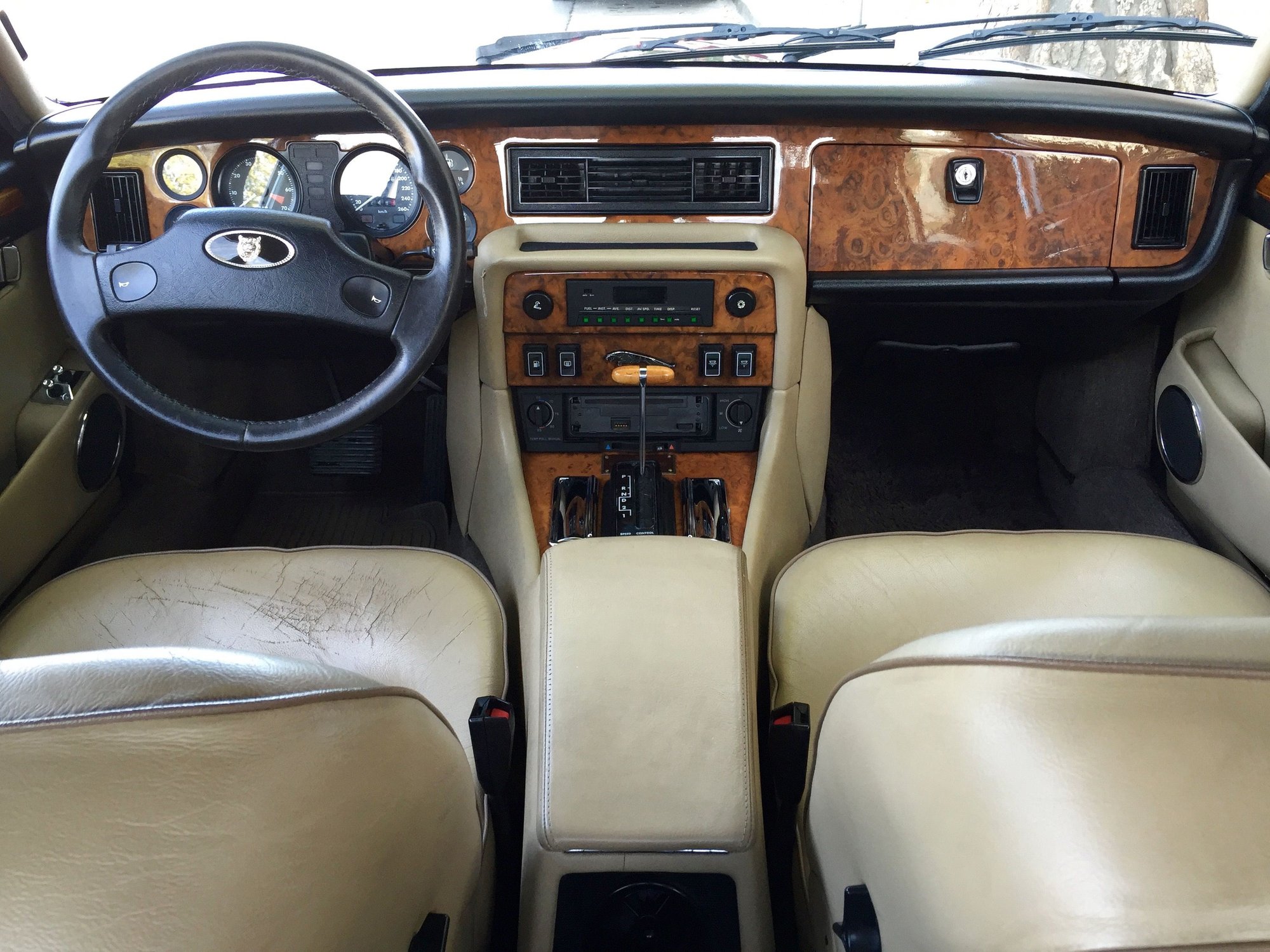

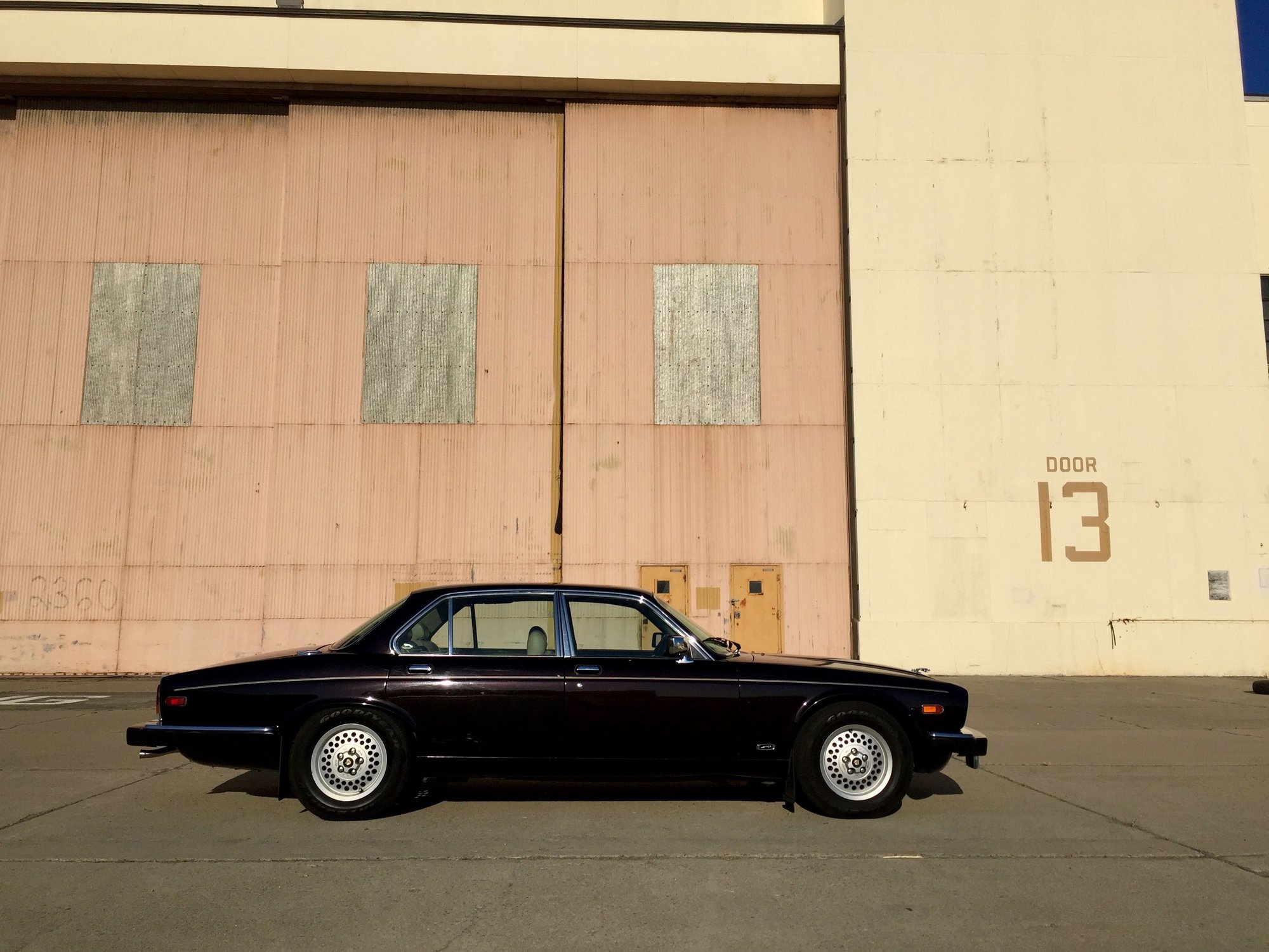

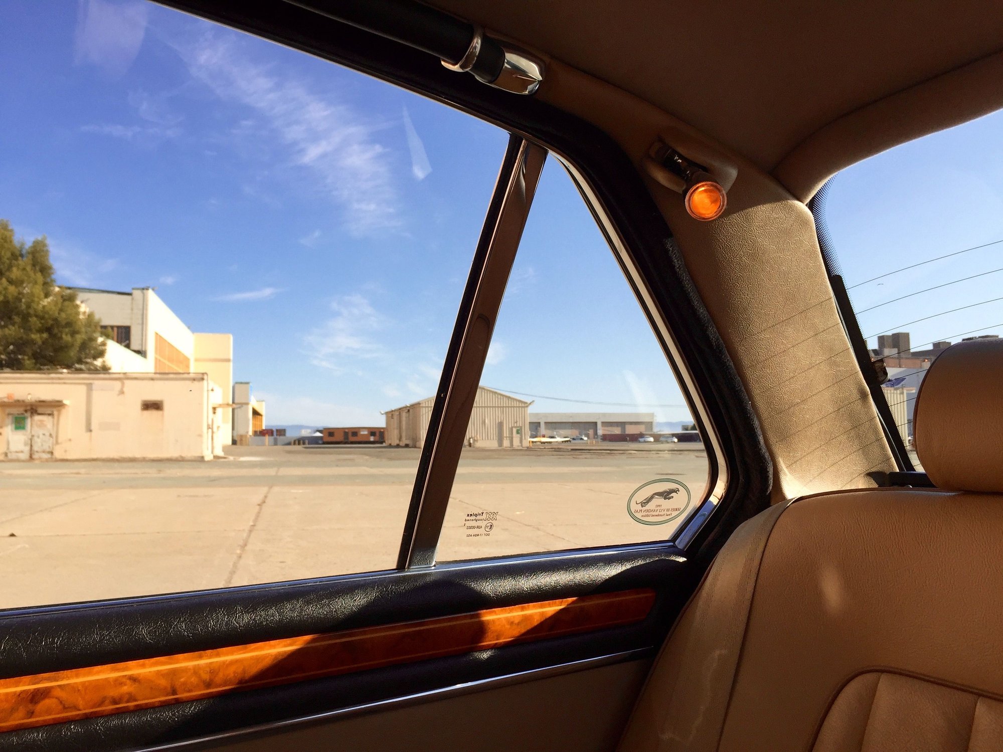

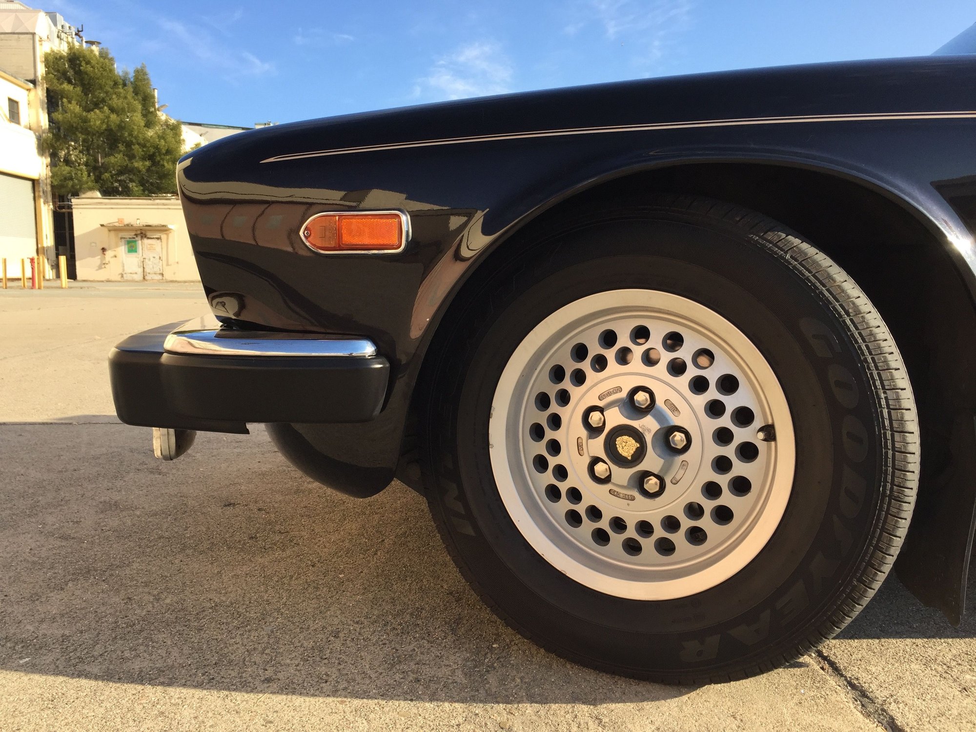

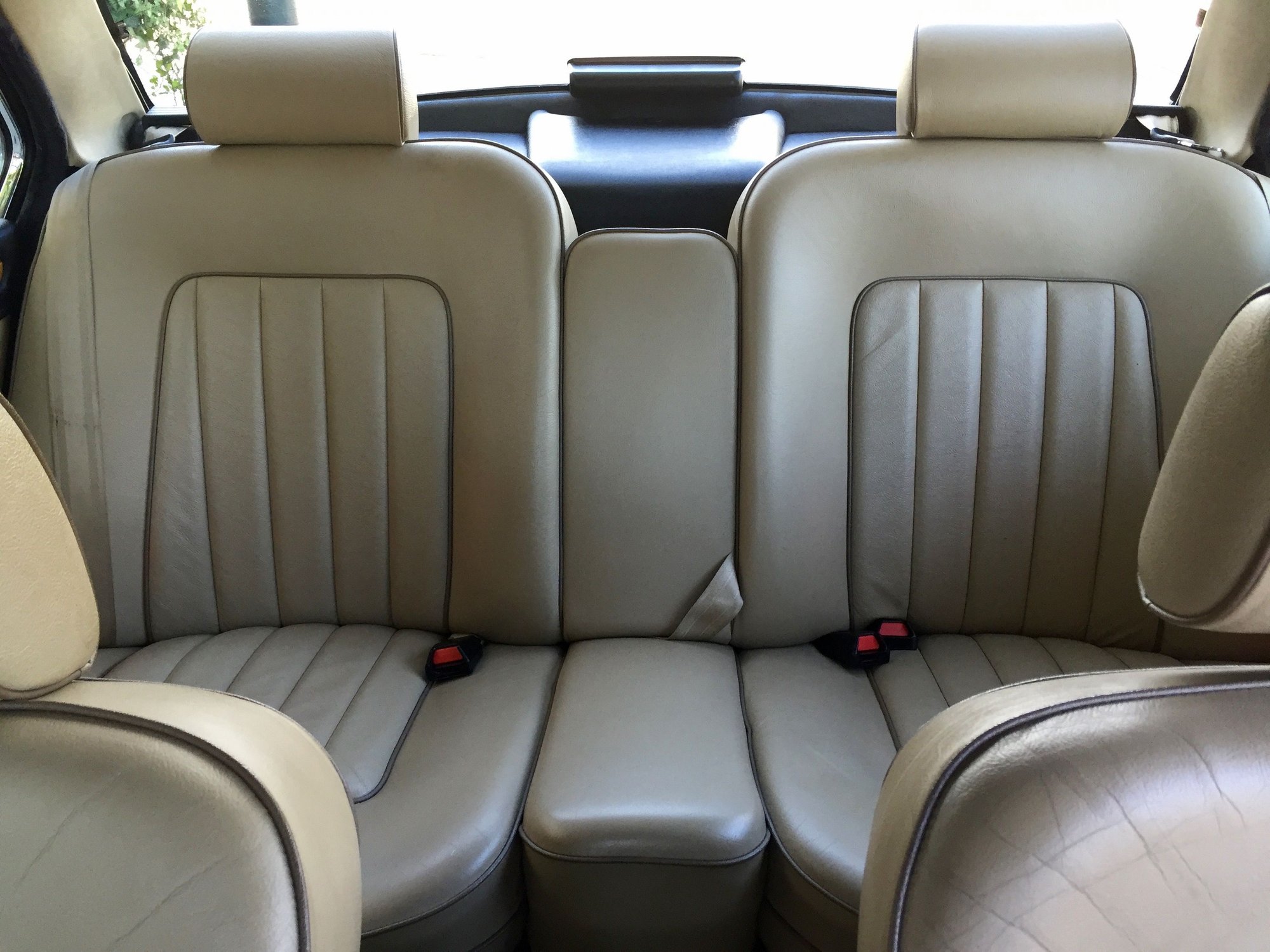

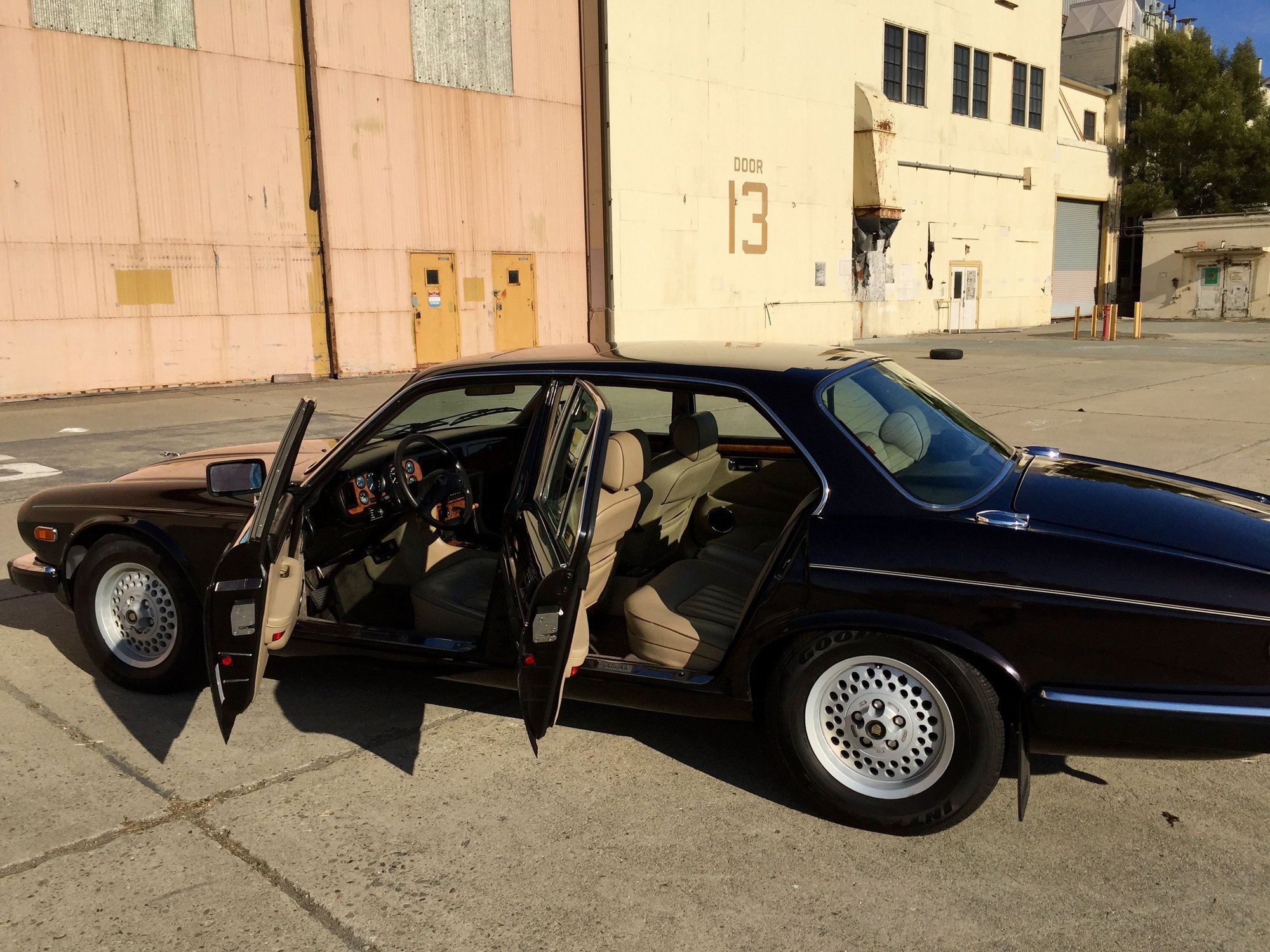

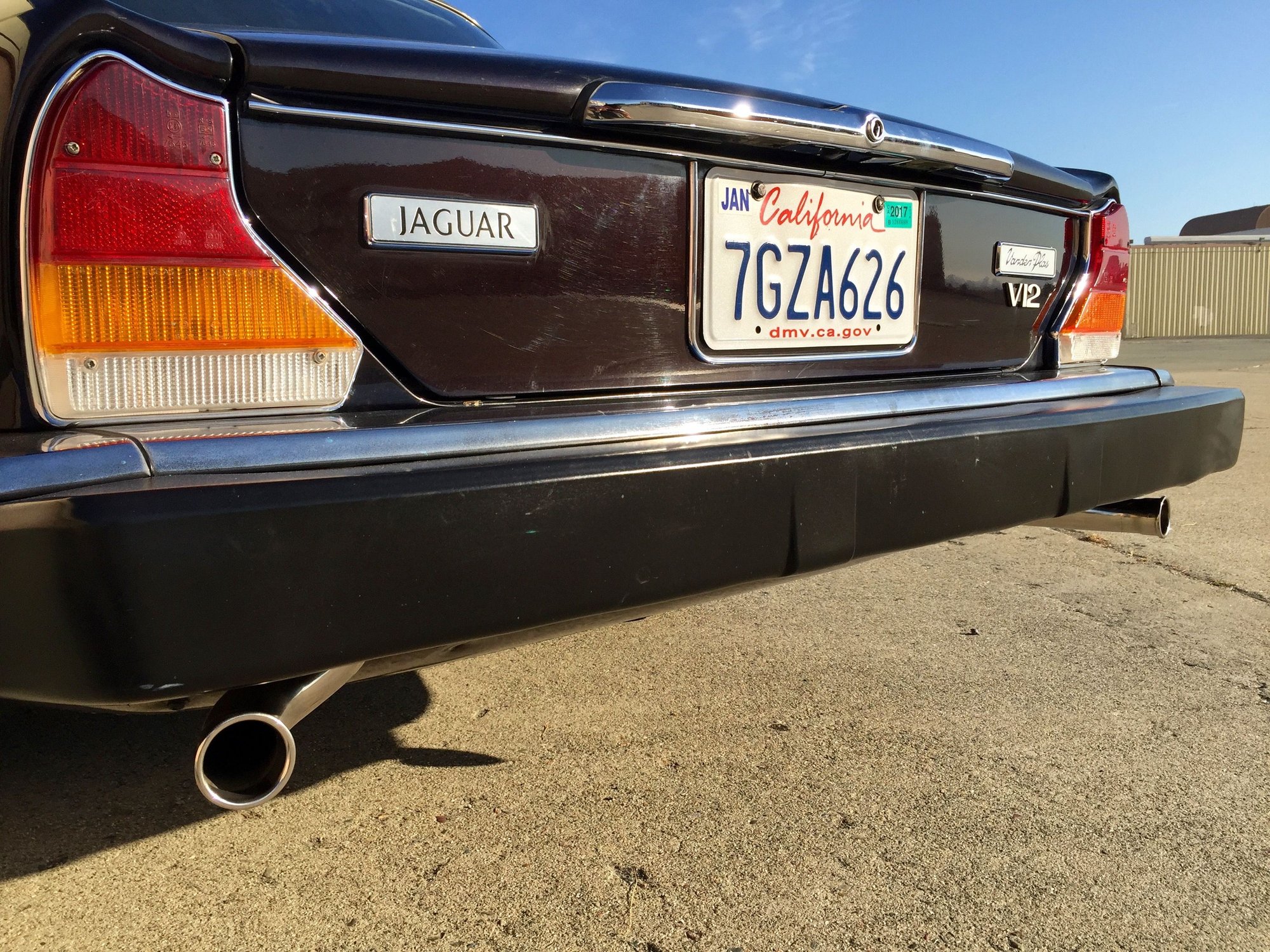

* Update: sale
Dear friends, since your invaluable contributions here, I replaced the transducer, did a thorough tune up (injector harness, connectors, injectors, injector and rail hoses, wires, filters, belts, oil, and basically everything that I found in need of replenishment), new cats, mufflers - the lot.
At the same time, however, life had its own plans: come September, my wife and I are moving to London where she will work for the next couple of years (she is a concert cellist). I was faced with two options: shipping the Jag to the UK, which is a complicated, and expensive affair, or selling her (I'm keeping my 2001 VdP for now as my daily driver).
With a heavy heart, I decided to do the prudent thing: sell her. So, I'll be putting her up on the JCNA forum, and I'm also letting you all people here that she is up for the taking.
You all appreciate the importance of parentage, seeing her go to a good home, so I need say no more. I'm not set on the price yet and I'm seeking advice on that, as I'm too involved to be objective. She is a wonderful ride and in excellent condition throughout. Two caveats: she's at ~155,000 miles (accurate reading is 246,700 Kms), and there's no paper trail.
She's located in Berkeley, CA, smogged, cleanly titled and registered till January 2017, and ready to be driven.
If there's any interest, please let me know.
There's a bunch of photos I took only yesterday, at this link: https://we.tl/gf3lepMs8N

Beautiful car, sorry you have to give her up. A well sorted one from the final 100 production should command a premium price.
