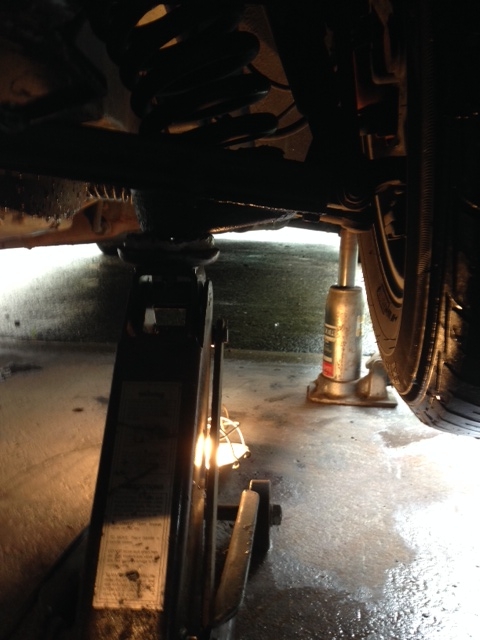

AlbBolivar was correct on the location and procedure down to the little leak of oil. One thing to note: It is a 21mm socket and if you have a deep one that would be better. I did it with a short socket with the ratchet not pushed all the way in. Also, it took me longer to jack it up than to put it in. You can put it in by hand almost all the way since its pre-lubricated. and just tighten it down on the copper crush washer.
Part# LNA5642CA and it says Made to Jaguar specification in Italy
I couldn't find the front central jacking point, so I put a 5000 lb floor jack under the spring and a 5 ton bottle jack under the bar where you would jack for a tire change. Seemed ok.
