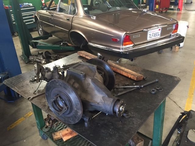

While we had the shaft out, I knew the rear brakes were getting down there so we dropped the whole rear end, put in new rotors, calipers, lines, etc.
Anyway - here are the pics of the re-worked shaft. You can see the old tube in tube piece off on the edge. Re-used the original yoke, etc., but you can see much smaller and lighter setup. A lot more room under the car now (should have taken pics when up on the hoist but forgot).
